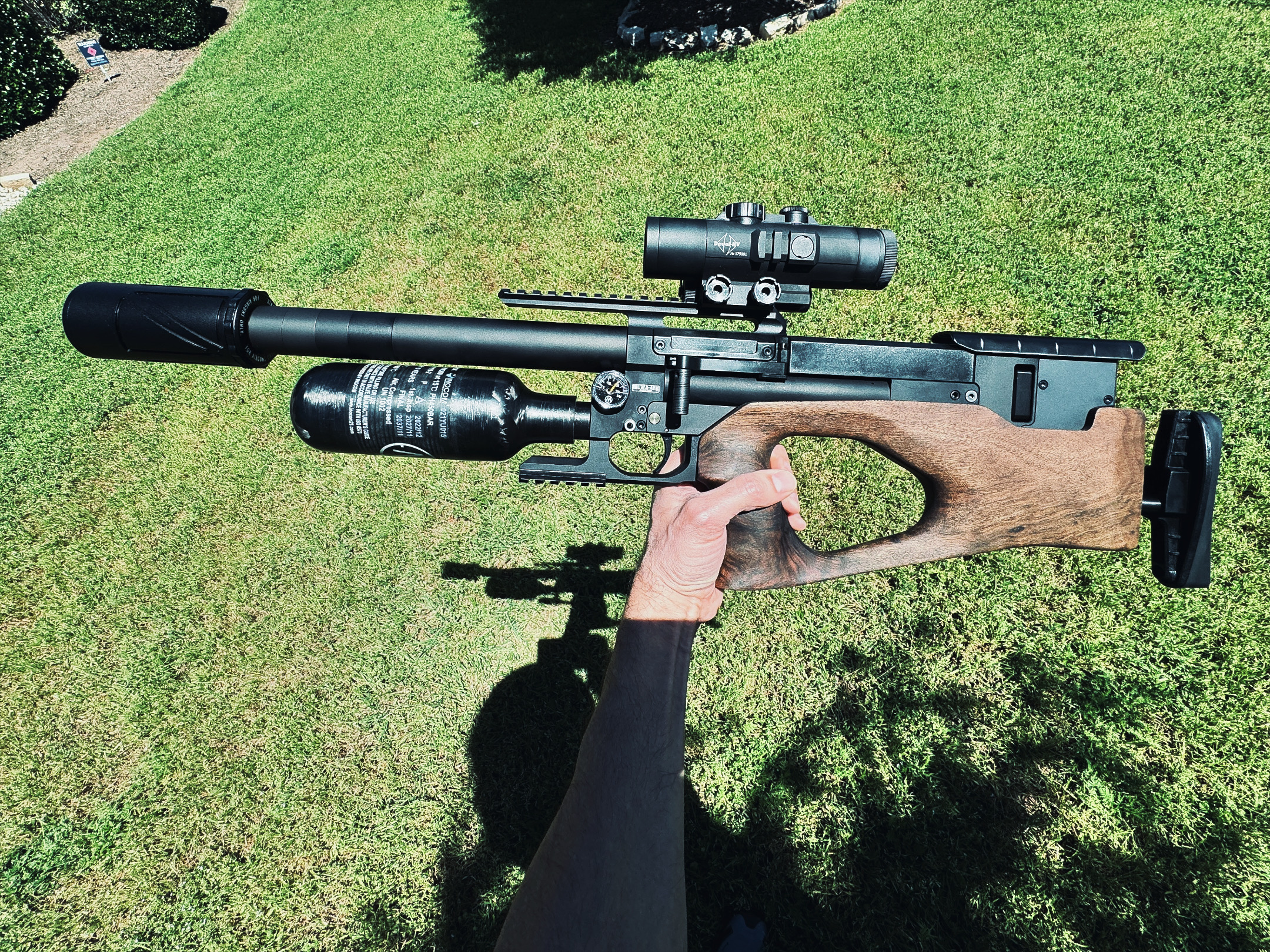

AirMaks Arms Take a look at this little critter getter!
Utah Airguns sent me this AirMaks Arms Krait Lite to test out!
I haven’t owned a .17 in forever, so I had to dig through my pellet stash to find something to shoot. I found some 8.4g, 10.3g & 13.4g.
Out of the box 10.3g @ 880fps, 13.4g @ 775fps. The Huma regulator is doing a great job with quite a few “duplicate” readings.
It’s got a little bark, so I added a DFL FatBoy with a .17 insert to help quiet it down while keeping it as short as possible. 29” with the butt stock extended about 3/4”.
I haven’t had a chance to test it yet, but I will!

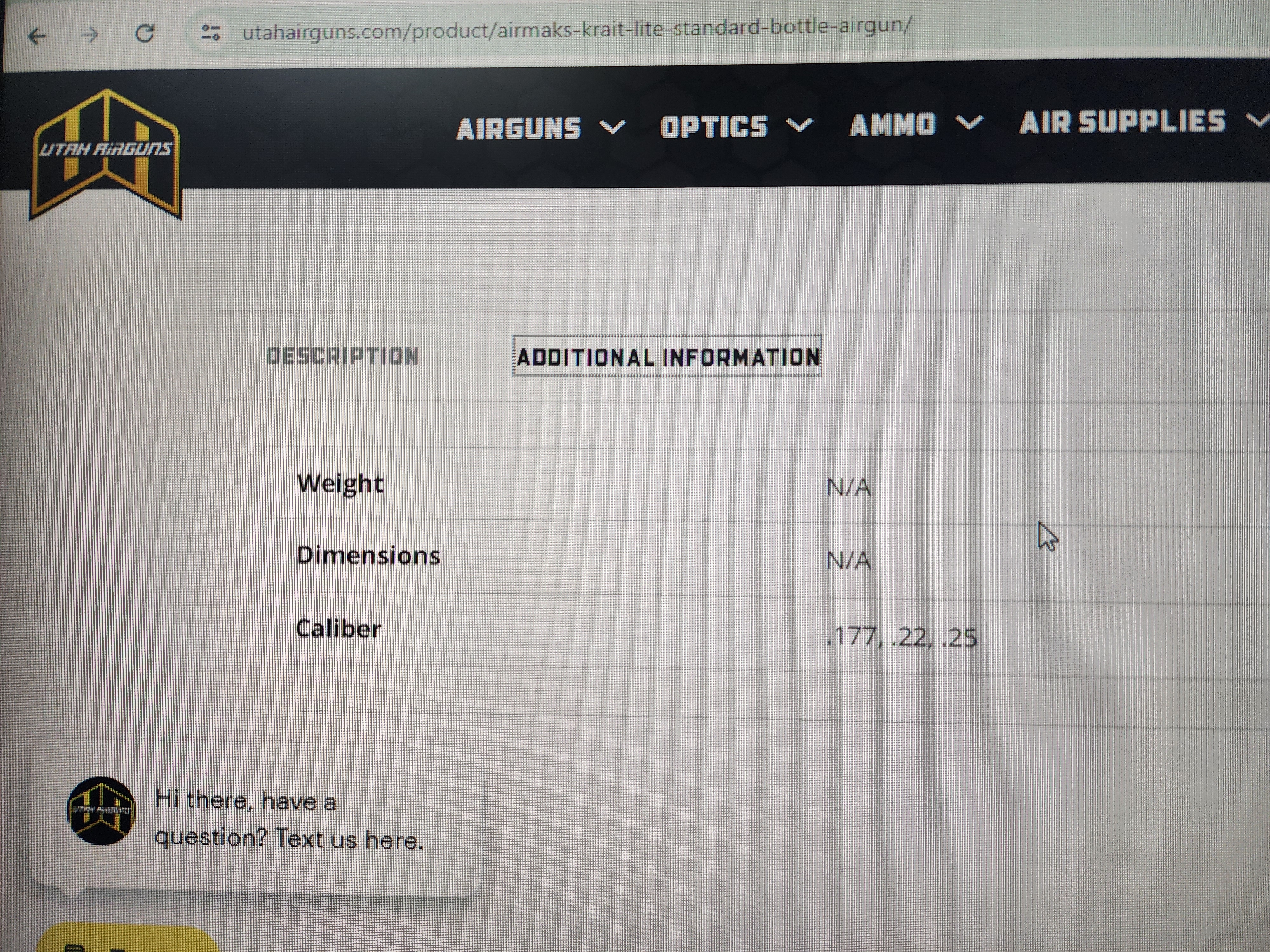

What's up with people today? Did you take your meds Uncle Mike? I did look it up. Since the other Michael I was referring to got it from Utah Airguns, I went on to their site and this is what came up...

Thanks Uncle Mike. The sites you linked list the weight in kilograms. Can you convert them to pounds for me? Just kidding. I can sleep now.
