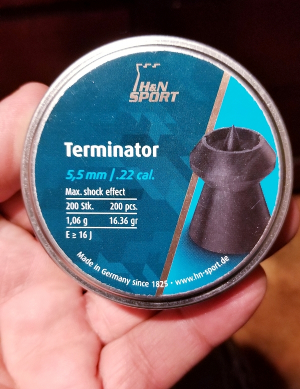

Im testing my Gamo Hornet Maxxim at 75 yards tomorrow. I shoot an H and N Sport Terminator Holliw Point .22 cal pellet, pictured below.
Im zeroed in at 30 yards (3/8 grouping) and Im also dead on at 40 yards as my second zero. These pellets are 16.36 gr.
