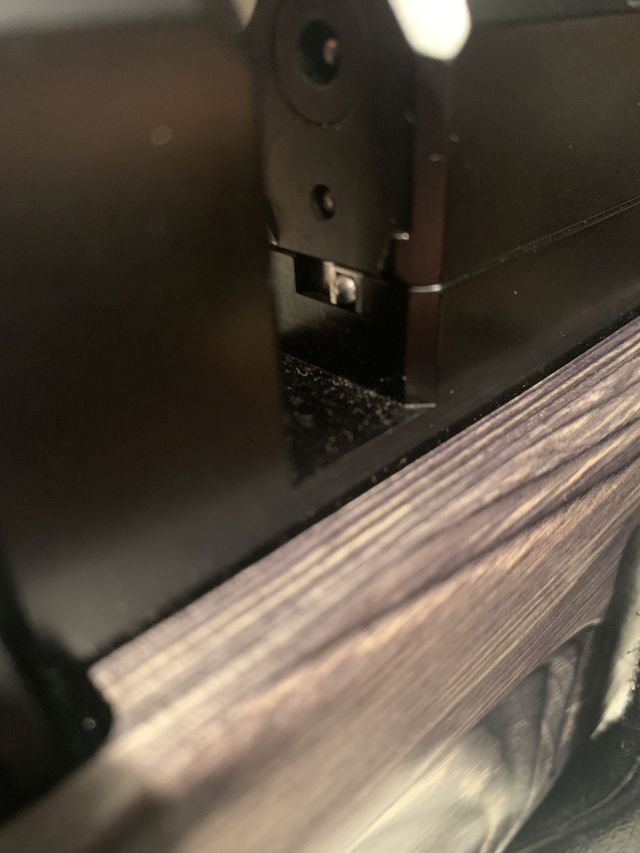

Tuning Taipan Veteran will not cycle magazine
FIRST I would try and be sure ALL of your different magazines dont cycle before disassembling the gun. Even try running empty magazines then click and fire see if that even cycles the empty magazine be sure to shoot blank shots. If that helps maybe oil it a little.
You could try to bump the receiver many times with a rubber mallet while cocking and firing in case the actuator is stuck due to dust and grit buildup first too.
Try ALL of the other possible solutions including swapping EMPTY MAGAZINES and banging it lubing and even upping the hammer spring tension as the other guy mentioned BEFORE taking it apart.
Taking it apart is the LAST RESORT (and also learning a foreign language but I would just put it on MUTE and watch) and put on Ariana Grande non stop.
Could be maybe even as simple as adjusting a trigger heavier never know.
Look to see if the small ball bearing is still in place where the magazine slides into...if missing the mag won't cycle.
Odoyle Mahalo buddy problem solved!
