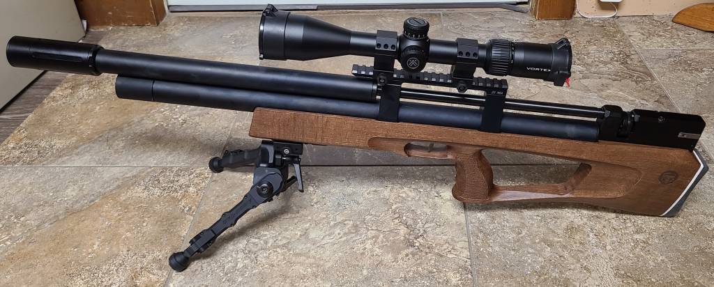

My order from Neilson specialty Ammo arrived Saturday, so I started the slug hunt today.
Equipment: Taipan Veteran Long. 25, Vortex Diamondback tactical 6-24x50 EBR-2C reticle, Donnyfl Tatsu, Donnyfl speed dialer, and Competition Electronics ProChrono.
Slug candidates are NSA 26.8, 29.0, 29.5, and 33.5.
The 26.8 and 29.0 are dish backed, while 29.5 and 33.5 are flat backed.
(Marked speed dialer at one of the through hole locations for reference point.)

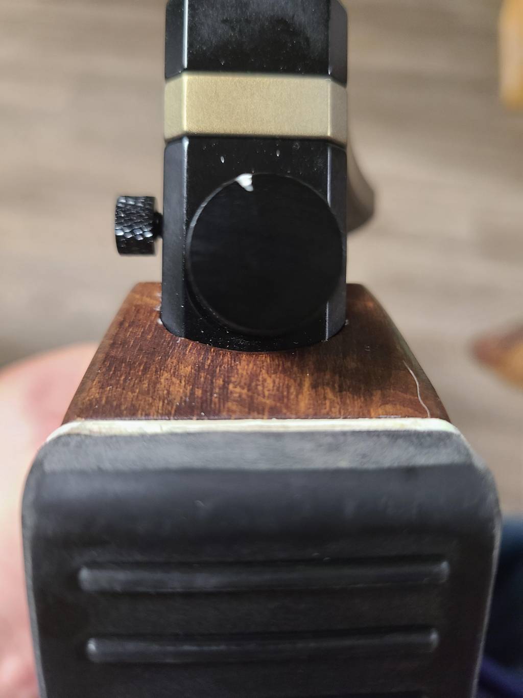

The regulator is at whatever the factory set it to, and I started with the speed dialer set to just allow the gun to cock, plus slightly less.
I shot a 5 shot group with each slug, and then reduced to next position and shot another string for each at 12 yards. Each 20 shot string dropped pressure from 250 Bar to about 180 Bar by gage, which should allow for about 30 shots before needing to refill. To make things simple, I just recorded the Avg velocity per ProChrono for each group.( All groups shot from magazine. )
The first groups allow me to establish a baseline to compare the adjustments, with speed dialer at 2 O'clock. I backed off the adjuster to the 12 O'clock position for group 2.

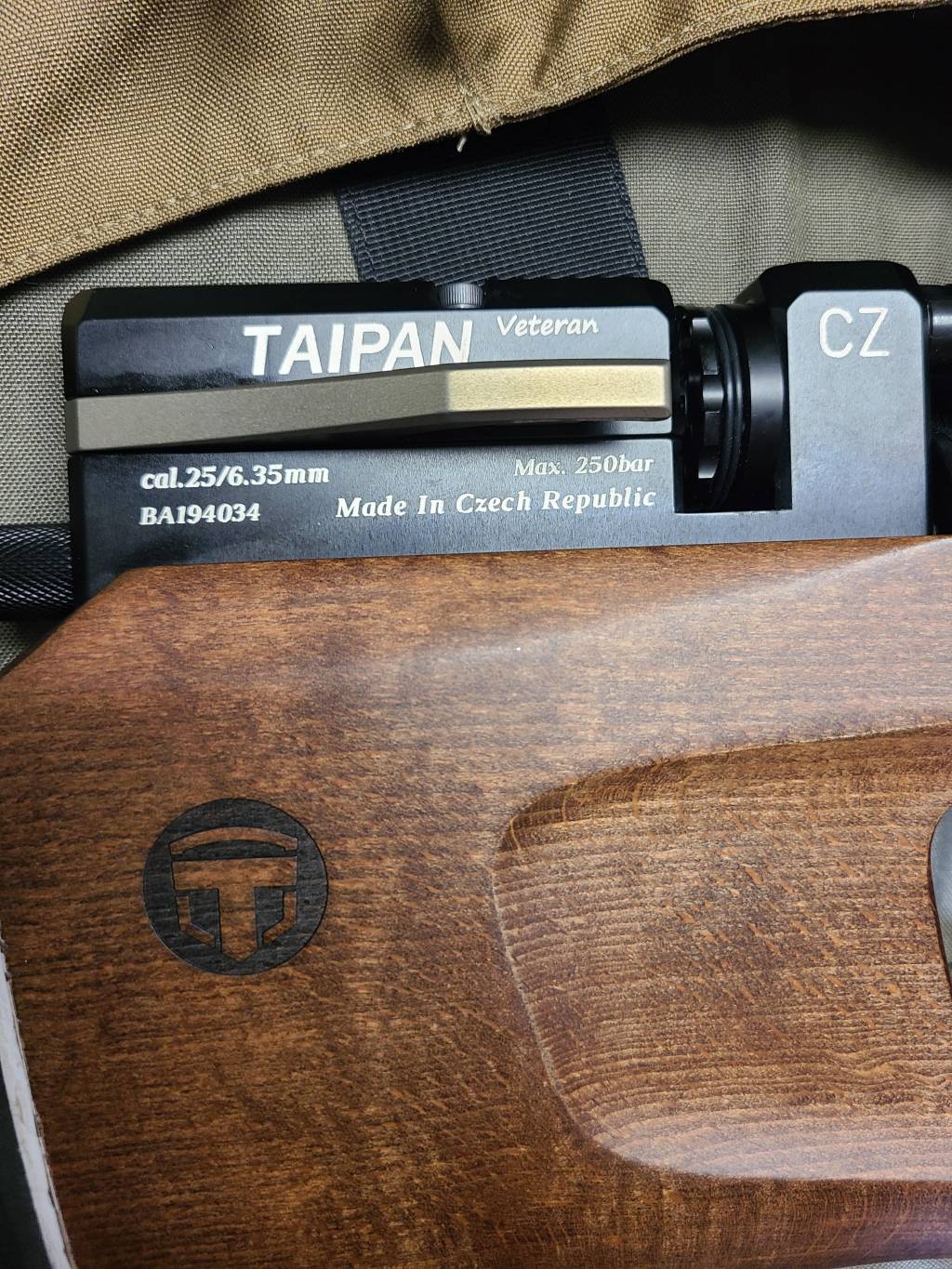

@Dave, I'd expect nothing larger than a single hole about a hair over the size of the projectile diameter. What are the first two digits of your Vet's serial number, and did you buy the rifle new or used?

.25 Veterans are Lothar Walther barrels.
Not all of them. I have 2 25 cal vets , both CZ
Does the location or serial number tell what barrel is being used?
Where would I look to see what make of barrel I have on my two .25 Vets?

Sort of, but I'm pretty certain that you have an LW barrel.
It's hard to say what could be going on with the accuracy issues without knowing more and ruling things out. Are you shooting from a bipod / rest? Which optic are you using? (I.e., are you positive that your shooting position, optic, and mounts are not the issue?)
I don't think Taipan ever used CZ barrels in there .25 Veterans. They started as LW and believe have always been LW and still are. .22s started as CZ then went to LW temporarily and back to CZ now.
The CZ on the side of the breech doesn't have to do with it being a CZ barrel.
This is what Tony at Talon Tunes said. I E mailed Taipan about this, but it is about 8 PM in the Czech Republic. I hope I get a response so we can clear this up once and for all. I would like to see some groups at at least 30 yards. I like not spending my coin on testing. Woody Chuck, out?

.OK barrels , I own 3 genuine cz barrels in 22 cal only , I never saw a CZ.25 cal barrel , I have seen many taipans with engraved CZ with LW barrels among other brands , I believe in USA many guns from dealers , were bought with out barrels and they were fitted by USA dealers in past , SOME dealers fibbed and SAID OURS are CZ barrels when they were not at all ,
I am sure Taipan if you dig around forums you will see this was true since the mutant , but moving forward they may have changed practices ,

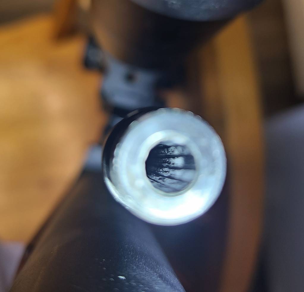

I'll wager a guess and say that it's the barrel chamber and/or choke/crown that are causing issues. The ammo should still shoot straight and true out of the barrel at that range.
Did you clean out the bore when you got the rifle? Most of them come from the dealers with that nasty protective film in the bore. That has to be cleaned out thoroughly, otherwise you run the risk of damaging the lands, rifling, and possibly the crown chamfer. I'd run some tight patches through it with Ballistol to see if there's any brown residue coming out of the grooves.
I would also want to do a few things to test the barrel bore geometry - like pushing some JSB King size pellets not slugs) through the bore to see how they feel, checking the chamber itself to see if it's damaging the ammo during the loading cycle (very common issue). If the choke is too tight, I'd want to polish that out some, especially if it's "abrupt".
The crown could be causing that as well. I'd make sure that it's square, and make sure pellets aren't getting hung up on it when you push some through.
You could do all but the visual inspection of the chamber / throat without removing the barrel. You'd just need to be comfortable removing the top part of the action housing to get at it better. The only tricky part of that for someone that hasn't done it before, is the reassembly. It can be a little frustrating without experience (do not lose the little ball bearing under the cocking lever).
If you need help, fee free to ping me.

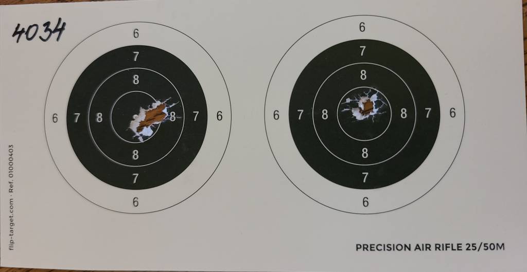

I think I discovered the reason for my findings.Here is the initial target with JSB 25.39 gr, but I am not sure of what distance.

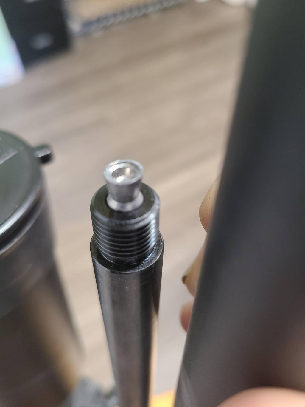

Anyway, I took off the shroud and discovered alot of lead powder all over the barrel and inside the baffles, which I cleaned off. During inspection of baffles and barrel to see the reason for leading I discovered tons of lead in the rifling of the chocked area of the barrel.
I tried to see how tight it is and tried pushing the head of a pellet into chock. It was going to take a good amount of force to even push the head in on the jsb 33.95's. This is the tightest chock I have personally come across. This means that my best bet is to find the smaller diameter slugs to try, as trying to find any good pellets right now is nonexistent.
I think I discovered the reason for my findings...........
Not surprised here, VERY VERY VERY tight chokes on the 4? OEM Taipan barrels that I've had in my hands. From Ukraine and Czech specimens. Even the 700mm CZ barrel that we put on a friends gun was overly choked, in my opinion and in comparison to other barrels that shoot well with less aggressive/abrupt chokes. I've stated before that I think Taipan's barrel specs (read "insanely over-choked") make them much better pellet shooters than slug shooters.
