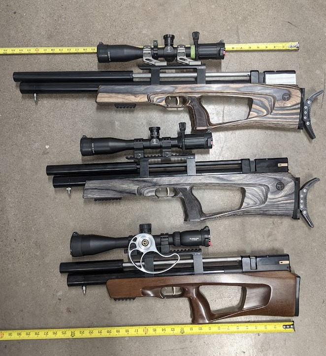

Just took this photo, not a great comparison b/c the Short and the Long have been messed with....but might give you an idea....
Top is of course the Long. It has a 23" barrel on it, and a plenum addition, making both the barrel and tube about 2 inches longer than OEM.
Middle is the Standard, bone stock, other than the buttpad/hook.
Bottom is the Short. It has a 16" barrel on it, and a plenum addition, making the barrel about 2.25" inches longer than OEM, and the tube roughly 2 inches longer.
If not including the buttpad, the OAL of the Long (with noted changes) is about 34 inches long, Standard is about 28," and the Short (with noted changes) is 25.75."

The Short, with the 16" barrel is my favorite, which would make it almost the length of a Standard. So, like I said earlier today, the Standard is sorta the Goldilocks.

Great visual comparison for anyone trying to decide.
