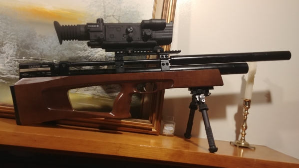

I actually have a FX wildcat , Edgun , cricket and a Taipan veteran , I think for money Taipan is well worth the money ,I think it is a better gun then some I have that cost $500 more , I do not have alot of shots threw my taipan yet , I can say I have many threw my Edguns and FX ,and FX always seems to need attention it is just the way it is , where as I have over 20,000 threw a Ed gun and not even a breech seal issue yet , so I guess it boils down to if you can tinker and like to tune and what is best , I am blessed to have many and I think each one has its place for me , I would also like to add I shoot a very lot and I have shot a few Bantams and I think they are a good mid range priced gun , But the one which won EBR was not a off the self gun , You can upgrade any gun . I have to say I have not modded or tuned my Taipan as it shot so well since I got it a few months back . All I did was clean it set HST and the trigger to where I like it and put on a tatsu on it . I just put a nite scope on it today here is a pic of it
