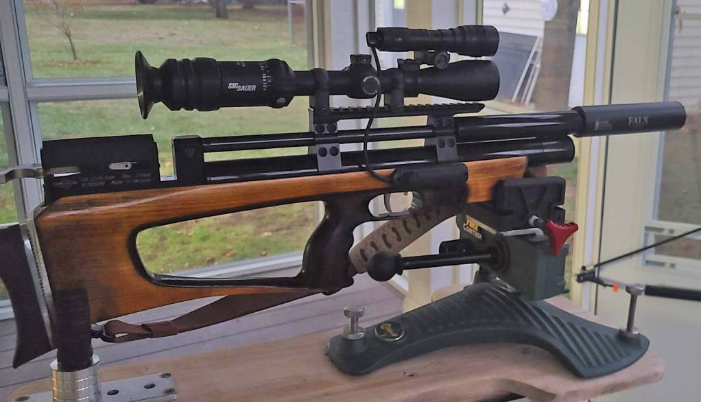

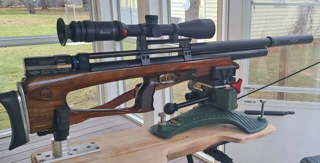

Update....Taipan Veteran .25. Received my Airgun Heaven 700mm barrel - no amount of tuning. re-crowning, pellet - slug, type bullet or weight could make this barrel a consistent shooter. Replaced that with a 24inch LW Polygonal barrel, now this barrel is a tack driver. Shooting dimes at 50yrds now with Griffin 42gr LDC HP BTs. Need to find time to test out to 100 and see if i can get it out to 200. Replaced the oem barrel shroud with a shroud off a Veteran Long, Modd'ed the baffles and now, with the STO moderator this thing is extremely quite. Hacked up & refinished my laminated stock and added an old school Morgan adjustable butt plate. Need to do more chrony and fine tune a bit more but Love shooting this gun more every day. Few DonnyFL's and Lots of Griffin & few H&N and AVS slugs going on ebay here shortly.
Now the .22 Shorty. The CZ barrel is amazing with pellets and some slugs but being a chocked barrel its limited in the selection of slugs and weight it'll shoot effectively. Will be replacing the CZ with a Poly barrel here shortly - extend the barrel length from 13inch to 15 or 16 inches - mod the shroud & baffles to keep the overall length same as oem.

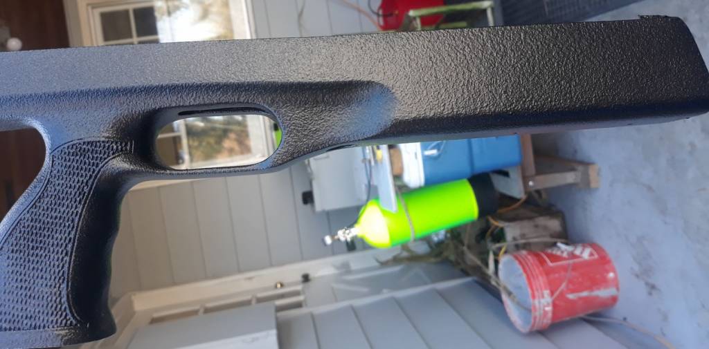

I purchased my barrel directly from LW - then had it machined down. Opted to not hone the scope towers just in case i want to go back to the oem CZ barrel. Ref. the bed liner stock mod, it looks great but i still prefer the natural look - now re-shaping that front end of the stock is a maybe but not sure i wanna risk screwing it up.
