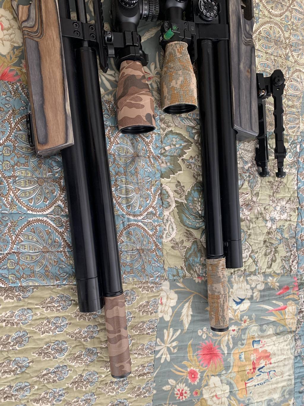

I have a .177 Standard on it's way together with a power plenum. With the plenum installed the air cylinder will protrude in front of the barrel. Looking for a LDC with the same diameter as the shroud.
With the addition of the Power Plenum -- which causes the air tube to protrude beyond the end of the barrel -- you will need to use:
https://donnyfl.com/collections/ldc/products/1-22-x-5-inches-tanto
or the DonnyFL Koi. As shown in the link these LDCs have a diameter of 1.22 inches. I use the "Tanto" on 3 of my Taipan Veterans that I have installed the Power Plenums.
Addendum: I use the DonnyFL Tanto on my Veteran .22 cal and .25 cal and this LDC is quite effective at reducing the bark of these rifles which are producing FPE of 60 and 66, respectively. Of course the Taipan Veterans come with factory shrouds that muffle muzzle blast very efficiently -- better than any other PCPs in my arsenal.
