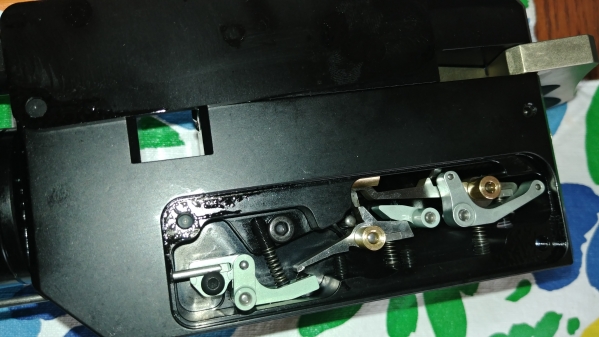

OK simple fix remove 2 side cover screws , then you see trigger rod the trigger linkage bar is slid into a receiver and held with a 2mm screw. loosen that screw and slide the bar in or out a tiny bit and re tighten. and recheck this will fix gun .

here is pic its accually of my post in 2018 but if you say loostened clamps or say did a reg adj it may be off a whisker and easier to do this then move action front or back

The safety has gotten stiff sometimes now to where I literally cannot even engage it and have to decock the gun to walk around while hunting. Does anyone have a simple guide or diagram (or explanation) showing how to disassemble and reassemble whatever needs fixing?
