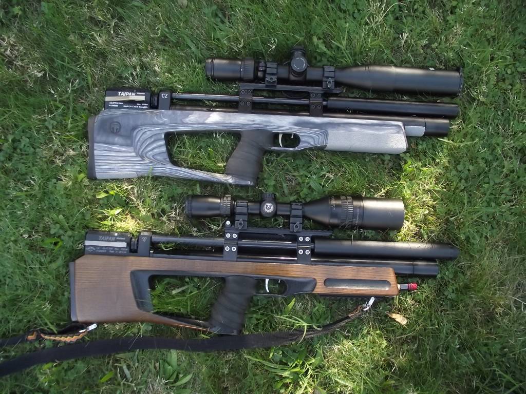

Have two Taipans myself and due to the above issues BOTH have different ring heights.
