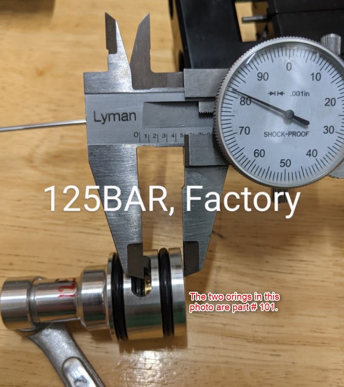

One of mine came with the red marker saying 125 bar, and had this measurement.....
That won't get you exactly 125 bar, but it should be fairly close if you set it similar to this measurement.
I saw that you're shooting for 120-125 but Just as an FYI, the OEM regs don't usually go much lower than about 105-110bar, the adjustment collar bottoms out pretty close to where it is in the photo above. And testing that bottomed out position by shooting over a chrono produces shot strings that suggest reg pressures of 105-110.
So, adjusted not much from max travel should net you around 120 bar output, and should look similar to the photo above.
Also, it helps me to remember that more compression of the washers equals a higher output pressure.
