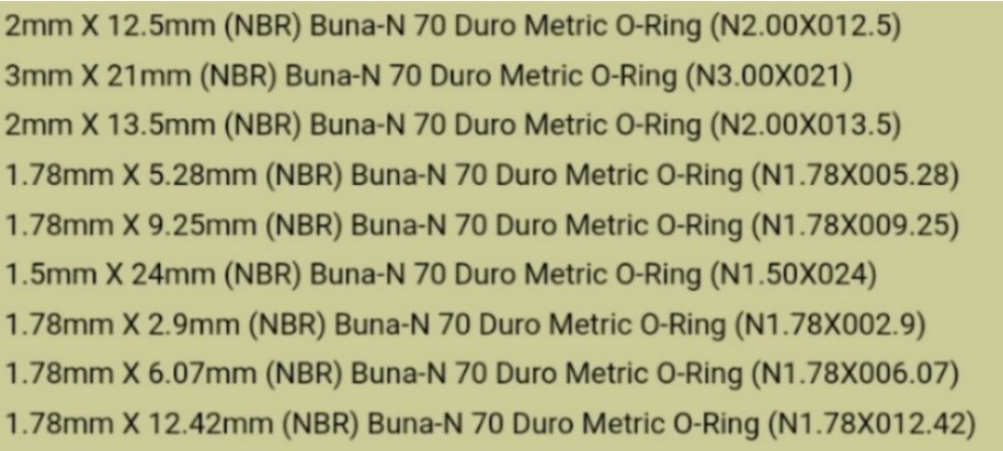

Here's the list I used for the oring kit I put together for mine. Compiled that list from a couple of forum posts others had shared. I've seen some oring lists on the forums though that are not correct. With this list I've not yet found an oring in the gun that one of those sizes wouldn't replace.

That screen grab I included above is my order summary from "The Oring Store" so at least that oring website lists them that way.
And just as an fyi, the same oring size is used in a couple different places in the Vet.

@Franklink do you happen to know the oring size used to hold pellets in the .25 vet magazines?
One of my gripes with the Taipan, is that none of the United States dealers carry replacement O-rings, and they don’t even know the sizes.
I will get out my calipers and see if I can size that O-ring for you
Reactions: cavedweller
Mag o rings are listed as 1.5 x 24. I'm pretty sure all calibers are the same, but I can check my .25 when I get home. FWIW, I emailed taipan a while back asking for o ring sizes and received the attached list (originally asked about .177, but many sizes are the same across calibers)-
