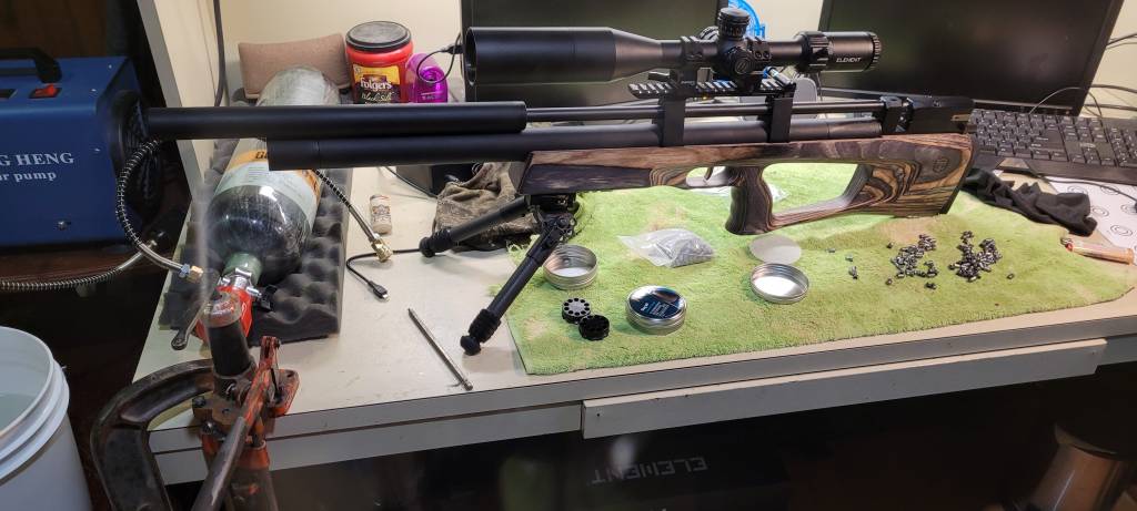

I recently purchased the 700mm cz barrel from Talon Tunes for my taipan veteran long and a plenum extention. The Original barrel was great along as you shot jsb pellets, it didn't like anything else.
Before I installed the 700mm barrel I pushed a pellet through it to feel for rough spots and to check the choke. I was pleased to find no choke. The website doesn't specify but that is what I was hoping for. I then polished it with jb bore paste and installed the barrel.

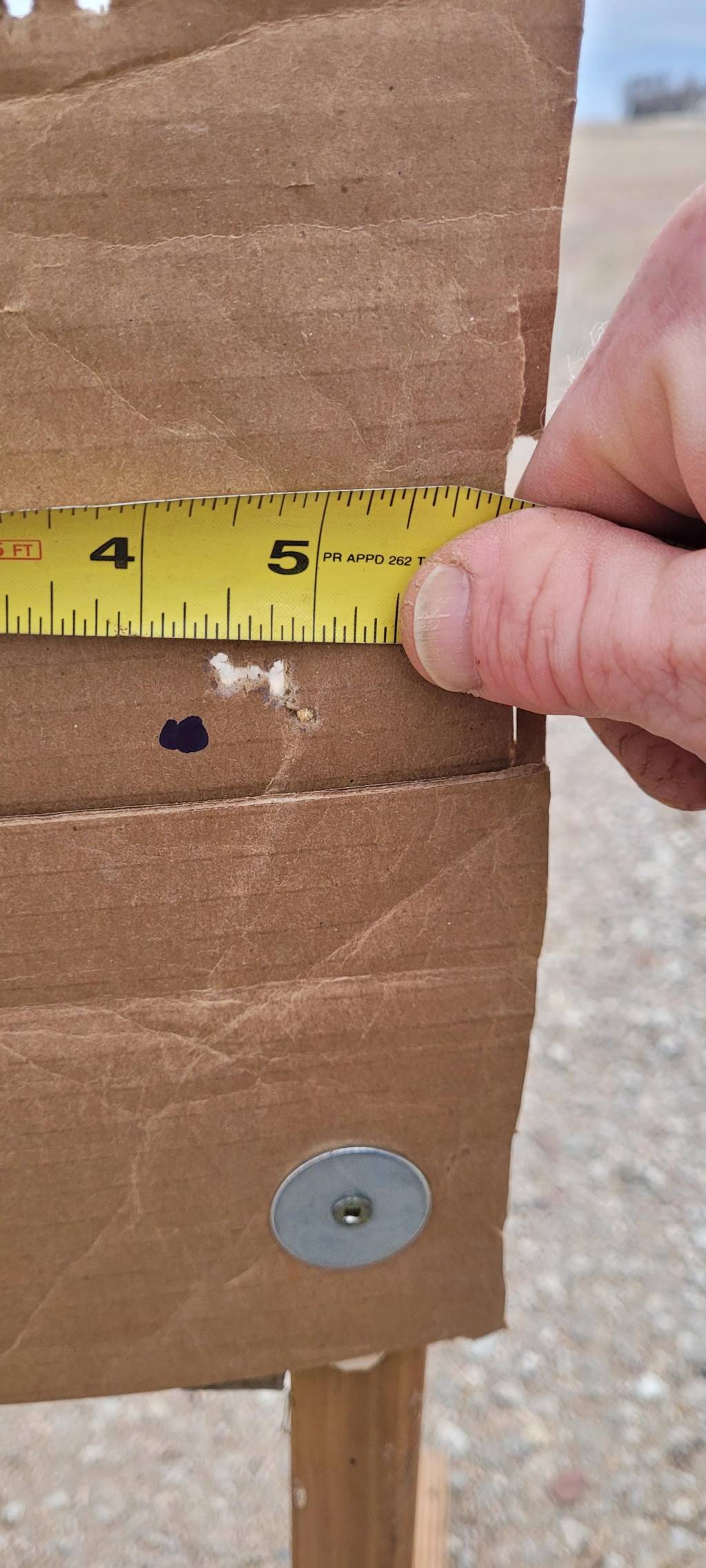

This barrel is great! So far it shoots everything I've tried RDM, nsa 24.8 .217 both shoot great but it's been so windy here in Nebraska it's hard to test anything. I did shoot this group today in 24 mph wind with H&N slugs 50 yards @ 890 fps 10 shots.
