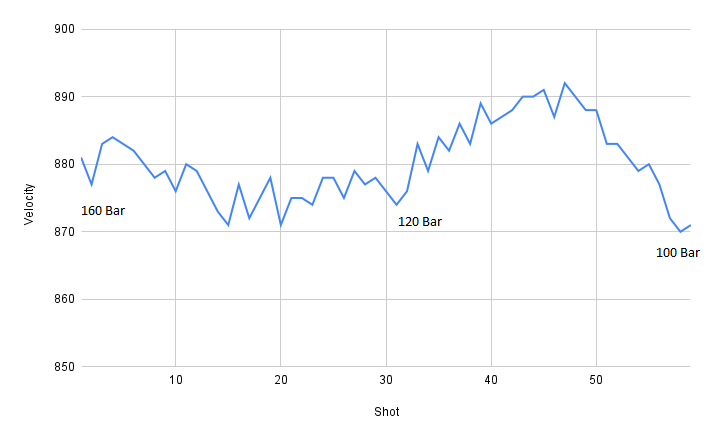

The more I shoot this gun, the more I like it. Did some work today on adjusting the hammer spring. Got the JSB 18s flying around 880fps and shot around 50 shots on target, then decided to record the remaining shot string on my chrony to try and figure out where the regulator is set. Got 60 shots from 160bar to 95 bar! So in total that is 110+ shots on a fill at this setting.
From the chart below, I am guessing that my reg is set around 120 bar, because it started to increase in velocity around that time. I still have not been able to max out the velocity with the stock hammer spring, but at this power level I am really pleased with the shot count and accuracy. My only complaint about the rifle is that you don't know where your regulator is set, but that is really minor.

The slight uptick in velocity there at the end (+15fps or so) suggests the hammer spring tension is pretty close to optimal. The extreme spread for the main part of the shot curve is already quite good, just looks jagged because of the graph scaling. It should improve ever so slightly with a little more hammer spring tension, and produce a gentle rolloff at the end rather than the bump.

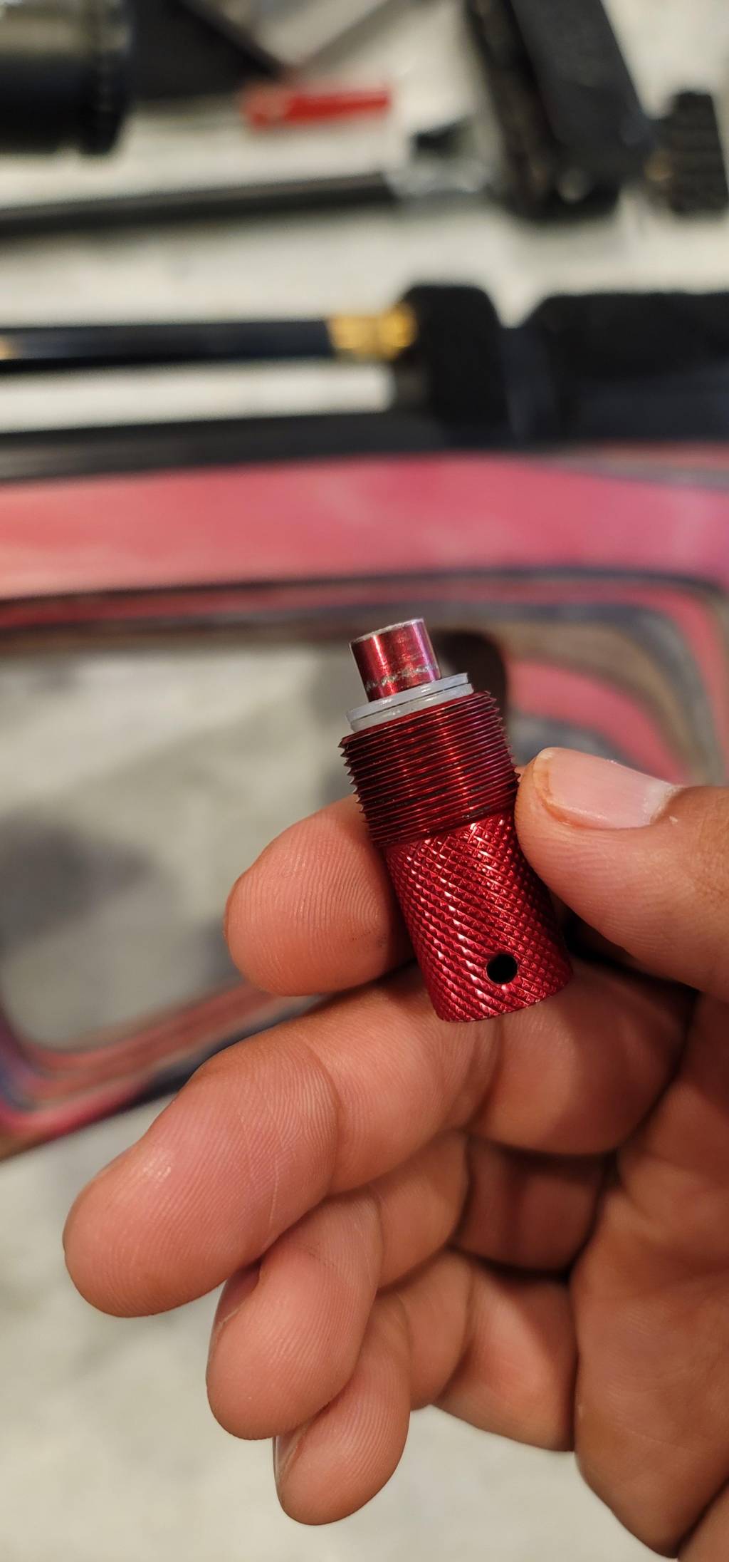

I once experimented with the Talon tunes heavy Hammer spring. Not worth it in my opinion. It did allow me to reach the MAX velocity for my set reg pressure, but cocking effort didn't feel good. Not wanting to put that kind of strain on the components I opted for shimming the factory spring instead.
Before the shims and my 140bar reg pressure, .22cal 25.4gr knockouts could only reach about 880fps. After the shims I was capable of reaching 950fps. Cocking effort was still "harder" but no where near as bad as the heavy spring.
The shims are just nylon washers that I opened up to fit onto the hammer spring adjuster.
