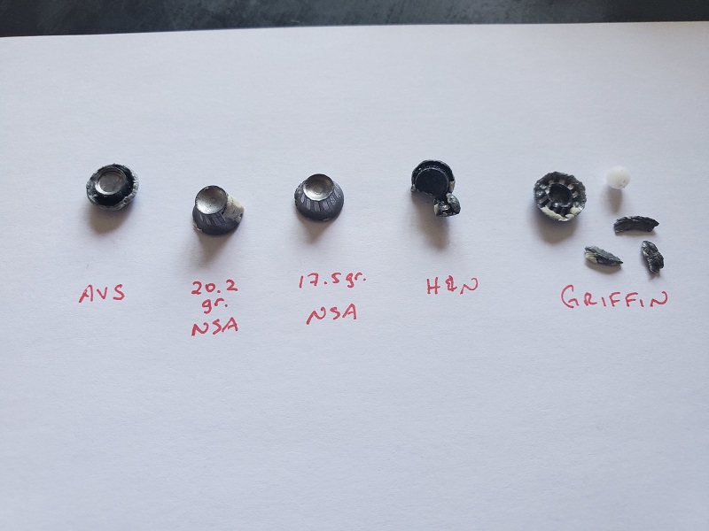

    Expansion and Penetration Test
    42Z4DM673FTr0RQzA4AGOifRFVsMIEXZ2yDZUBt--f3fS2oyd2rph2KH7Hxyiw7dYGl1XA9YgEpcszb1fZjR4bWAakEy7mQEa8T1lOXfqPi4NfDtn1jpeEo4M2pamP5FARNONJU0
    YtW0SlabqaeCtAnHjHKvwS0ZJ3Bqop7mngceRbJbI48F0q9lyQm9Mch3RXw4gYUK_WgnH6T9k37UVkugAaPMxkninZ8kINVlfLLi3HOD4IpMXJR7aMTDuvH0fWr3EoQrKYNoYRgu
    BEiMKrQXDtbFVUKHIYAAVNURevVTdr9U7XimUpeK5QTpT0kir2ll7PKHjYswt4pg52l-zU5QMf4gNDRLP-iP_5Z9KxoWmp7wlLZDGOTKVdYA0KEEWLuit589SoAy4ml4Z0JEpQqK
    The harder and slower moving NSA slugs failed to fully mushroom at this power level. The AVS, H&N, and Griffin slugs had no such trouble.
