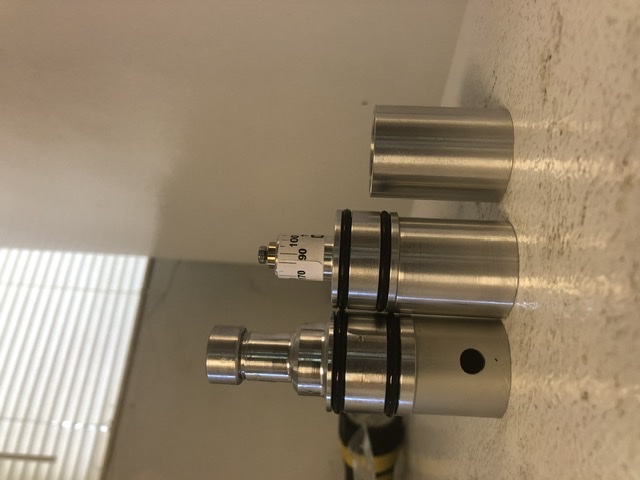

It seems that there are different internal sizes of the Taipan Veteran.
I own a Taipan Veteran std and bought a Huma 38mm plenum reg kit, had no problem installing.
The Taipan regulator is a very good regulator, but one needs a regulator tester for exact adjustment.
When tinkering it saves a lot of costs and work when there is a scale on the reg.
The huma is also smaller in size so there is more space for the main tank and/or the plenum.
I quess Huma wanted to use the maximum of plenum size possible, I would.
I've heard that there are 34MM plenum tube's on there way to Talon tunes
and Huma will only use the 34MM in the future.

New spacer came. The height is now identical. Interesting fact, stock overall length (and now new huma length) is about 1-2mm short. I can tell because i can hear it move back and forth when i tilt the gun. However, this is NOT an issue because when i pressurized the cylinder, it pushed the regulator backwards and sits on the spacer, no longer on the lip inside the cylinder. The net effect is the chamber becomes 1-2mm longer and the plenum 1-2mm shorter. everything went back together nicely. Will start testing tonight or tomorrow.
picture- stock on left, huma with new spacer, old spacer
