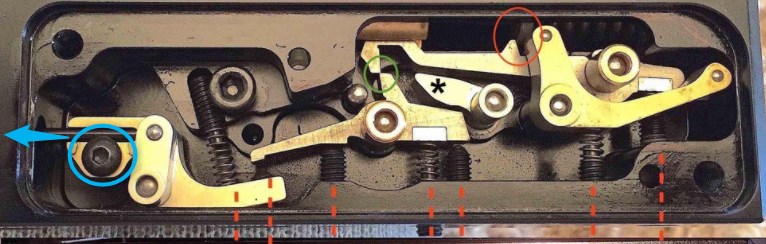

I suspect that the rod that connects the trigger to the trigger mechanism has come loose. This happened with one of mine and it wouldn't cock. I rarely use magazines so don't know if they weren't advancing. I think you might be focusing on the magazine mechanism when that little allen bolt that holds the trigger rod is the problem.
I circled it in blue here, it holds the rod that goes back to the trigger (blue arrow). Gun won't cock and therefore magazine won't advance if that little bolt has loosened up and the rod is just sliding.
