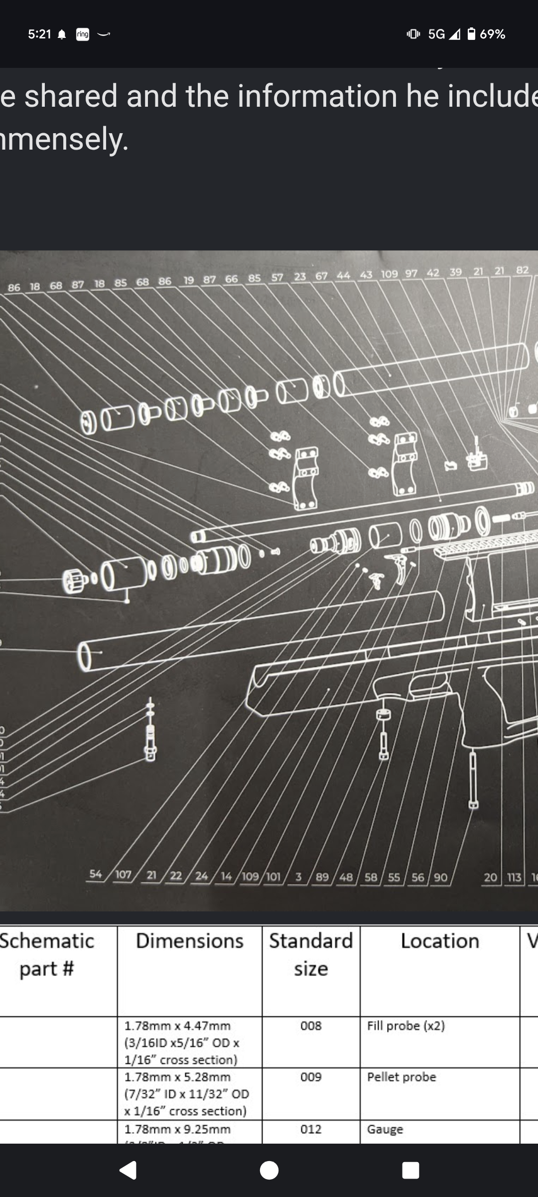

Here are 2 pictures sent to me by HUMA
One shows the original Vet1 regulator oriented properly in the gun
The other shows
The original regulator side by side with the HUMA reg & plenum
View attachment Vet 1 HUMA & original regulatorside by side.pdf
View attachment VET 1 Original regulator.pdf

I would suggest trying the other size of reg spacer.
And looks like you were correct, per schematics, that the reg should be farther away from the breech block, and the reg spacer closer to the breech block.
