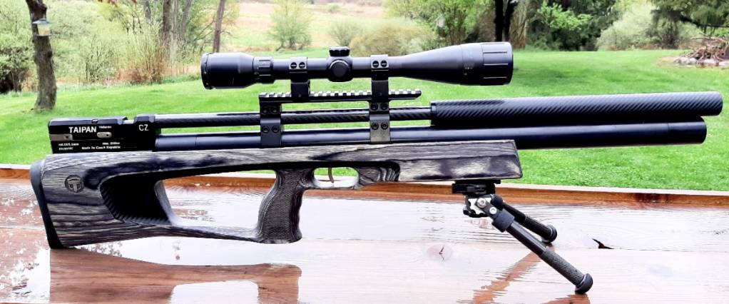

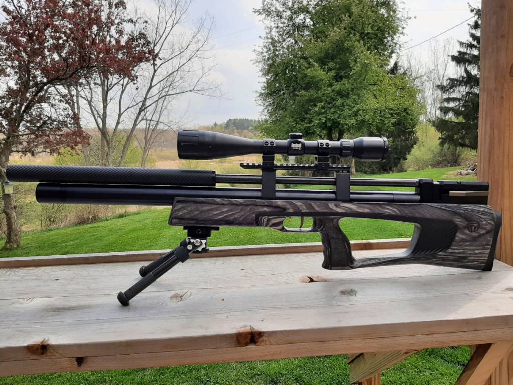

Recently installed a power plenum on my vet and wasn't happy with the look of the shroud coming up short of the air tube.
Pulled the shroud apart and had a look to see how it was put together. I was pretty impressed with the quality of the baffle system.
All that was needed was just a flip of the shroud and a 3.5" spacer. Schedule 40 3/4 PVC fit the shroud perfectly.

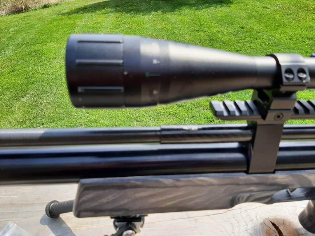

Also added a piece of 15ID x 18OD carbon fiber tube over the barrel to tighten the shroud against and tension the barrel. It did stiffen it up. I think this would be beneficial especially if running the 700mm barrel.
Pics below to show the arrangement.

Thats the stock barrel in the picture. I have a 700mm also. Put it on for a day just to check it out with pellets. Conditions weren't good for testing though. But i did feel the stock barrel did a bit better.
Being your already setup with the 700mm. I would definitely try the carbon fiber tube to stiffen it up. You'd have a good baseline to test for any improvement. Was only $17 for a 500mm piece. Just cut it a couple mm long and tighten the shroud against it.

I extended my shroud to compensate for the added plenum also. I just extended it the exact length of the plenum. The gun was quiet before, it’s even better now with the additional chamber. I like how Taipan does a shroud. Other manufacturers need to take note. With that C-clip in there, it is locked on and not going anywhere.
Agreed. Very well thought out shroud.

I had some time to mess with it today. I ended up shortening it a little more. And since i had the extra carbon fiber tube, I covered the rest of the barrel. Gonna call it good.
