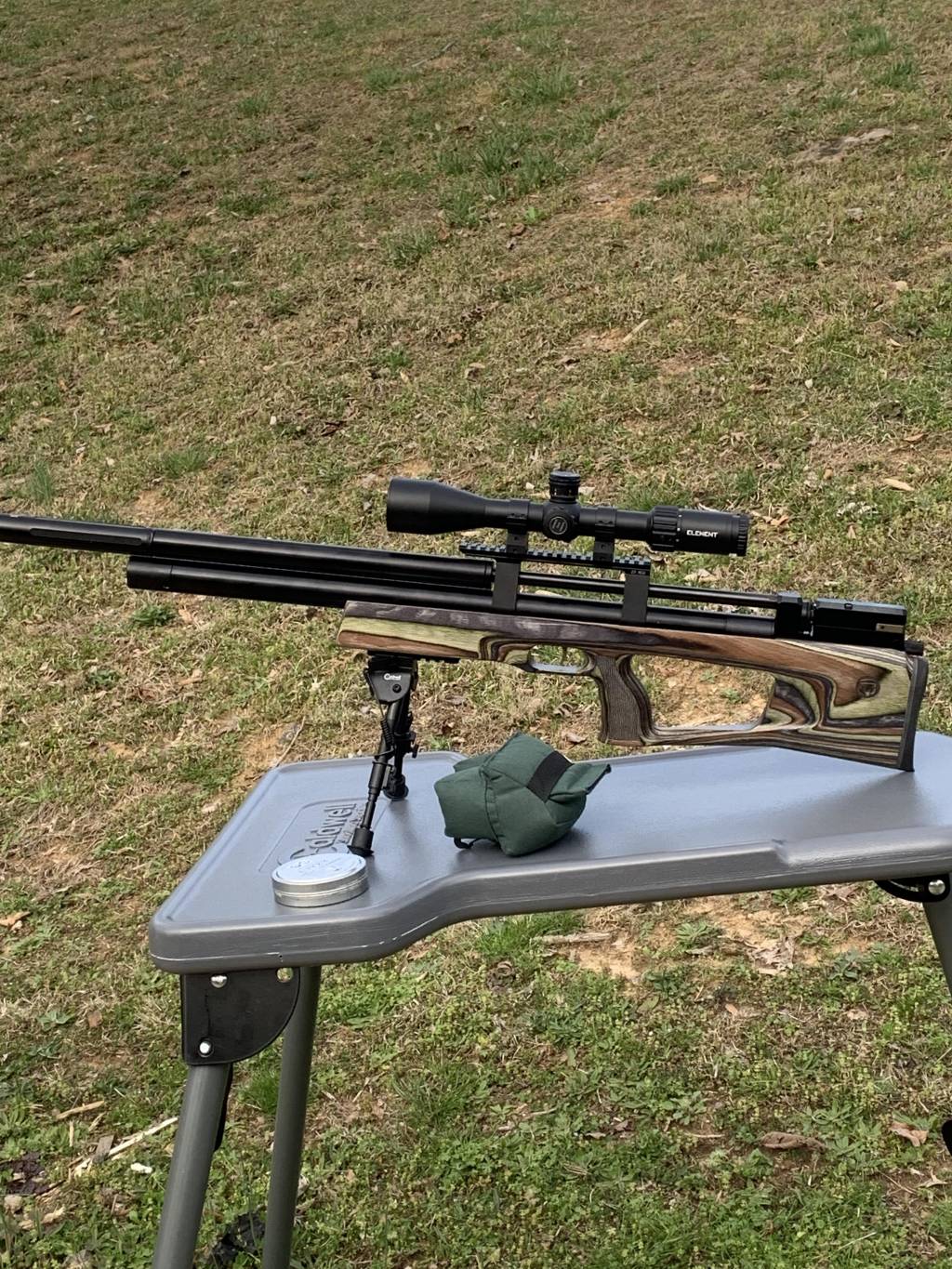

Just received a nice 22 long in grey laminate from Talontunes. A replacement for the Impact i sold over the winter. Had to see what all the fuss was about. I was a little concerned about the weight when i ordered it. But after handling it, I think its a winner.
Can't wait to get a scope on it, switch the side lever to the correct side
 and put some lead downrange. Dont know what Tony does to them before they go out the door? But by the looks of the 30 yard card, I'm going to be more than pleased!

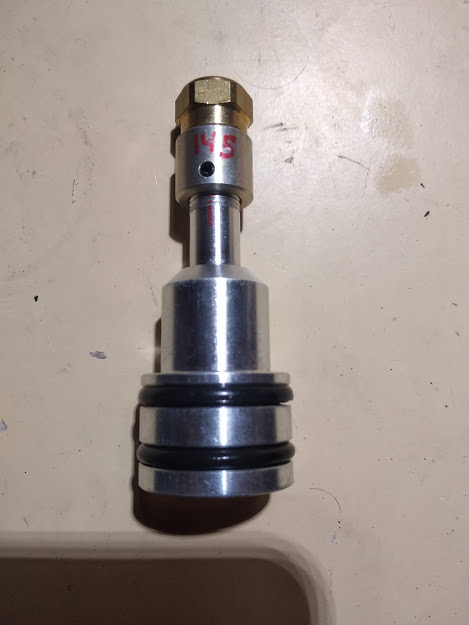

It came tuned shooting 18's at 940. Exactly how I had my impact set up. I find that a good speed for them if accuracy is there. My plan is to tune for efficiency at that speed. Seems during my research weeks ago i caught a post by you stating there were 16 dimples in the reg and one full turn netted about a10 bar change? Memory ain't what it used to be. Thanks
There is no way my Taipan would shoot a 18 at 940 out of its CZ accurately. My best long range groups came right around 900fps. I rotated my brass wheel on the reg 180 degrees and got +10b. My memory and too many guns caused me to start referring to a notebook on my guns. The Taipans barrel is not a FX liner so don’t be surprised if you have to let go of the 940fps thing.

If you bought yours from Talon Tunes, its not set at 110 from the factory unless you ask for it to be. I have a huma reg in mine that is set a 140 bar for my Veteran Long 22cal. I ask Tony for it that way and it is set up for 25.39 JSB's and FX versions and they are as accurate as your going to get at 50+. I turned it down to shoot JSB 18.1's at 890 and I can say that it is not as efficient as it could be. Matter of fact if I were going to shoot JSB 18's all the time, which I am not, I would turn it down to 120 bar. Mine will shot 1034 fps JSB 18's right now at max power. I also have a power plenum installed as well. Mine is not as accurate with JSB 18's as it is with the 25's, but I am going to order the FX and the Daystate version of the JSB 18's and see how ti works out. Even though it is not as efficient it will still get 80+ shots at 890fps with the 18's. Unlike some of these guys, I'm not taking the gun apart every time I change pellets. I'll just buy another gun before I do that. Oh wait, I'll do that anyway. lol. I have got to order a better bipod this week and do some long range testing at 100 yards. That flat bottom stock is not conducive to any of my shooting bags.
