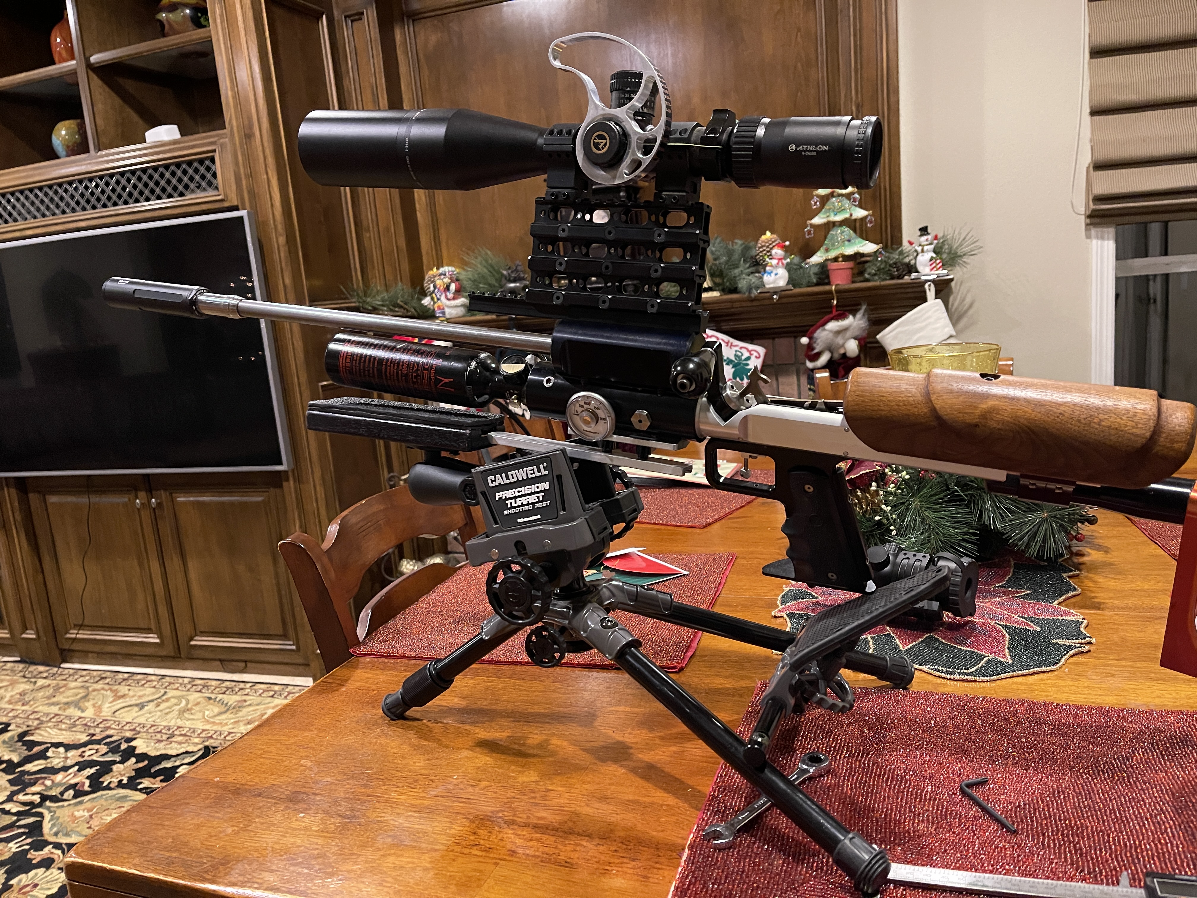

So this is probably pushing it... SH 6"
0.5 MOA between 50 and 55yds...
Dead man friendly...
off hand, not so much and the 35 MOA hold at 10yds... ouch.

Sometimes it helps to remind yourself what it too far, through demonstration... a bad idea born out.
