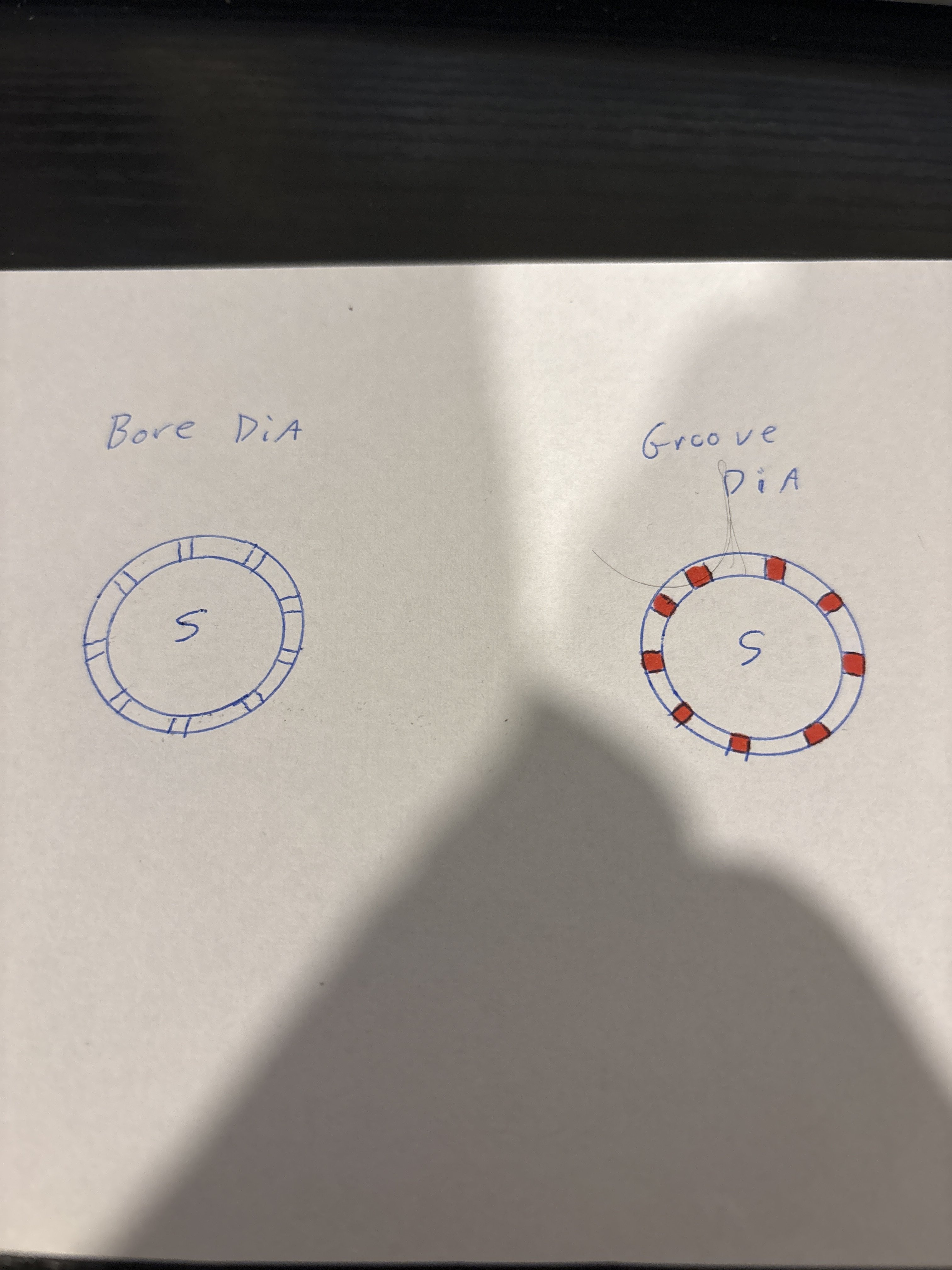

So, what's the problem? Well based on Me and my more learned buddies experience, Taipan has undersized their slug mag, it would use bore diameter where the slug barely engages the lands to provide spin on the slug. Leaves air blowing around the slug through the grooves, affecting accuracy. That's the position we have seen.
Where I diverge from my associates is here, on a standard repeater, the slug that is fitted to the groove as we like, you can feel resistance when it is seated in the lead in. The lands cutting into the slug. However, the slash is semi auto, it blasts the slug into the breach lead in. If it is too tight, can it get caught and mash up into a lump?
I know groove fitting is better than bore fitting with single shot repeaters. But physics may require differently in regards to semi auto. Maybe the accuracy of semi auto has been affected by these requirements.
below is a simple diagram, I'm no artist, the orange color represents the lead of the slug filling the groove of a groove sized slug versus the bore only on the other. NOTE - I KNOW, nice hair! LOL!
