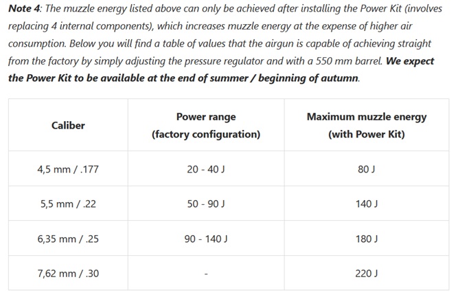

I think it's a bit scummy to advertise a high-power airgun, and then lock the max power setting behind a paywall. Especially for an airgun in this price range. The high-power kit should've been included in the box.

I agree with the spirit of your argument 100%… but even stock the power level at .25 puts it in a fairly elite category power wise. Yeah it’s an expensive gun no doubt but there’s plenty of other brands where you’re gonna spend as much just to get it to stock Slash levels.

As far as a "paywall", my perspective is a little different. I think a paywall usually means we pay for something basic, but the really good stuff cost extra. We kind of get sucked in. We've all been there.
For me, the Slash already comes with the "good stuff". The basic Slash in .22 gets around 37-66 fpe, and the .25 gets 66-103 fpe. How much more power would we want or need from those calibers?
I view the Power Kit as something that most Slash owners probably wouldn't use except in special cases. But, this is just my perspective.
