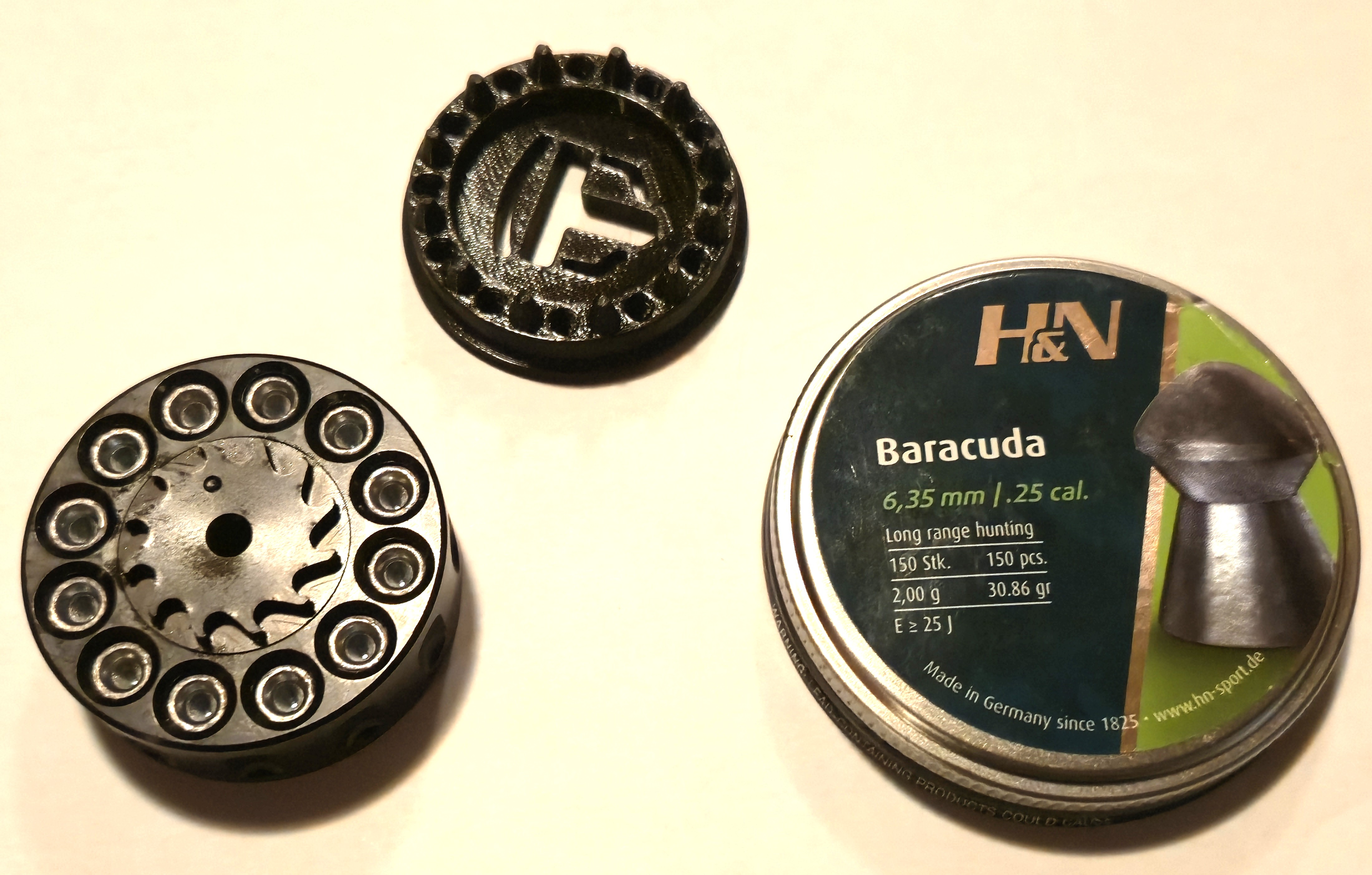

Update concerning some kinds of 0.25 pellets not staying securely in the magazine when pressed into place using the Slash pellet seating tool which comes with the Slash. The pellets work correctly when they are individually inserted more deeply into the magazine than occurs when using the Taipan pellet seating tool.
I reran some more quick velocity tests on the same pellets checked yesterday, including the 3 kinds of pellets which had previously backed out of the magazines during testing. It was a simple problem as suspected. The included Taipan 12-pellet seating device works OK on the Exact Kings and King Heavy MKIIs, but it doesn't seat the other pellet deeply enough in the magazines to be engaged by the tiny ball (on a spring indent?) in the side of each hole in the magazine. The ball appears to catch the pellets on the top edge of the skirt so they don't back out.
I checked around for something to seat the pellet and found a regular plastic ball point pen which worked perfectly. The end swells out enough to prevent the tip of the pen from going too deeply into the magazine. It's easy to sandpaper a bit off the front tip of the pen (minus the ink cartridge) to shorten the depth if necessary. I just started seating the pellets in the magazine using the Taipan tool, and then quickly went around the magazine with the pen to press each pellet in a bit further to the correct depth.

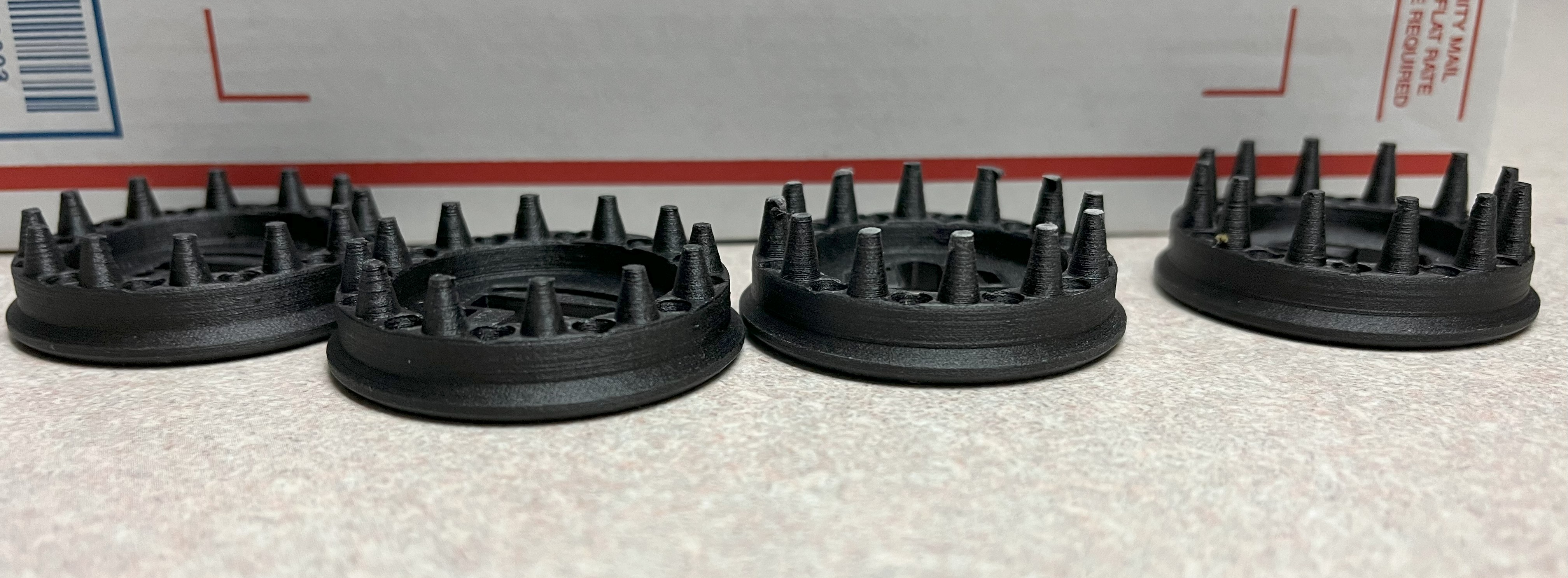

I've attached a picture of the Taipan 12-pellet seating tool which came with the Slash so you can see more clearly what I'm referring to. It leaves the skirts of the Crow Magnum pellets up very close to the face of the magazine. So they weren't being held correctly in place and some backed out while firing and stopped the magazine.
The next picture shows the pen I used to press the pellets deeper into the magazine as shown. It's easy to see the difference in pellet depth in the 2 pictures. The pellets worked fine as long as they were pressed down far enough.

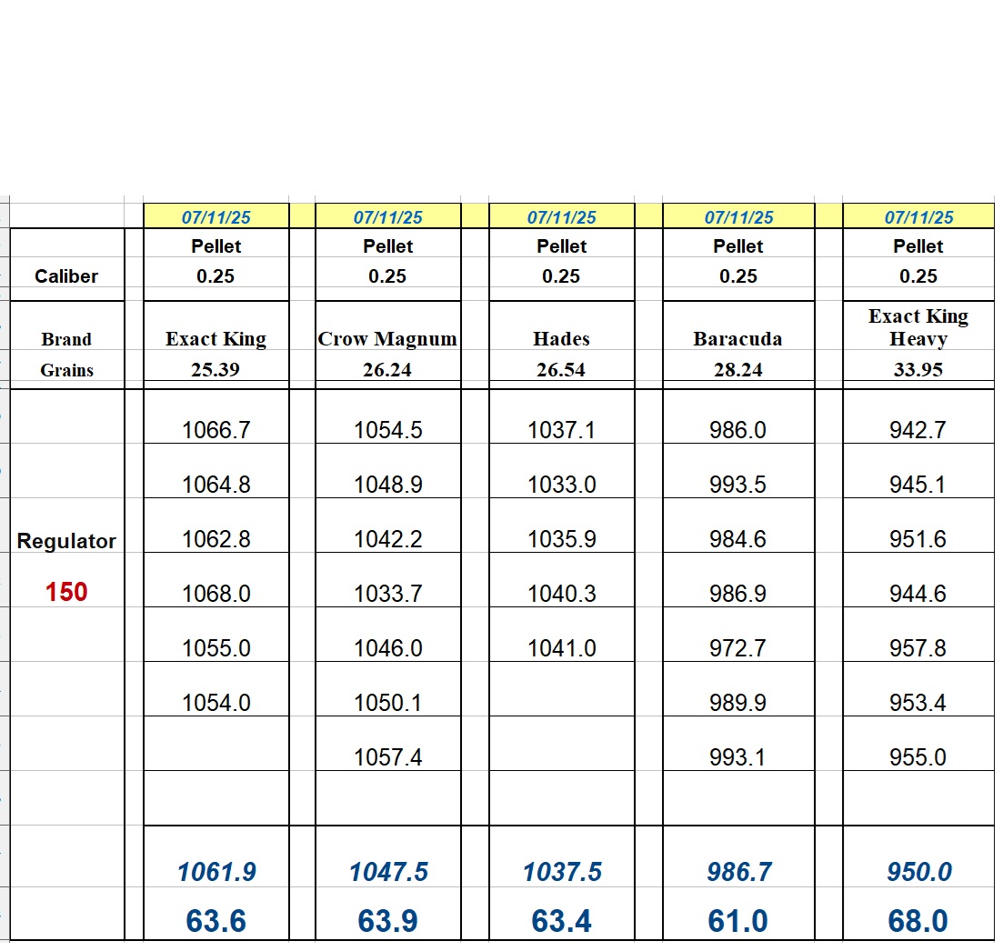

Then I ran some more test shots for the same 5 kinds of pellets as before, at 120 Bar and at 150 Bar on the regulator. At 120 Bar only the Crow Mags had a failure-to-rotate the magazine on the 5th shot. Unclear exactly why though I suspect that the Slash semi auto mechanism is happier/snappier at higher pressures. Previously I had consistent failure of the magazines to rotate when the reg was set down to 100 bar.
At 120 Bar there was a 51fpe to 57fpe shot power range across the 5 kinds of pellets, from the lightest to the heaviest. All but the Exact King Heavy MKII pellets stayed in the 900s range for velocity at those power levels, with the heavier MKIIs dropping into the 800s.
At 150 Bar there was a 61fpe to 68fpe shot power range across the 5 kinds of pellet.
Only the Baracuda (61fpe) and Exact King Heavy MKII (68fpe) kept their average velocities under 1,000f/s at that power level.

So despite my initial concerns over the pellet magazines not securing some lighter pellets correctly, I find that it's just a matter of inserting the pellets to an adequate depth so that they will be held correctly by the magazine's retention mechanisms. Those magazines are much better design and machined than I had expected and a real deal for the price. Once you have some practice it's easy to pop out a magazine and to roll and press-click a new one into place.
