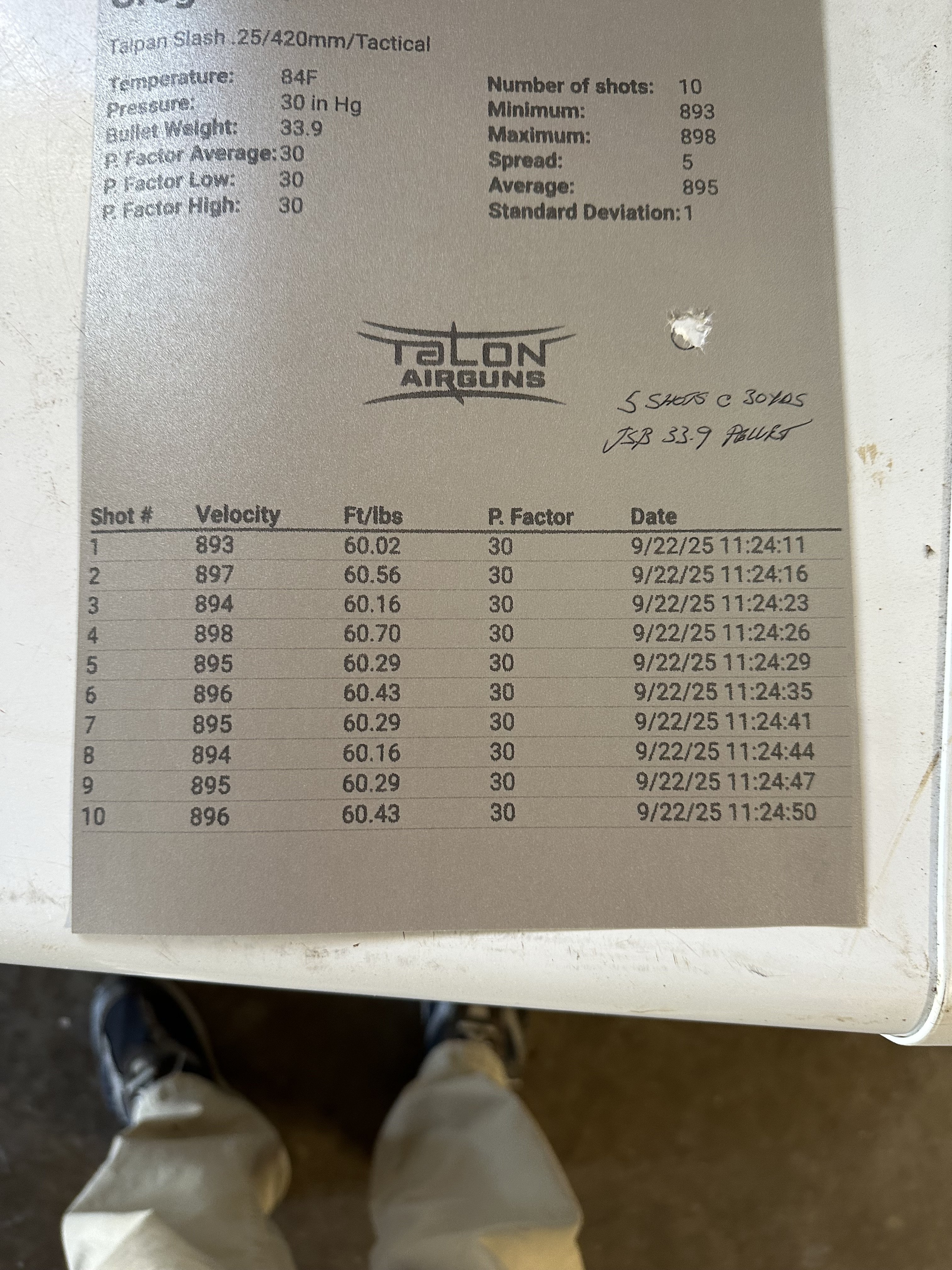

This isn't a range trip yet.. But I was able to get it over the chronograph for a full string with pellets.
I've only done one full string at a velocity I wanted so there is more to try of course.
Over 50 shots at the power I'm running seems to be in line with Huben? I can't really remember and as well, mine was a .25.
The power can be set a lot higher than I have mine set at the moment but I'm just starting to see what this tune may bring to a target.

At 912 fps with 25.4 grain AEA pellets, as well as the 25 grain .217 H&N slugs (both shoot the same fps) I'm getting over 50 shots from a (294) bar fill.
The regulator is giving 15 fps spread over the total shot string 3 SD and the reg isn't broken in yet.
