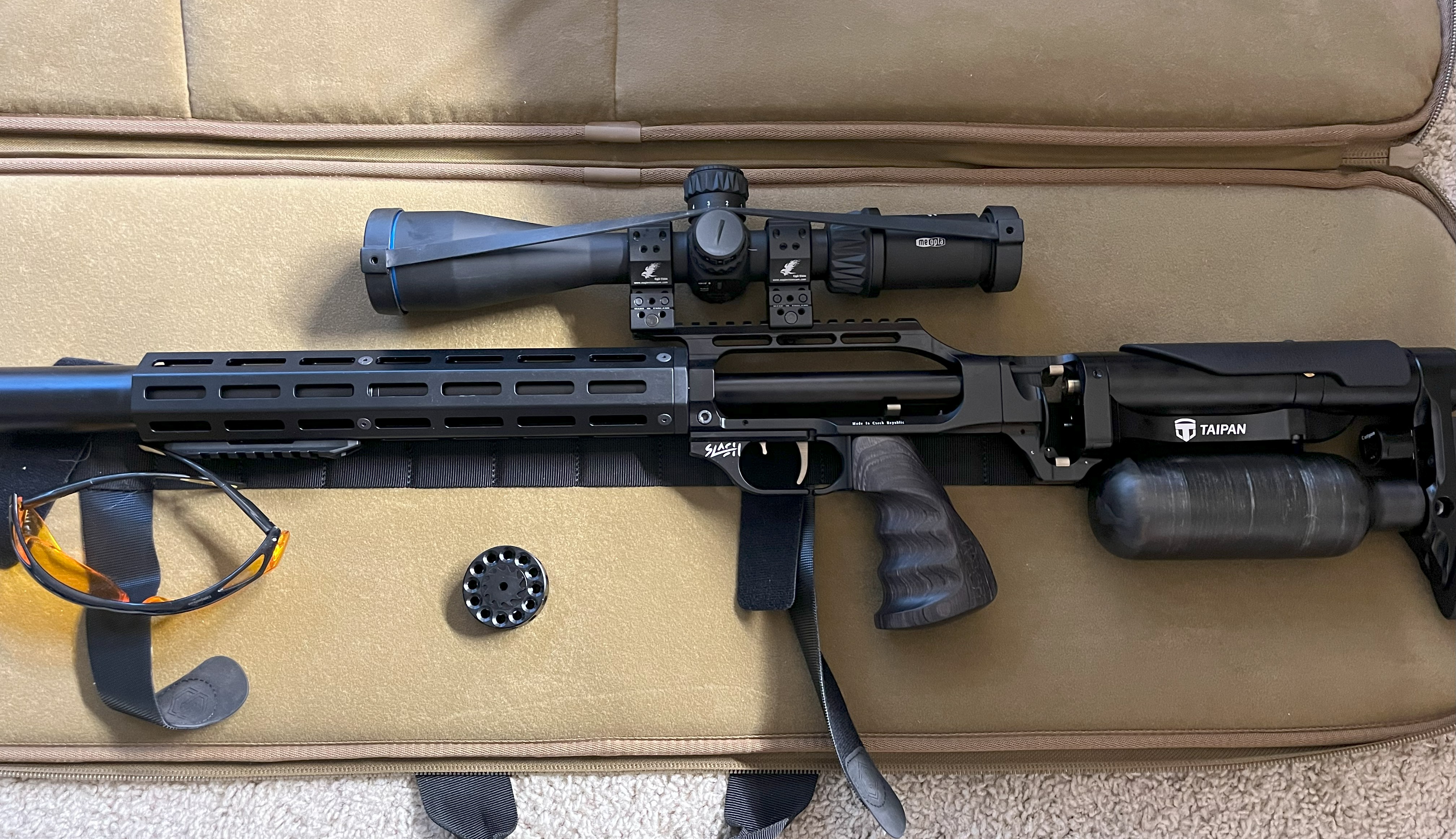

This one is the .22 550mm barrel tactical version.

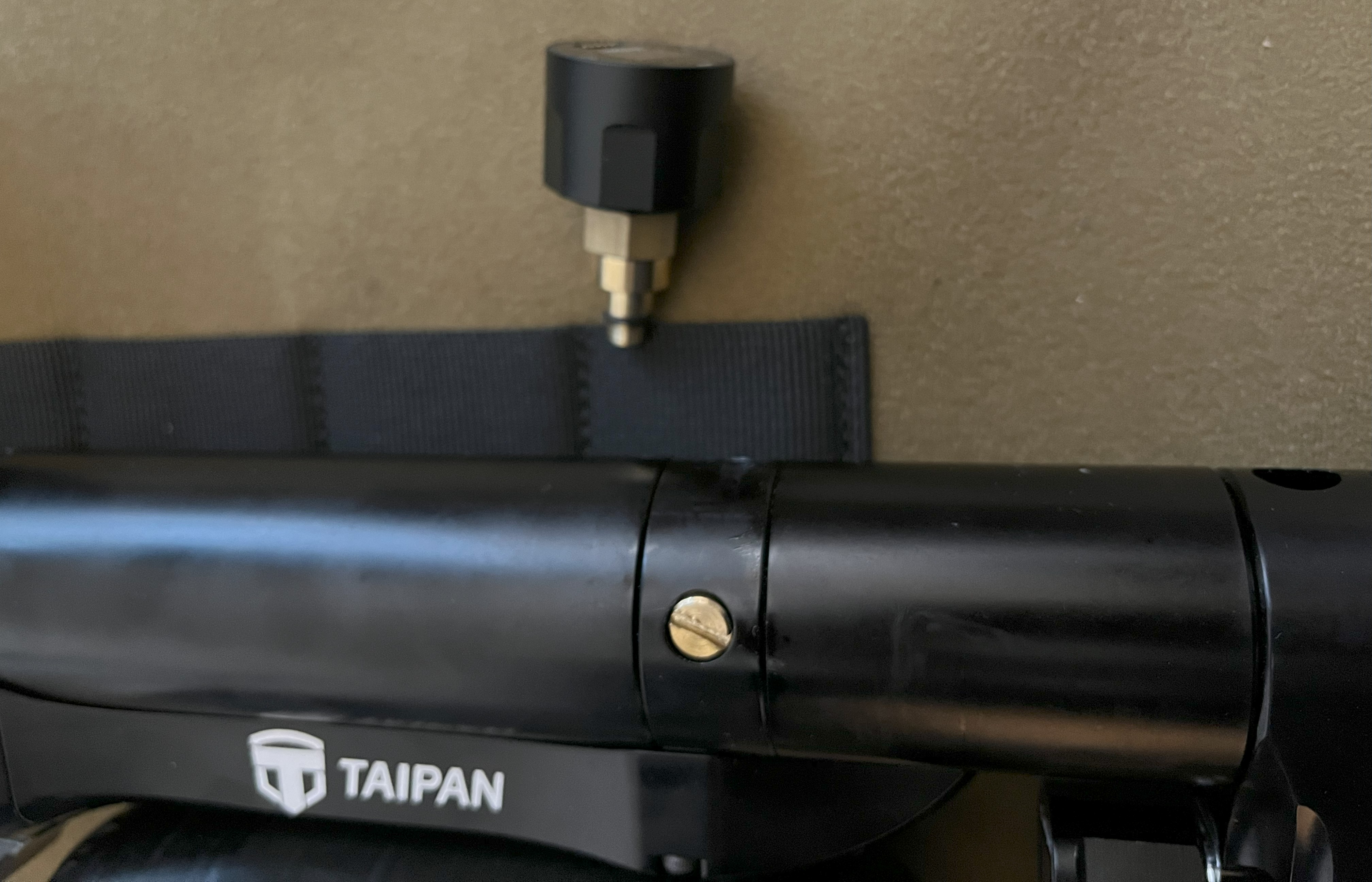

Tuning is done by removing the cheek piece and unscrewing a flat head screw (brass) on the left side of the plenum and replacing it with a gauge (supplied) and an adapter for the removed screw to 1/8 bspp.
Then remove the back cover above the butt pad with 2 screws and start tuning.
I do de-gas when going either direction just to be safe but I believe it's designed to tune gassed up.
At 912 fps with 25.4 grain AEA pellets, as well as the 25 grain .217 H&N slugs (both shoot the same fps) I'm getting over 50 shots from a (294) bar fill.
The regulator is giving 15 fps spread over the total shot string 3 SD and the reg isn't broken in yet.
The rear butt pad is adjustable and can be lowered about one inch which suits me well.

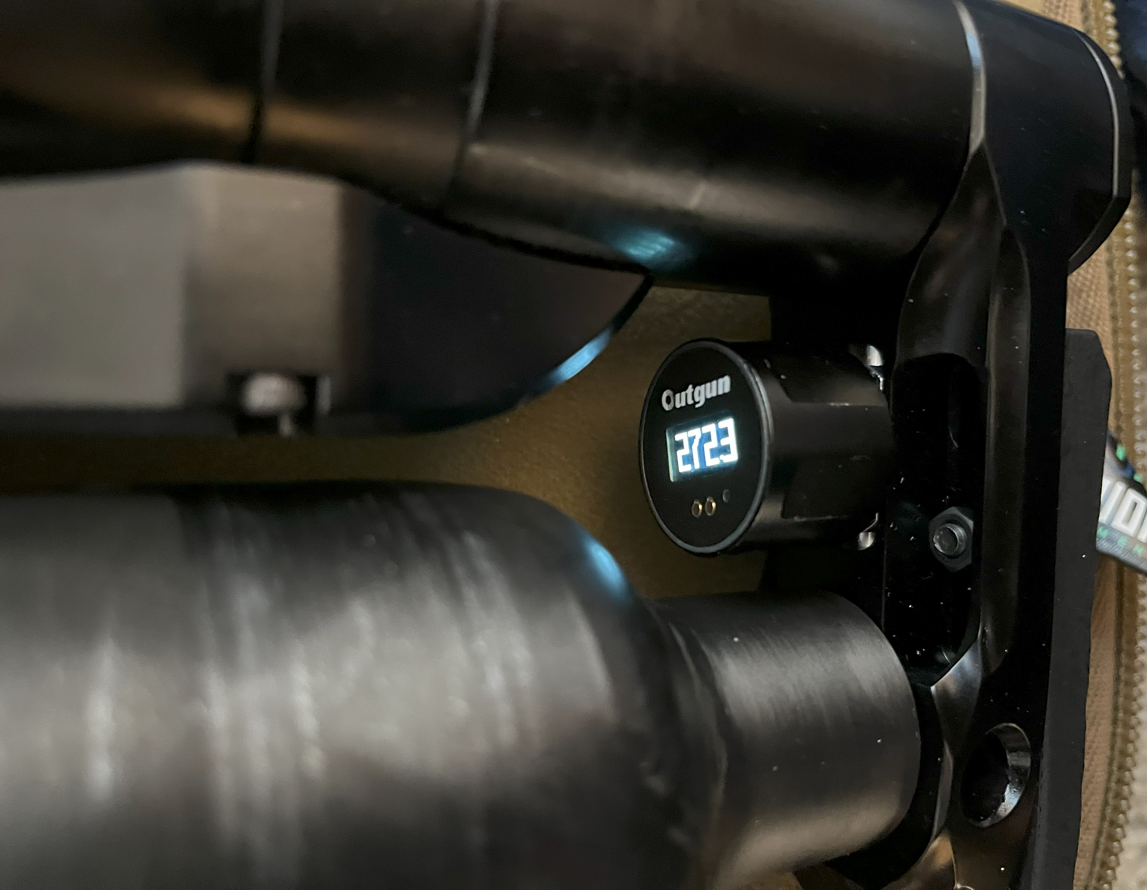

I put an outgun 25mm gauge on the airguns total pressure and the Sekhmet 28mm was just used for tuning in the tuning air port.

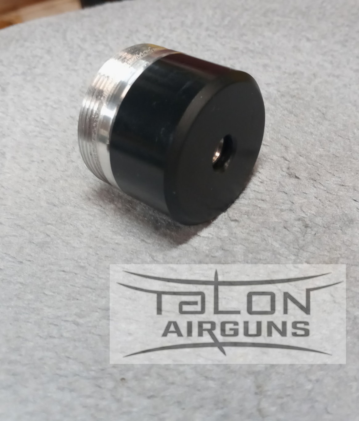

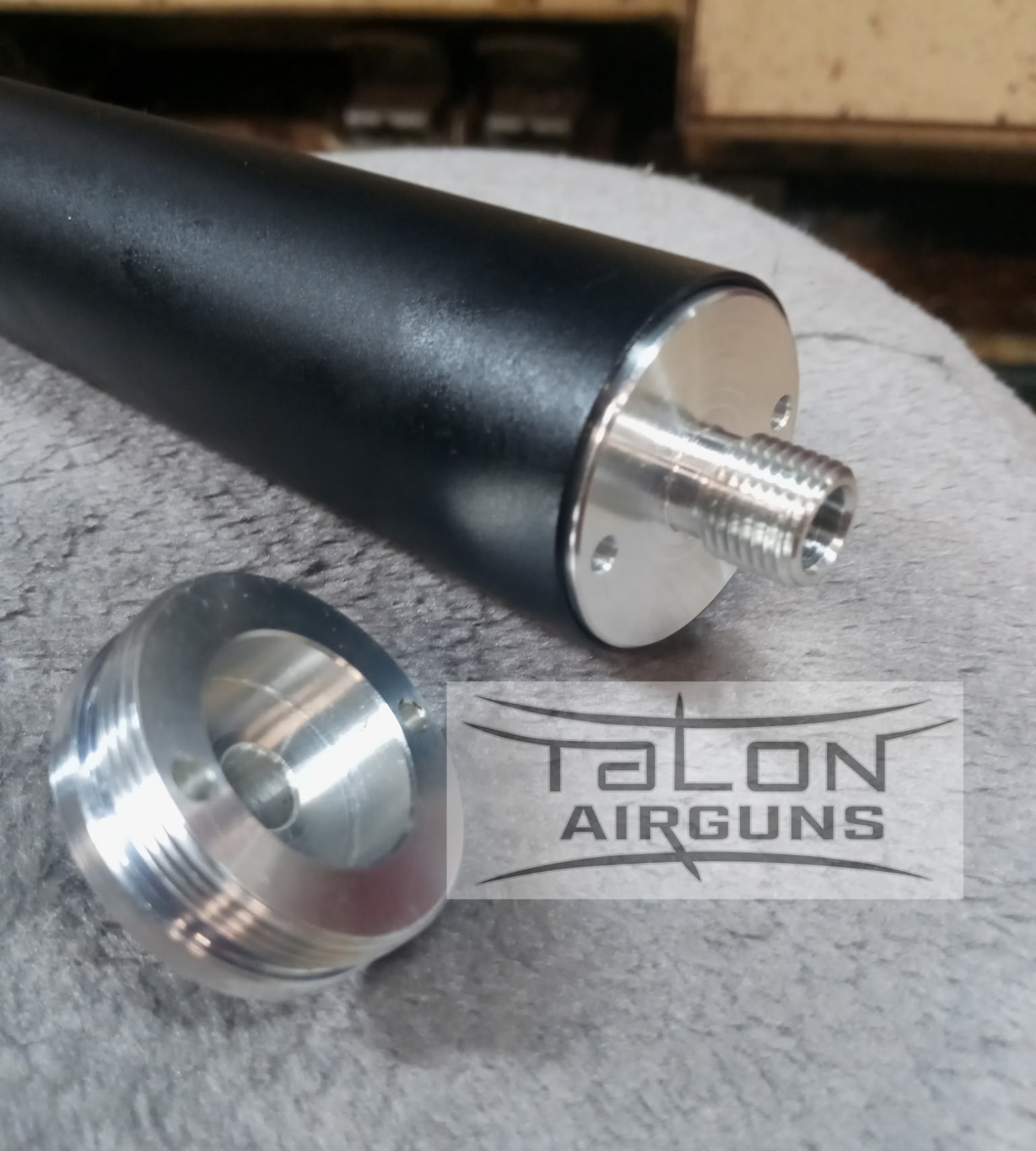

Edit: Tony has thread 1/2x20 thread adapters made for this Slash as well as the Taipan Veteran II that's 1/2 unf..
The pics show the adapter prior to the anodizing being done. The thread protectors will be Delrin.
May be available by the end of next week

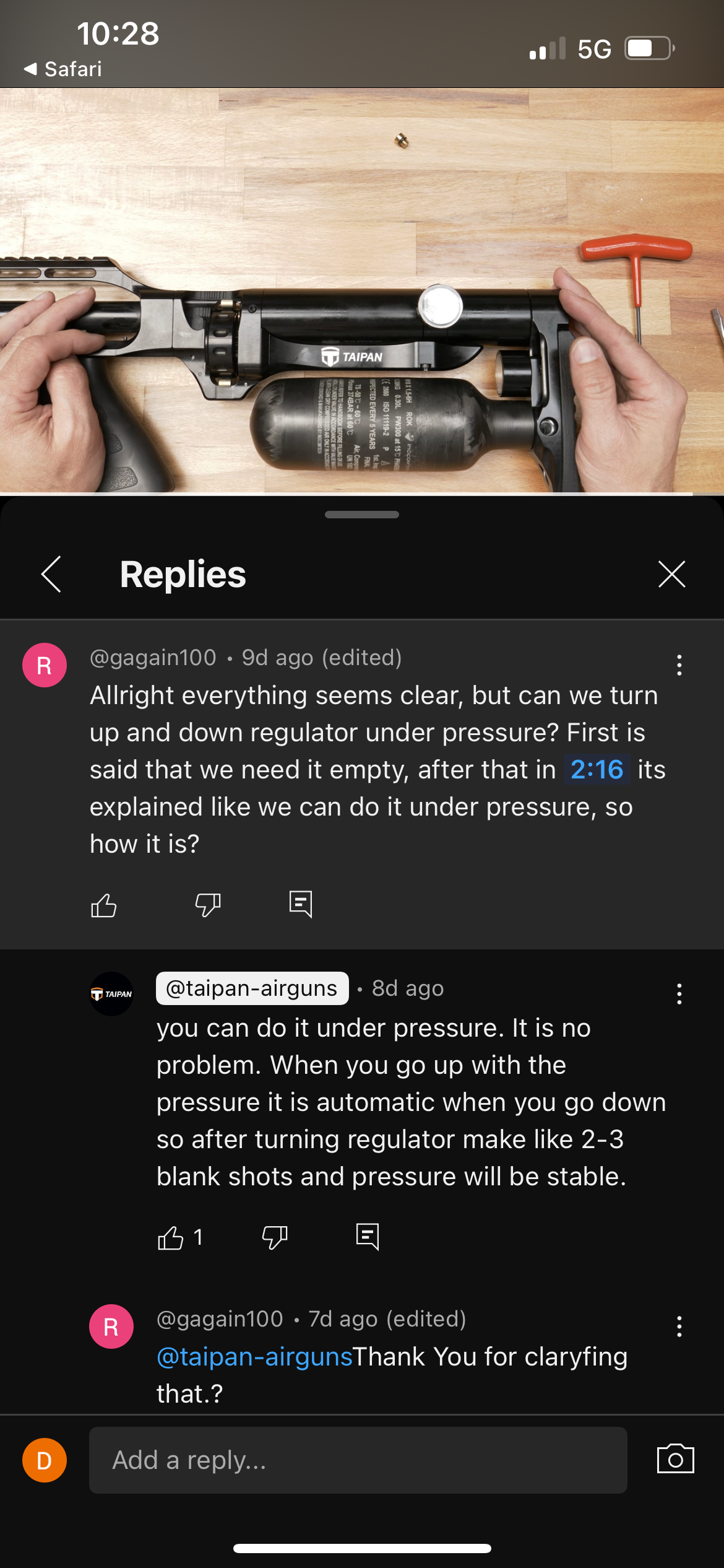

I don't think Taipan has made this clear yet. I'm degassing for all moves up of down at the moment until clarification is made by them. What you say does seem logical though and likely the way it's designed.
I'm just doing what I am out of caution for now. On the Taipan.. CW is more pressure and CCW is less.. Very straight forward and easily done. I almost see that adding the reg gauge to tune like a fighter jet retracting it's landing gear. This design keeps things simplified and it really helps as it's so easy to shoulder and helps make a narrower rifles case.
Reactions: bernieorosz
I agree Taipan needs to clarify this...
I mentioned the method without degassing, because it seemed like that was what they were talking about in their Taipan SLASH – Regulator Adjustment Guide video.
They mentioned degassing to install reg gauge and appear to say fill up with air after that. Because, they go on to say dry fire 2-3 times after turning ccw to reduce reg pressure.
Reactions: MACTEN
So, my takeaway from the regulator adjustment is very positive.... Unless I don't fully understand yet... :).
We can adjust the Taipan Slash regulator up or down, without ever having to degas the gun! This is a good thing. But won't know reg setting until fps drops.
However, the ability to fine tune and adjust, with installing the reg gauge is also an option. This is good because we can actually view the reg settings after changes. But, at some point, to remove that temp gauge, we must degas again.
Reactions: MACTEN
