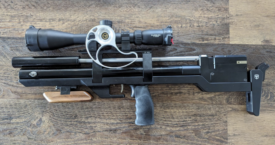

Taipan shorty in a Standard stock 😎

Right now my youngest son is using the action with the trigger rod from the Short. So I don't need to worry about it for a couple years, but eventually he'll need to transition to the longer LOP of the Standard.
Wondering if anybody has had the nerve to try this same feat (Shorty action in a Standard stock) by lengthening the trigger rod?

A gen 1 Vet Short can be fitted to the aluminum stock meant for a Standard or a Long.....
You have to steal the scope tower/air tube clamps and trigger rod from a Standard, and add one plenum to the Short's tube. The aluminum forend section is about 1/8" proud of the gauge shield at the end of the air tube.
The barrel here is also a bit longer than a regular Vet Short barrel. If using an OEM length Vet Short barrel, the shroud, air tube, and aluminum forend would all be the same length (within 1/8" anyway).
