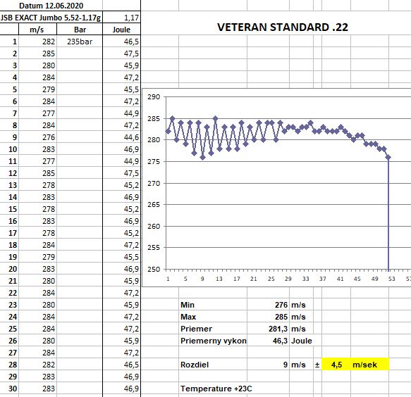

I did some chrony of veteran std cal.22 The first picture is with JSB Jumbo 16grains speed tuned to 905fps and second one if with JSB Heavy 18grains tuned to 921fps.
Something is interesting. Why is so big spread from begin? I filled the gun in both instances to 235bar. Speed seted with HST for JSB Jumbo is slow with jumbo pellets - there is bigger deviation. But on second picture I crank at up the speed of JSB HEAVY to 921FPS but why is so big spread on begin?? Let say after 25 shots the regulator running well but why not from begin? Accuracy is better from 180bar.
Sorry for metric unit but I think graph is clear.

i just read your charts , the heavier pellets were more stable , no surprise at those speeds. if gun is tuned correctly , spread in velocity should be around 10 fps / 3 m/s mine were with 25 cal 34g jsb velocity spread of 8 fps or 2 m/s . that is what the gun does when close to balanced.
ALSO - i only pressured gun to 220 bar and shot from there , this is where the lower reg setting may help you , start at 220 bar , shoot down to power drop , which now should be 140 bar. see how many shots and spread. then if possible , tune reg to 130 bar. then repeat full shot string starting at 220 bar and it should go until about 110 bar. if you do not wish to remove the reg. then i would say dial down the HST to 880 fps/ 270mps for the 18g jsb. shoot string again from 220 bar until drop off. check and see if gun settles down. i suspect you have it cranked up to high and thats why it takes 20 shots to settle down and become consistent.
