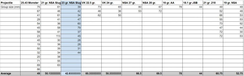

Here is some data I've collected shooting 5 shot groups at 104 yards. I'm settling on the NSA 19, 21 and 23 grain slugs. The Varmint Knockers are just as good, but with the huge price decrease in the NSA slugs coming soon, I will be focusing on them.
My .22 Veteran Long prefers shooting NSA 19 ,21, and 23 grain slugs vs. the heavier versions. The 23 grain version is currently holding the edge over the other weights, but that could change as I collect more data.
The velocity is a little faster with the .217 diameter slugs vs. the .218 diameter. I don't see much statistical difference in the accuracy between the 2 diameters but shoot the .217 diameter because I think they will fowl the barrel less quickly.
I haven't played with the velocity range yet. I'm shooting them all at 900 fps. I'm trying to collect enough data on each slug and decide on just one before I tune to that slug's best velocity.

Right now I'm leaning towards sticking with the 21 grain slugs because the gun seems to shoot them about as well as the 23 grain but I get more shots per fill. If I go the 19 grain route, I'll probably need to lower my reg pressure a tad because the velocity of the lighter pellets starts to creep up as the gun goes off the reg. No such problem with the 21 or 23 grain. I really don't want to adjust the reg pressure.
