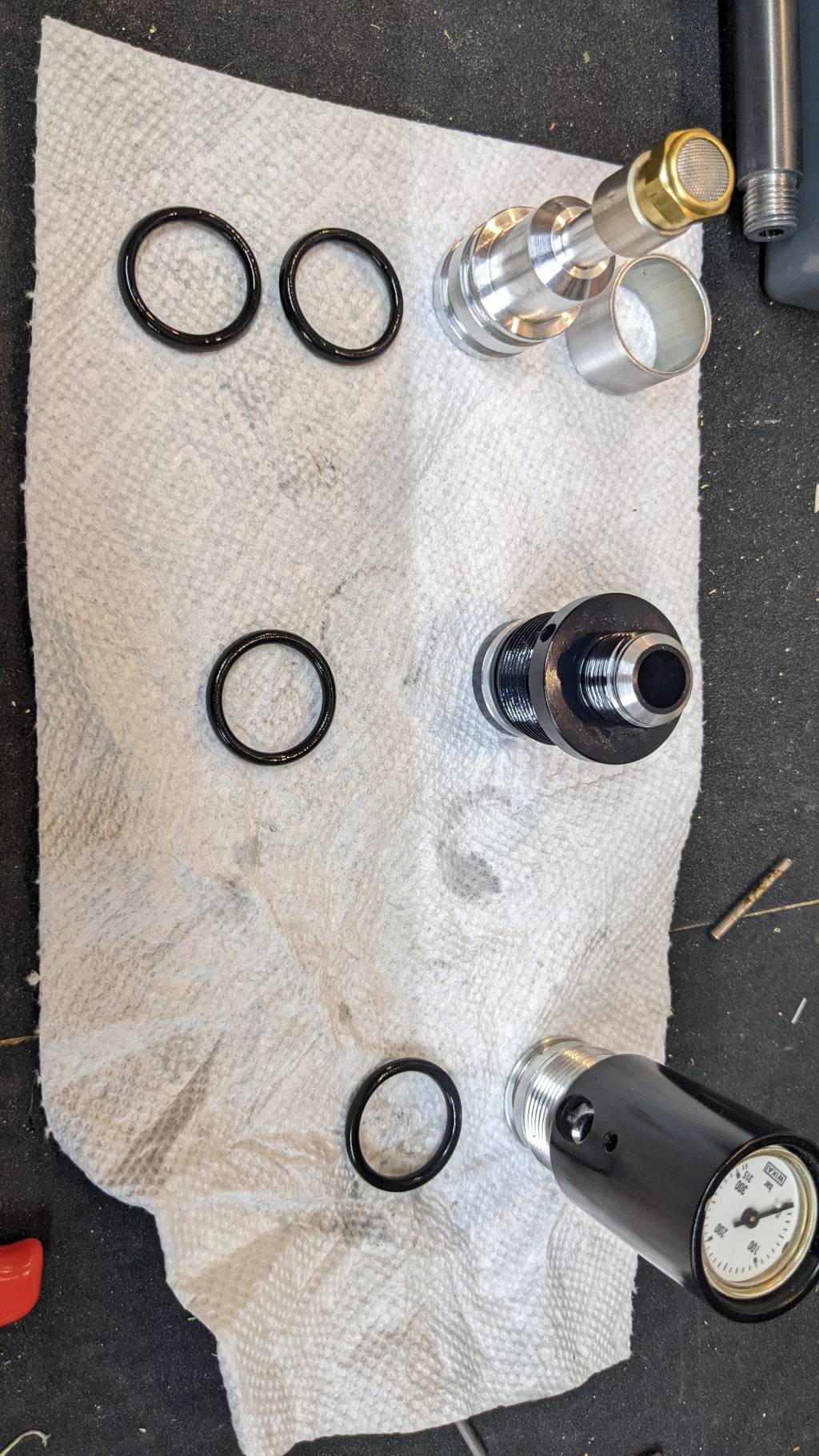

Nice!. Can you tell us where was the leak, and how it was repaired?
Looks like it was all the orings - they were all squished into triangle shapes. Most likely it was the one in the breech block for the valve (face?).
Scott replaced the tube and regulator seals.
Thanks. This seal seems to be my issue, which allows air to bleed out the lower grub setscrew which holds in the valve body. The valve is tight and sealed so no air out the barrel just dumping around the entire valve block assemby. I disassembled and lubed the oring on a trial and it stopped leaking after the reassembly. I don't have a repair o-ring kit yet so this is probably a temp fix. Thx.
