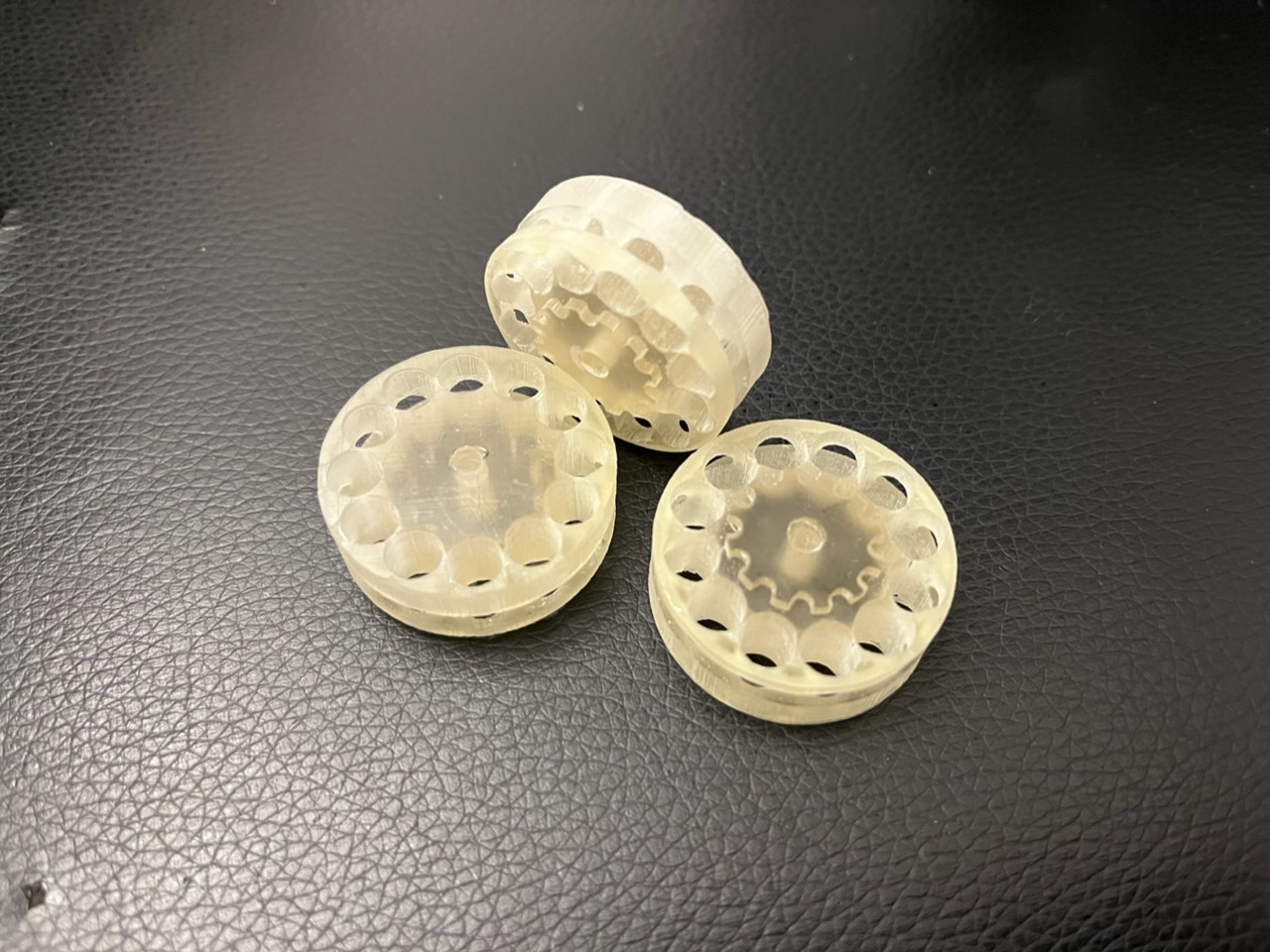

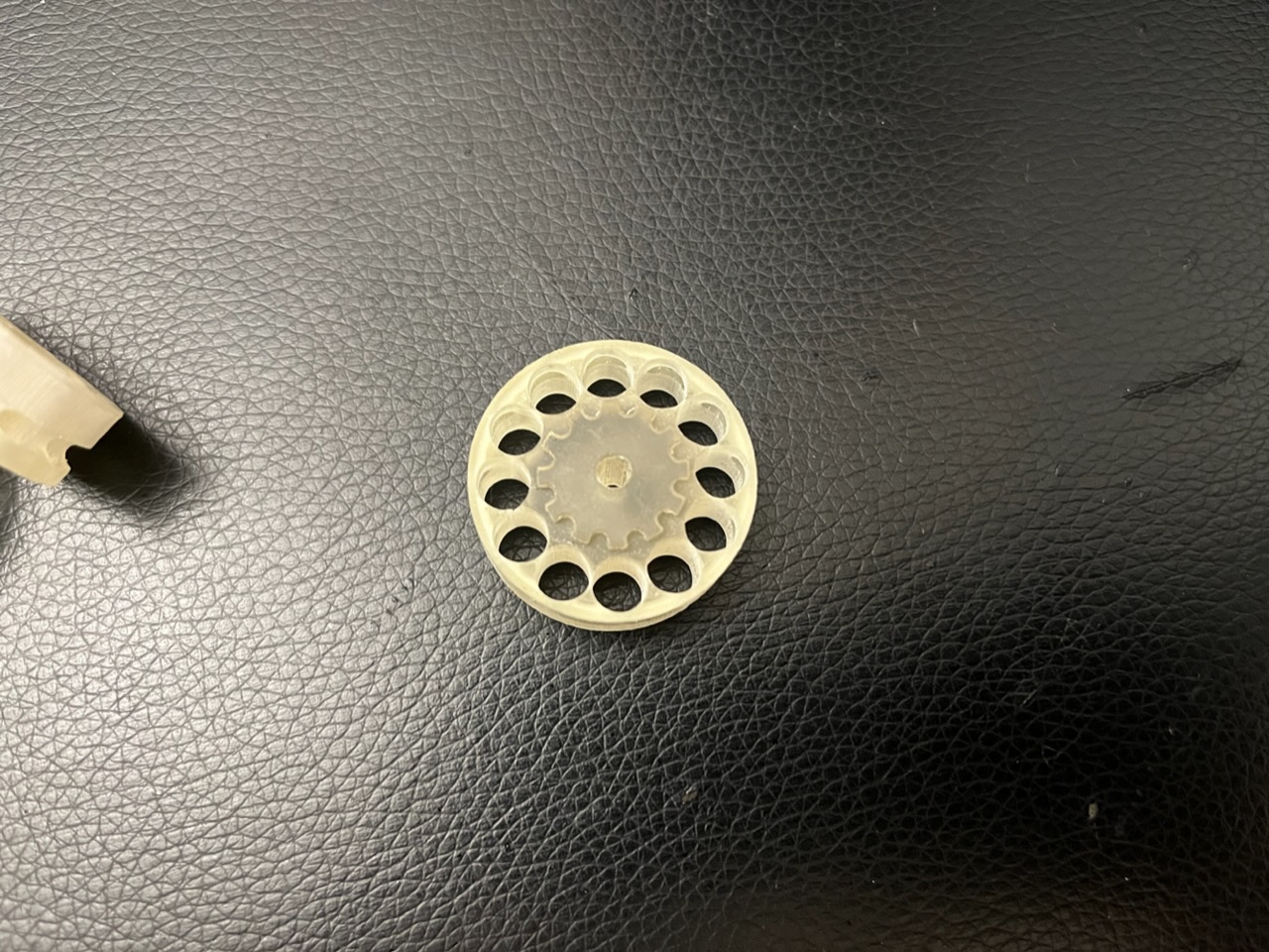

I didn't plan on taking this route, but after trying to buy it from someone at GTA, the seller refuse or don't want to sell it to me for some strange reason. So, I decided to make my own. Bought myself a 3d resin printer and some research and got it working after 6-7 try. The walls between the pellets are thin thin, but it's working and indexing as it should. Anyone want to try 3d resin printing them self, feels free to dl the attachment. This is for 3d RESIN printing, NOT 3d filament printing.
I use tinkercad to draw this, so it's free.
Here's the resin recipe so it wont be too fragile
10% Siraya Tech Tenacious 3D Printer Resin Flexible
90% Anycubic normal resin
I just started this 3d thing last month, so I do not know any more info regarding 3d resin printing.
enjoy
