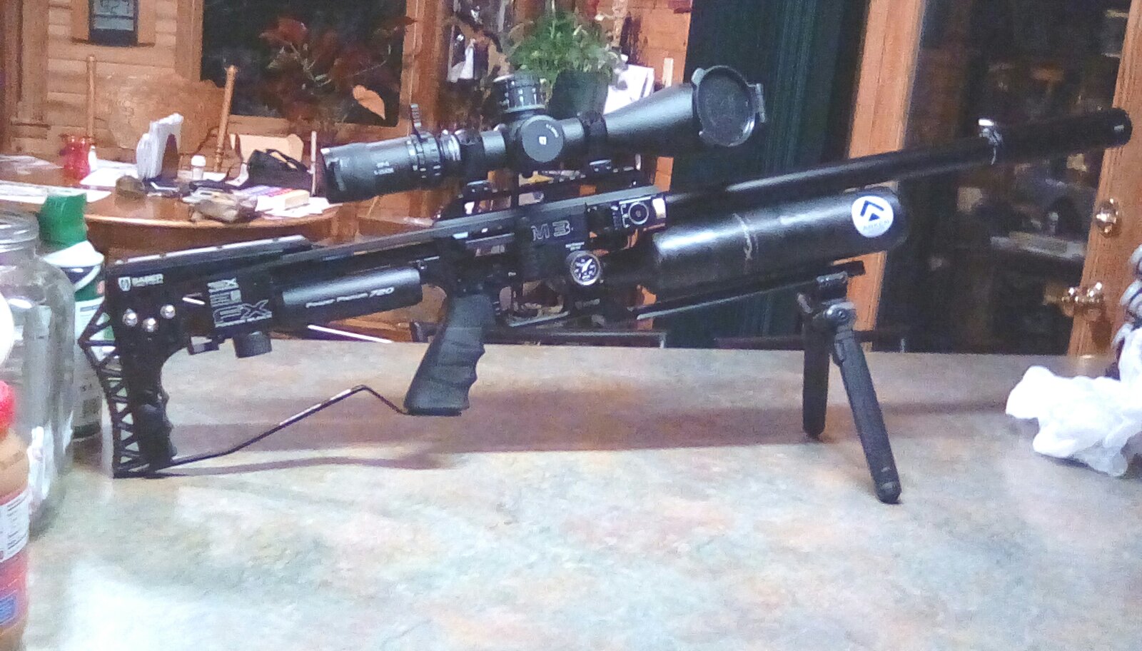

Fantastic air rifle! I have a very similar setup and it's super consistent. Might I suggest trying FX Hybrid slugs? Out of my Taipan they are lasers at 985 fps. I think the slightly choked CZ barrels play well with the mostly hollow Hybrids.
Not to hijack your thread but here is a thread that I've been doing on my journey with the Taipan "Sniper".
