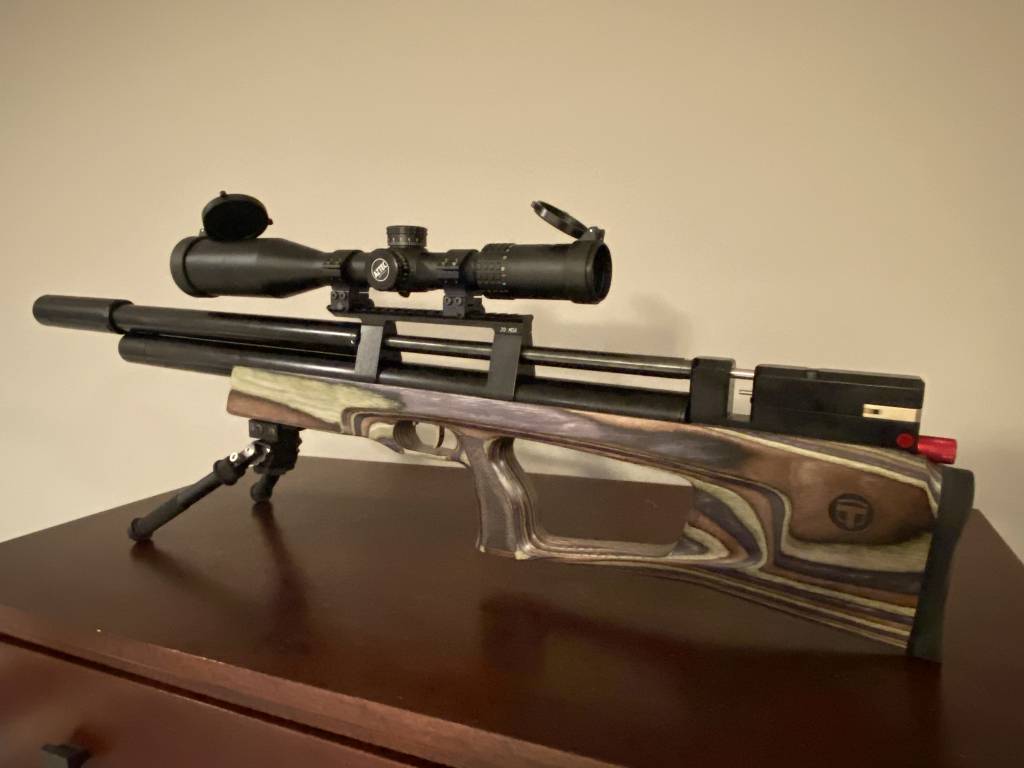

Hi all,
I bought a Taipan Long .25 about 10 months ago. I shot it a bit, but got totally preoccupied by a few other airguns. My long was weird. It would put MK2's at 900 fps into half inch groups, but then, some ridiculous flyer would happen like 2-3 MOA off. It really had me perplexed till now... I finally brought it down to my indoor basement range and started the troubleshooting.

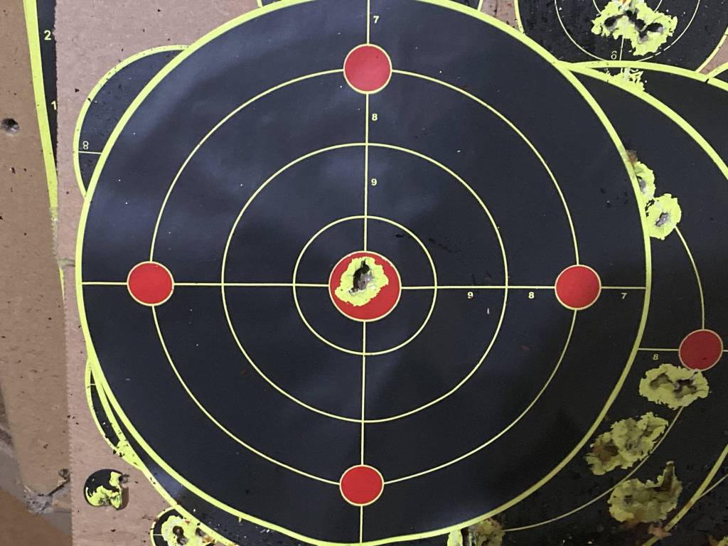

I took them all out, and tested with the Donny and without. Was definitely the OEM air strippers causing the problem. Tuned it without them, and there we had it. Decided to shoot her without either moderator with MK2's, and sure enough... pellet on pellet 20 yrds.
So relieved I found the issue. It was utterly frustrating until now. Tweaked the HST. Took it out to 50 yrds with NSA 26.5 gr and MK2's, amazing accuracy... 7 to 10mm groups with both.

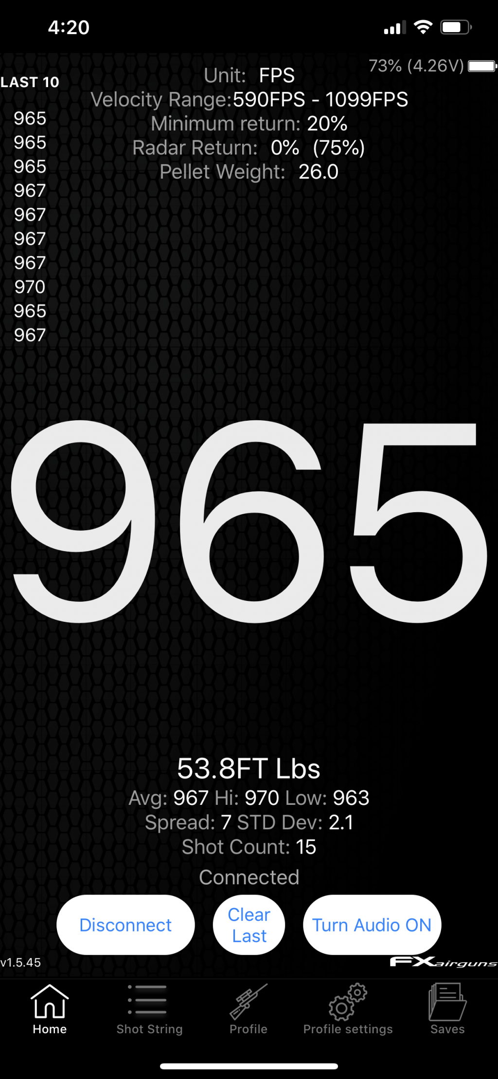

String is 15 .25 FX Hybrids. Target is 15 at 20 yrds.
