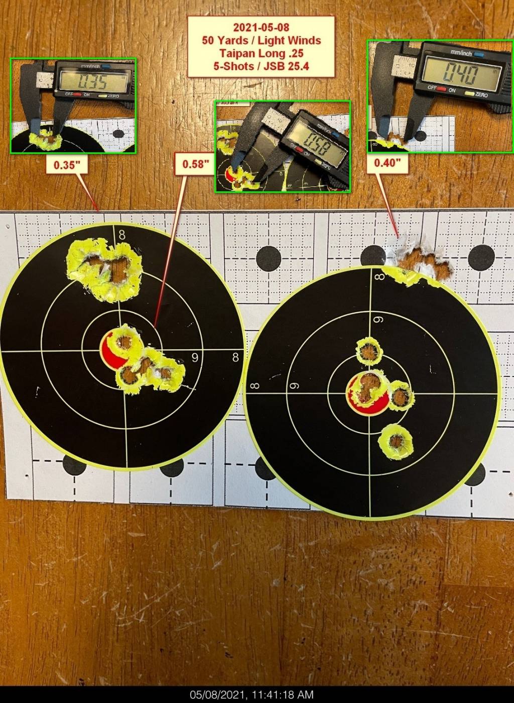

My Taipan Veteran Long .25 can regularly get 1/2" groups at 50 yards if it's not too windy. Very accurate gun. I purchased it new in 2020 from Charlie Frear at Georgia Airguns. It has the newer style stock with the 'T' on it, and probably a LW barrel.
Here's a pic from last month, 05/2021, that I saved. I'm shooting the JSB 25.4's at 912 fps which seems to be best for this gun.

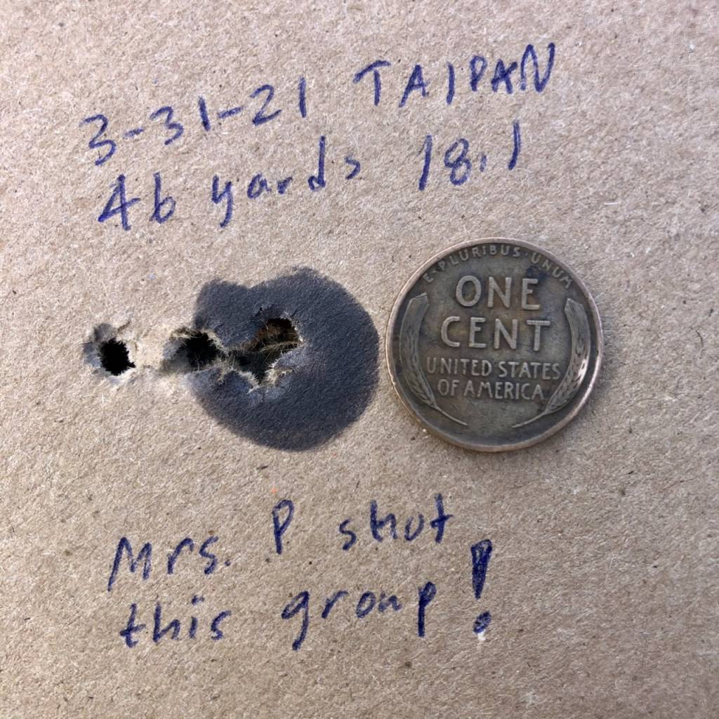

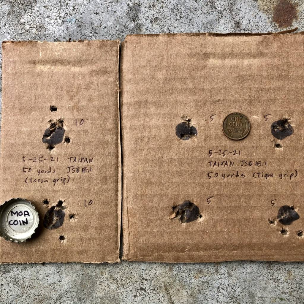

This doesn't count since you asked for 25 cal and these are 22 but I just felt that I NEEDED to share mine. This is the norm for my abilities....
I'm usually shooting prone with a front bipod and rear bag with the standard. I have found that MY Taipan shoots more precise with a firmer grip vs. a loose grip. You can see the difference on that second picture. I have mine shooting JSB 18.1 @ 780 FPS. I go for shot count over power or a balance between the two.
OH, and that last picture is a good example of a tight vs. loose grip. Top is loose and bottom is tight. I may be able to lessen the difference with some trigger adjustment? But I have it where I like it and I know how it responds so I'm good with it.....
