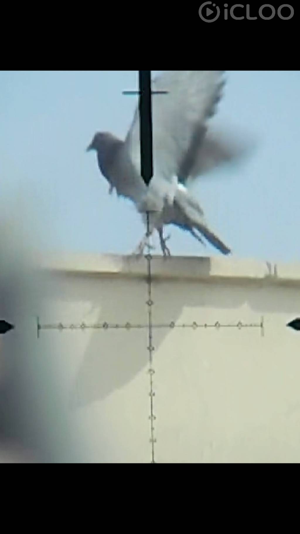

Mine seems to work great. I have an older Galaxy and to transfer a minute long video clip from the Tactacam to the phone to review where my shot hit takes about 2 minutes tops.....
Here's a still from such a video — pigeon with an open chest, still trying to fly off.... 🙄
