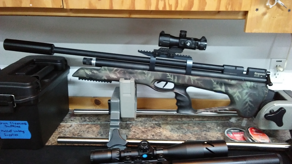

I changed my last marauder to bullpup

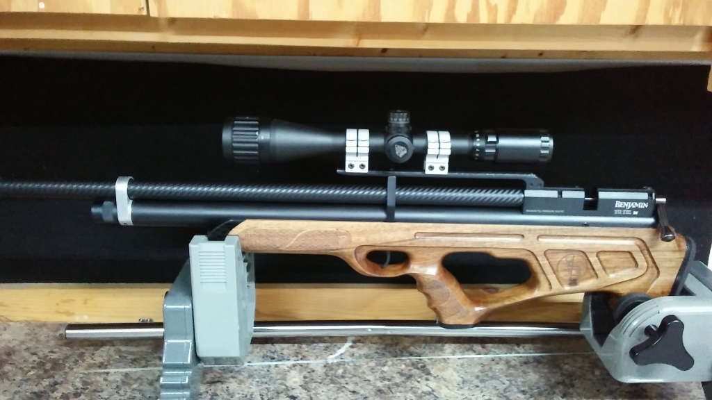

theShroud has Carbon fiber tape- scope mounts are BKL-the Barrel band I sanded off all the anodize & the stock is a Craftsman Vit bought from a member here . 22 Cal
Will be changing camo on this 25cal. soon . T3PRanch show a picture & let us know how it shoots please .

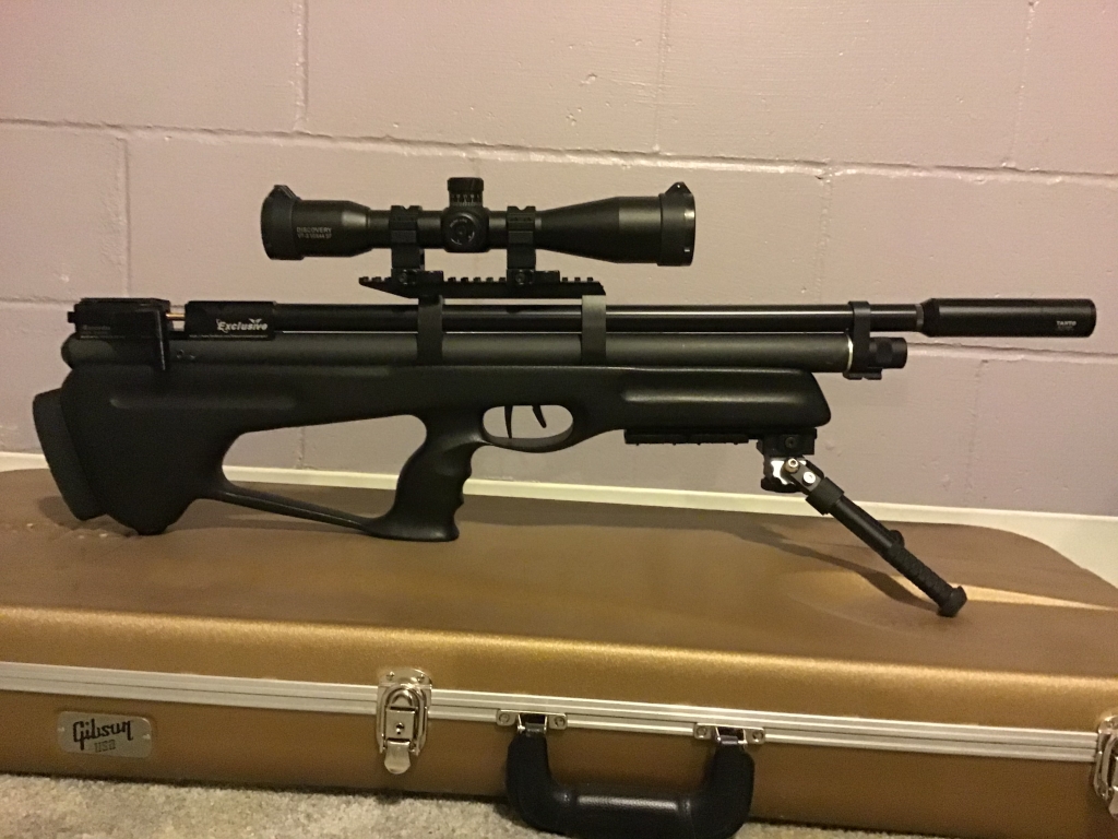

Here's my .25. I'm going to change out audrius regulator for a Huma I just picked up, then tune down from the current 53fpe to a 40/40fpe tune just in time for the .25 Hades to arrive.

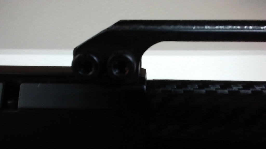

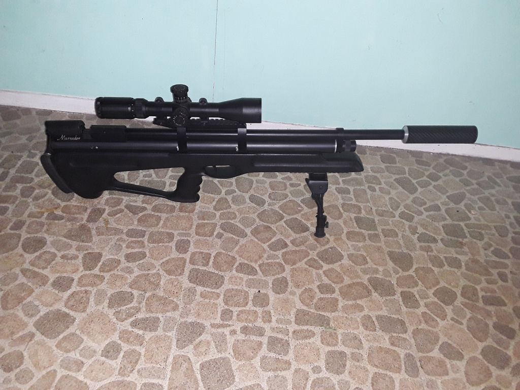

NMshooter I like the feel a lot but there is things to Note: you cannot have carbon wrap on the Air Tube, it only can be put on the barrel shroud .The piece that slides over the shroud & air tube is a tight fit . The linkage is thick & I think nicer than the maddog kit very easy to install . But it has no linkage for the SAFETY. Also this one but not sure of the rest of them the groove in the dove tail has tool chatter in the deepest part of the V not sure if my picture will show it . That's why I went with a wider base ring mount, was going with a one piece mount but ordered the wrong one also my UTG's did not fit right. Do not damage any parts or lose them because Craftsman Vit does not sell replacement parts my as far as I know. They did not answer my question on that matter when I posted the question so I take that as NO . Over all feels really nice kinda reminds of
a cricket mini as far as balance. I'd do it again but I'm a bull pup fan . Hope this helps some people out .

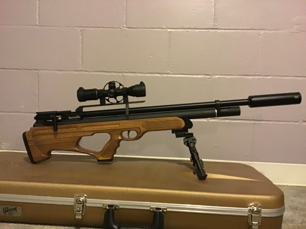

vdwd - very nice, I like the side lever touch.

They both have pluses and minuses, on the craftsman Vit the air tube sits deeper in the stock and the stock is narrower and there is no safety but it shoulders well and the balance feels nice. The MDRL does have a safety, also shoulders well and the stock is wider and maybe a little heavier. The air tube seems to sit higher on the MDRL as well. I can’t make up my mind which one I like more but I better get used to the craftsman Vit since I built the MDRL for my dad, lol. I figured he needed a safety more than me, this will be his first PCP.
How is the vt stock..I'm about to order i.i had the rapid70 stock.but did not like the linkage.the vt looks better.i did ider a side lever from exclusive. Plus a huma reg.i have the war vavle.cant wait to put it together alex
alex I love the stock - the linkage is stronger then the MD but has no SAFETY but not a deal breaker for me . Easy to put together, when connecting the linkage to the trigger just snug it don't over do it . That's what I was told by previous owner . Turning that long gun into a pup made it a lot nicer to handle & shoot . Hope you enjoy it Darell

What scope is that you're using on the MDRL Synpup?
I have a discovery 10x 44 that was supposed to go on another gun, that may find it's way onto the Mrod.
That scope was a freebee it's a UTG Primsatic 4x32 T4 ( P.A. $179) ..Going to rescope both guns with ffp compacts in the future My aeon went ends up so I put that on as a backup.
