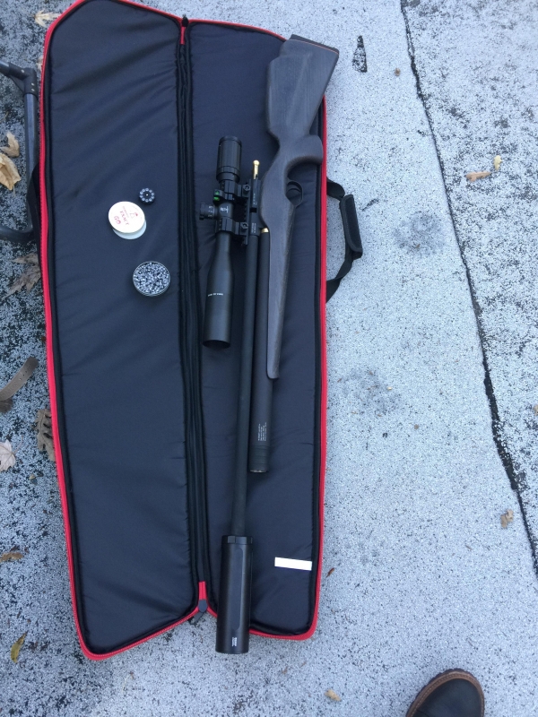

I got the Black Friday deal for the fixed 10 power. Wow, it’s my favorite scope now. I have it on a zbroia and it’s awesome. I’ve taken a squirrel up close at 15 yds and a small jay at 52 yds. I was pretty scared at first, hell i even had a guy tell me how dumb I was to buy a fixed power and he wanted to sell me a overpriced UTG. So glad I got the 10 power. I hunt and shoot for groups, so I didn’t need too much power. I settled on a 10 power because like someone else said, I usually leave my other variable at around 10 power( goes to 12 power, but 10 is better clarity on my vortex). Matt Dauber from airguns sa has a fixed 12 power on a streamline and he loves it, that guy is an expert. So yeah, I really like swfa also.
1544669660_16372122455c11c9dcf21b81.52891873_28B335D0-BB27-41BE-AC79-F2C393368E55.jpeg
