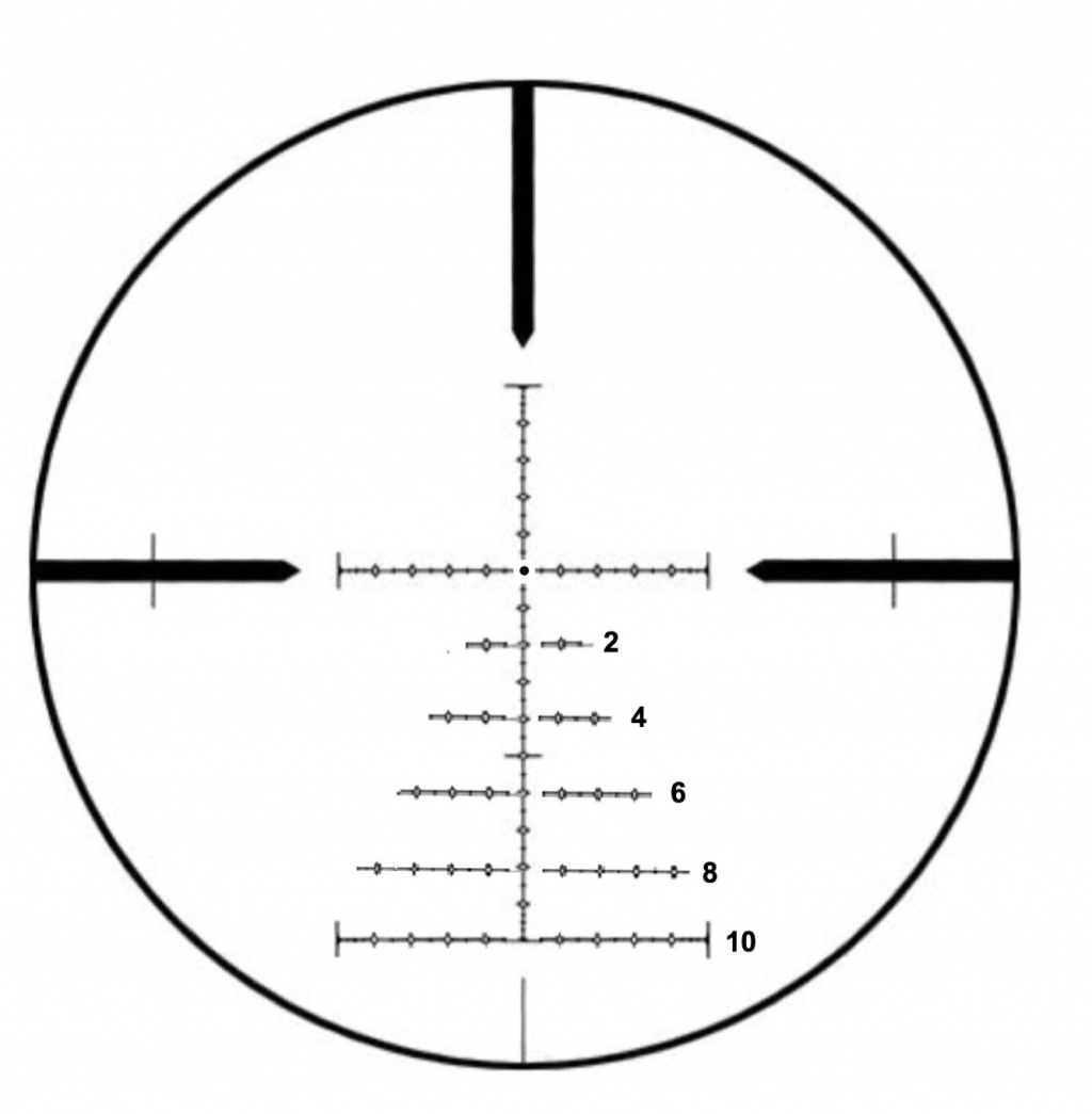

I really like the look of the Christmas tree mil-style reticle that you made, but I do think the center of it could be cleaned up. One idea is to use the floating dot style SWFA uses on some of their MOA reticles. I think keeping the mil style with the more diamonds makes the Christmas tree works really well (very easy to read), and having a dot in the center could help give some extra clarity.

After looking at some of the other SWFA scopes here's my ideal: Essentially the below image just with a Christmas tree like the one Joe made. As far as other features I personally like adjustable mag and FFP (the 3-15x42 is laid out pretty well for most of us). If they have the chance, putting HD glass on something like this would be nice. (I know I would upgrade my normal 3-15 for something like that!)

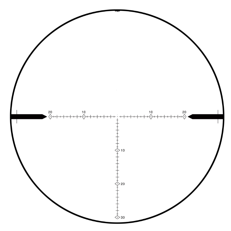

Just throwing this out there for discussion, because I NEVER use the reticle marks in the upper half of any of my scopes and thus prefer a reticle that keeps the top half of the reticle nice and clean for a clear view. Do others ever use the hash marks above the center point? Would a reticle only utilizing the bottom half of the field of view like the one below be better?
For hunting situations like shooting at extreme angles, we need at least two hash mark's above the center dot if you zeroed at 30 or 50 yards. I've never zeroed my scope by using the very top hash above the dot but I've heard of some shooters using this method. It does make sense if you figure out your gun's peak trajectory and zero your scope at this point.
Well if we are only critiquing the proposed reticle, then I’ll come clean and say my experience with SWFA’s reticles is that the lines are too thick, and I don’t like the open diamonds, nor the proposed center dot. I’ll add that my only look at SWFA reticles was at FFP scopes for PRS, so maybe the SFP reticle lines are thinner. I like to quadrisect a target dot with thin cross hairs, and the crosshairs allow for the option of a sub six hold. A lot of airgunners like me are coming from 10 meter air pistol and 10 meter air rifle competition where the sub six hold is king. Try doing that with an open diamond or a target dot, and good luck with that. I want a tree or grid under the crosshairs to accommodate holdovers especially if there are no RZ turrets to allow clicking for elevation. Again, I want the grid to be crosshairs, not open diamonds or floating dots.

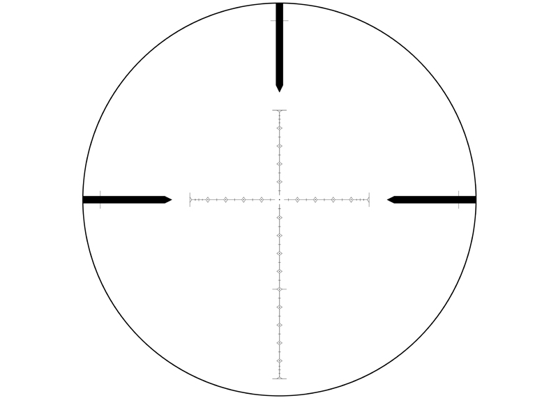

I love SWFA's floating dot moa reticle and the Aztec's reticle . If SWFA could illuminate some of the fixed powers,.... Also if they could just illuminate the floating dot. I've see this illumination on some Nightforces. It really helps zero in that floating dot, because it can be easily lost in the target. Then if SWFA could then put those faint x-mas tree dots in there, like on the Aztec, nobody would every buy anything else, ever. That's my opinion.
The Aztec reticle is the bomb. My wife who is not a shooter went three for three on small pieces of chalk at 50 yards with my Sniper HR with Aztec Emerald atop. I say to her “awesome gun” she says “she likes the scope, how easy it is to use the reticle. This scope and reticle are definitely underrated. My hit ratio is through the roof with this scope, so much so, I have to extend my home range out to 100 yards. The Aztec has that floating dot illuminated MOA reticle and it lights up nicely.
This reticle above is too busy. I often shoot long range with my 257 Texan and find I run out of reticle pretty fast. So I’d like to see the hash marks go all the way down. Hold under has marks are essential, as my Texan and Citrus are zeroed at 100 yards. I love numbered has marks as I lose count.
