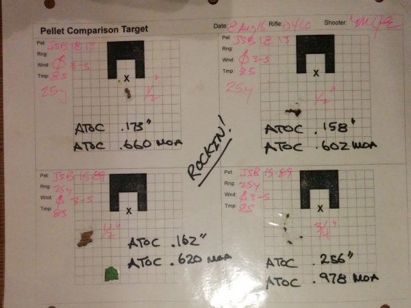

Just ordered a 6x42 Mil/Mil SWFA for my "John in PA" tuned D460. It's doing 20.5 fpe with JSB 18s and 21 fpe with JSB 15.9s.
Sorry for the shine. This target has been laminated and stored in a notebook. Anyway she shoots groups like this:
I can not wait till I have that glass on that rifle. It deserves it. I've never owned a really nice bit of glass. I've shot over good glass but just never decided to drop the coin on the optic instead of the rifle.
