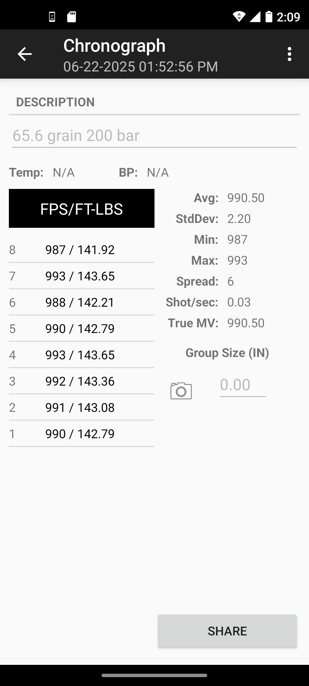

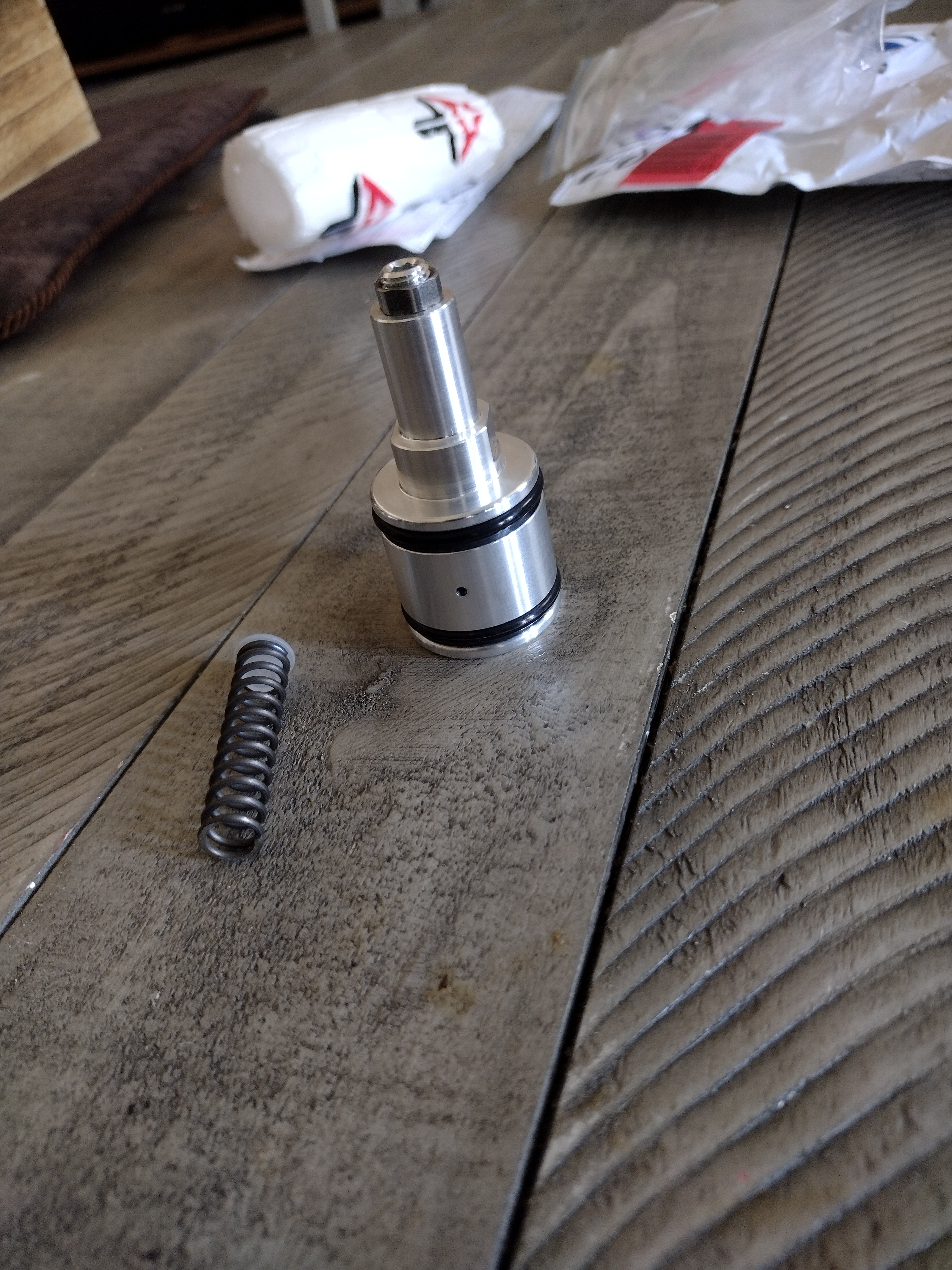

Sweet Baby Jesus! Just got my Vulcan 3 HP 200 bar regulator!!
Right now my Vulcan 3 is shooting 65.5 grain slugs at 915 FPS / 121 ft lbs.... Can't wait to get this new regulator in and see what she'll push them out at!!

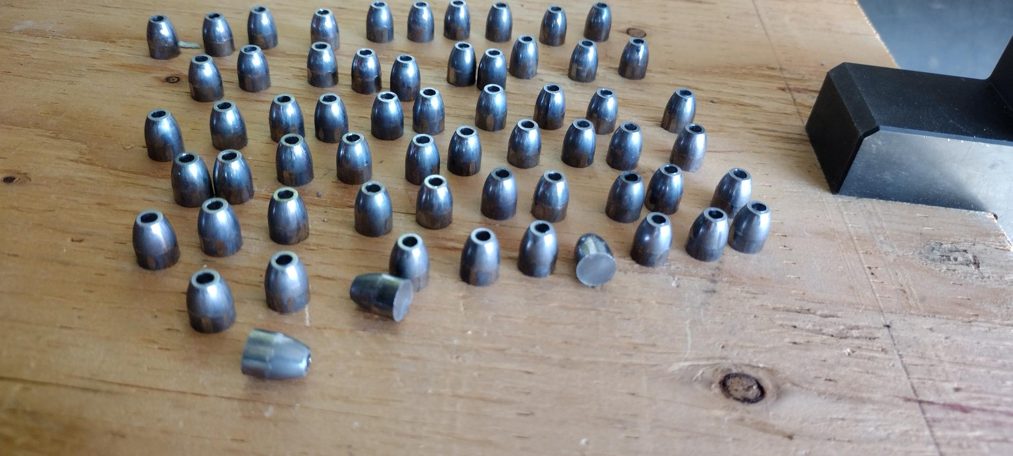

My v3 hp .30 does 970 with 62.5 gn avs with factory settings i have corbin press set up on the way. My barrel measures .3055 so hopefully better fitting slugs are more efficient.
That's exactly my barrel size, .3055. I have a slug press which I had made in .3063 (ordered before I slugged barrel because everything I read said .3063) so I got a sizer from NOE, ordered in .305 but is actually .3047 but it's shooting MOA or less at 100yards so I'm happy. Maybe I'll have NOE make one in .3055 but in no hurry
Lol funny but not funny I almost did the same thing but decided i would wait till i had vulcan in hand and barrel slugged first. Crappy part is corbin stuff been on order since last December

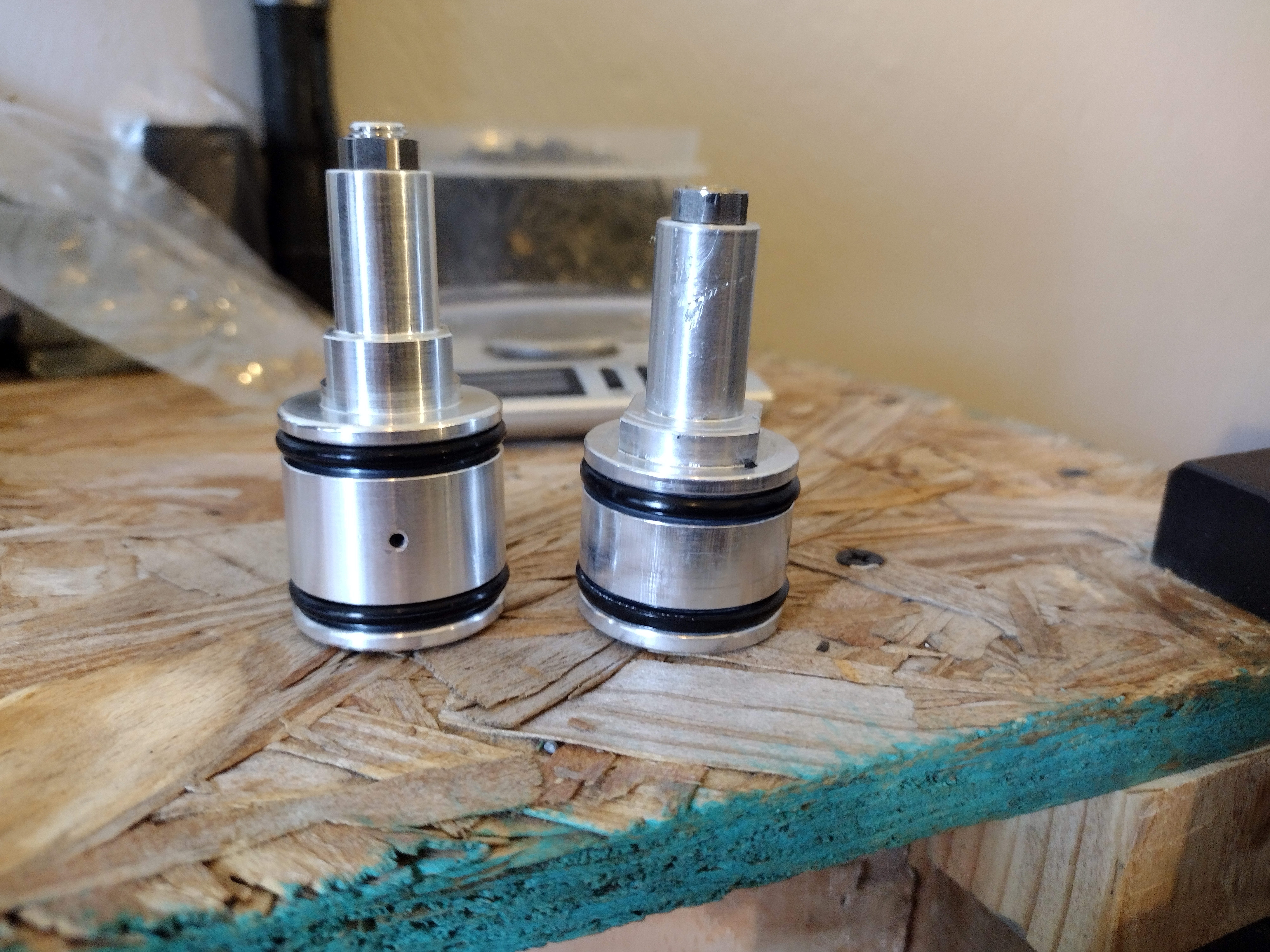

be careful, with the inside of the breathing holes in the tube. in mine were some drill burrs, that broke the o-rings ,when i got the regulator out just once and now i am waiting for spares since way to long. first i had ordered the new ones based on the AGT manual specs, which are of course for the smaller regulator. =(
