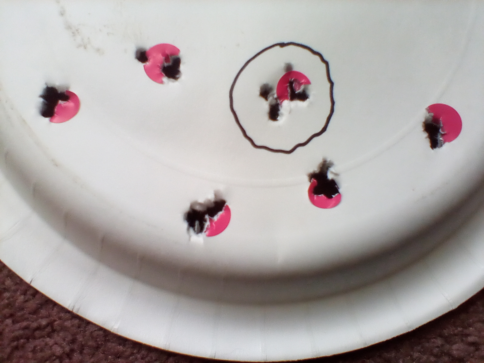

After drilling out my suppressor to 7/16" my .22 Max is shooting good and much quieter. Here's 30yds 5 shot groups except the circled one which is 8 shots. I'm starting to feel better about buying it now.
