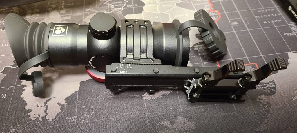

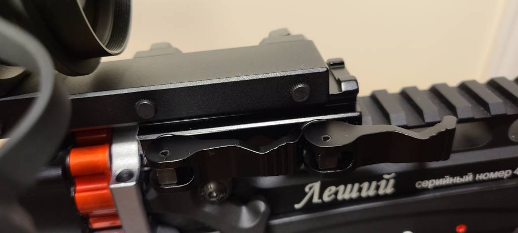

Not sure what gun you planning to mount these your scopes, I did a retrofit on my Leshiy2.
Got couple different styles from amazon, strip the parts I could re-use and made the QD myself:

I have a full box of those things, I remember only that not all screws and nuts (or nut threaded bushings) were matching and I had to pair them either the thread or the length. Some screws are round but some square shank, I toke a small file and reworked the holes.
