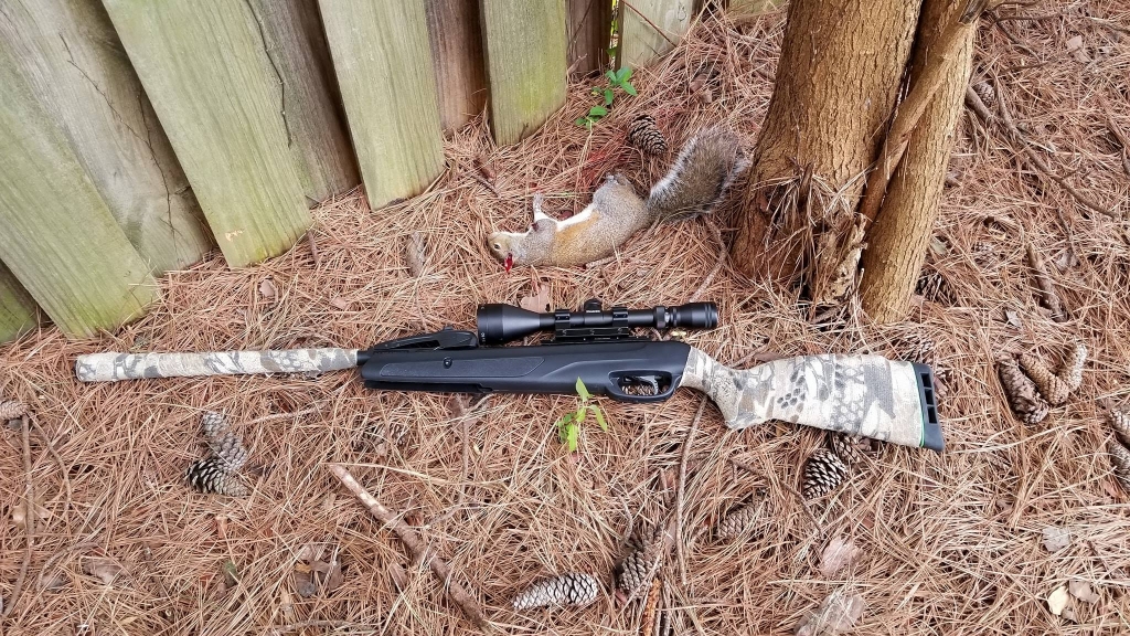

The Gamo Swarm was my first airgun but since then I have move on to PCP. It's an excellent started AG IMHO I took this squirrel at less that 25yrds with the scope that came with it. I suggest you might want to get a better one it has a fixed parallax utterly useless for anything less than 15 yrds.

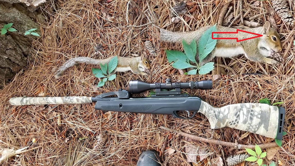

1566467385_3084562815d5e6539844623.84064714_29064258_1885319911501586_399815071997525836_o.jpg
That Poison oak/Ivy(?) really did a number on those squirrels, huh?
