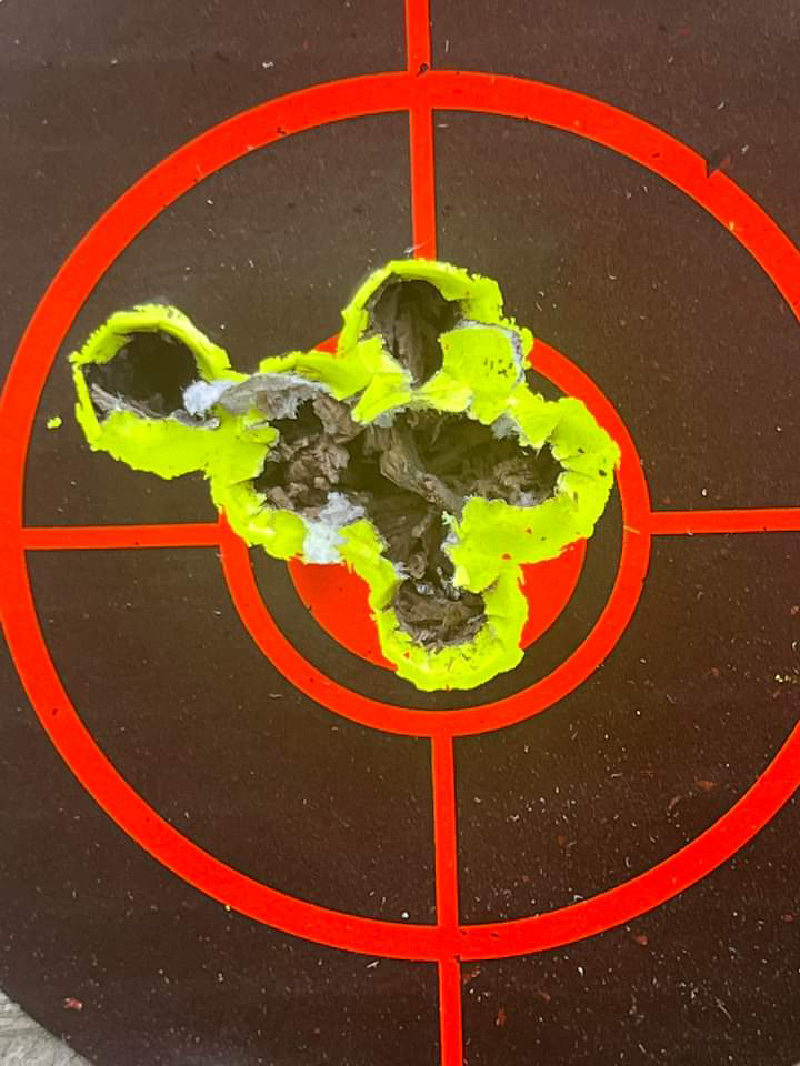

Sorry you had a bad experience with slugs this is a full mag of my corbin 47.2’s at 940fps out of my maverick sniper no bi pod or bags just resting on my window sill. I didn’t even change the reg or set screw just went from shooting hades at 960 on pw number 4 to pw number 6. Unfortunately I haven’t really shot the gun any further since because I grab my .25 panthera hunter Compact all the time
