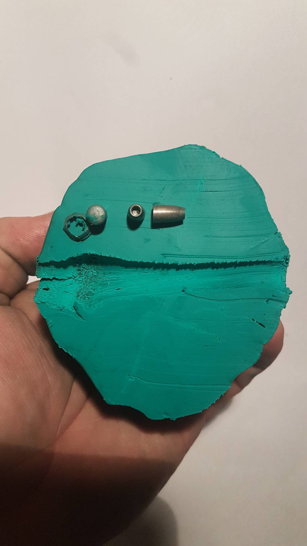

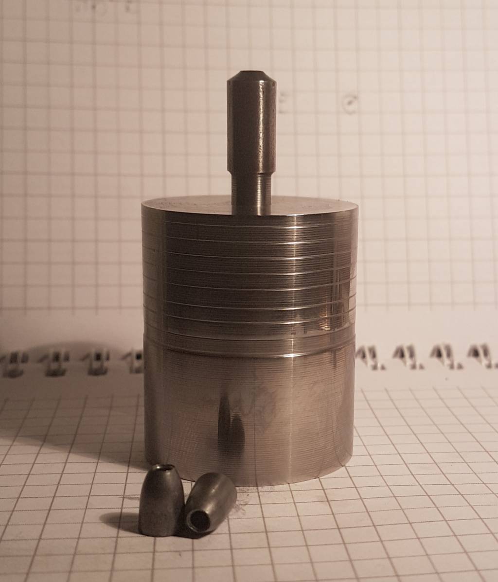

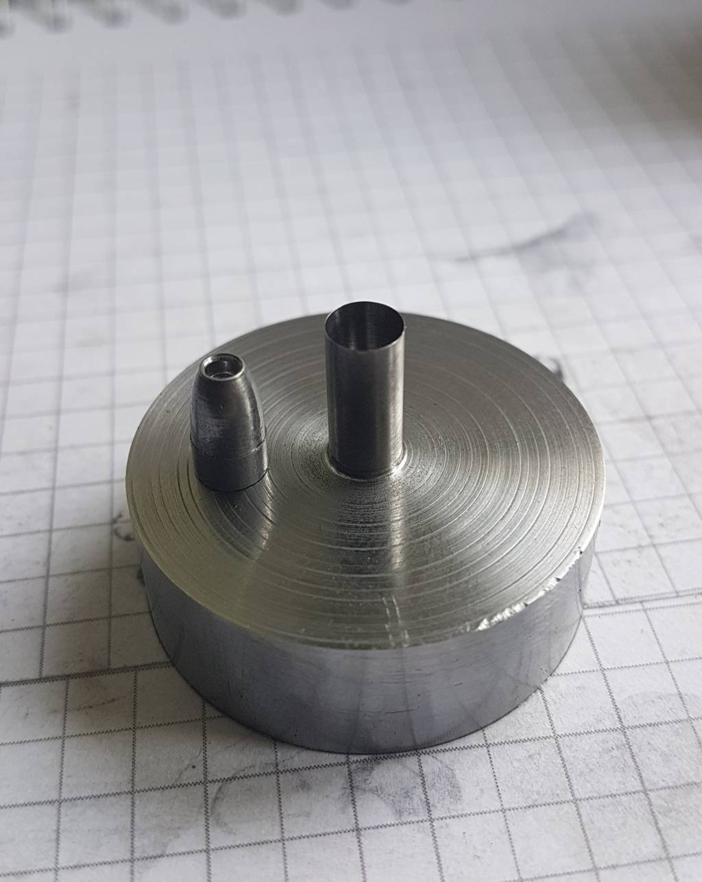

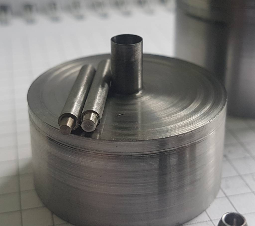

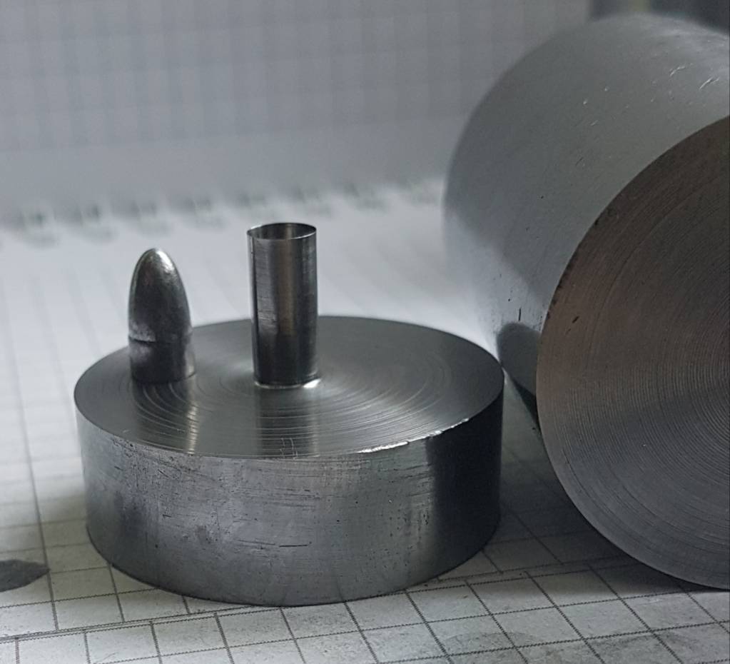

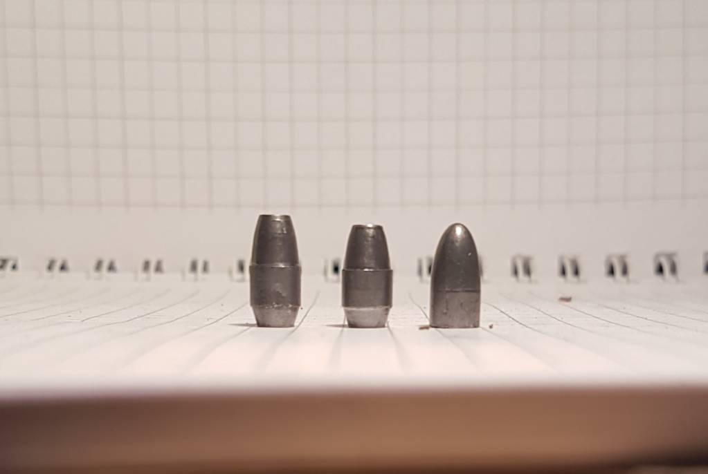

Swagging slugs

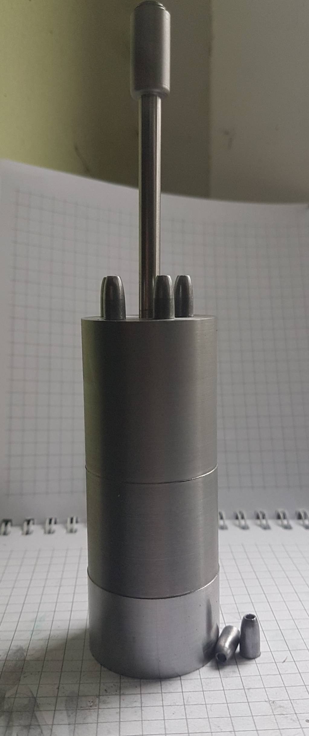

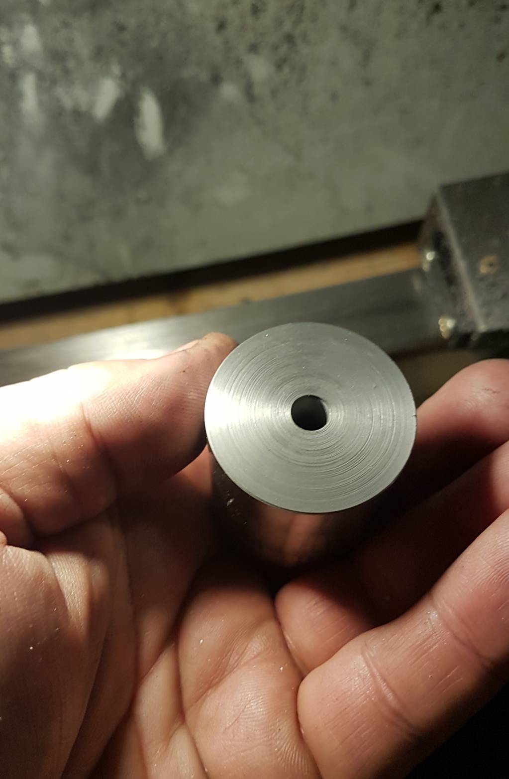

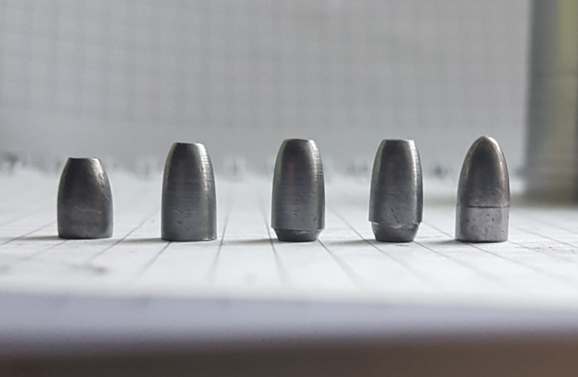

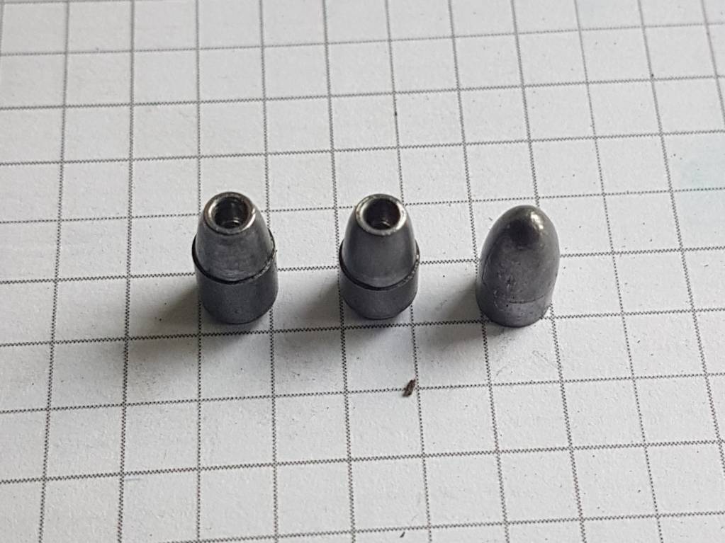

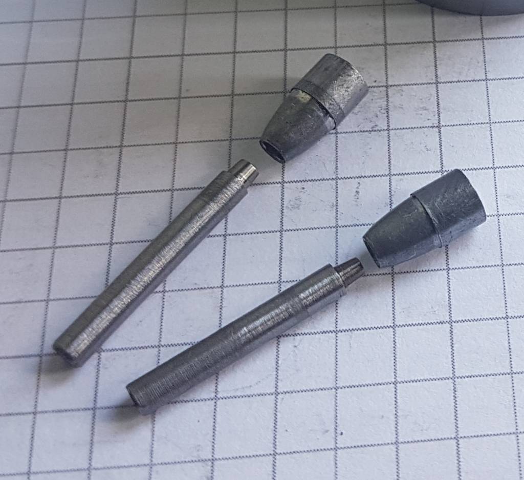

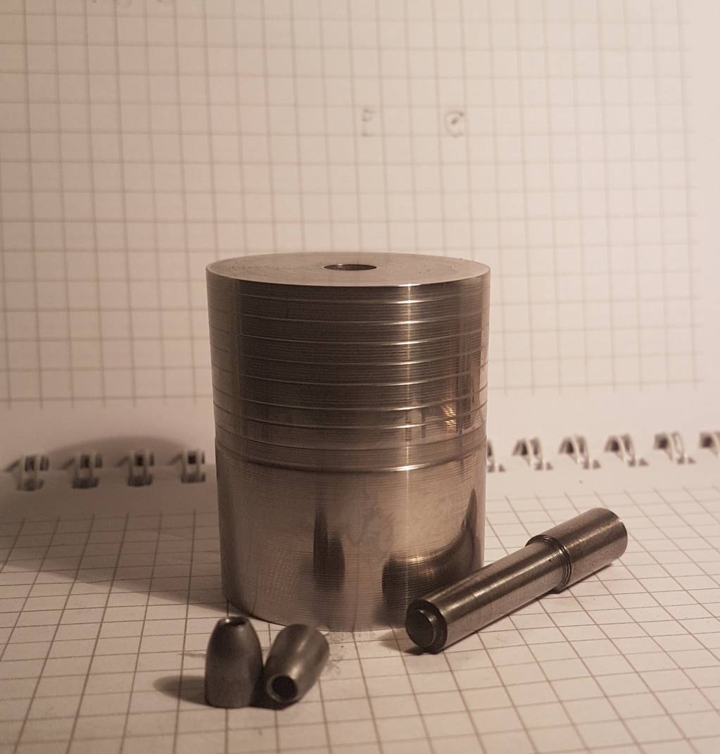

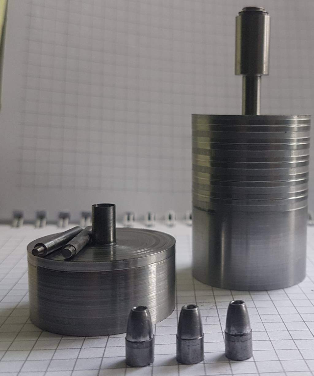

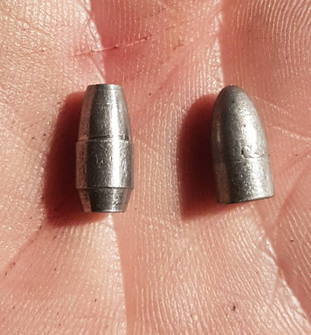

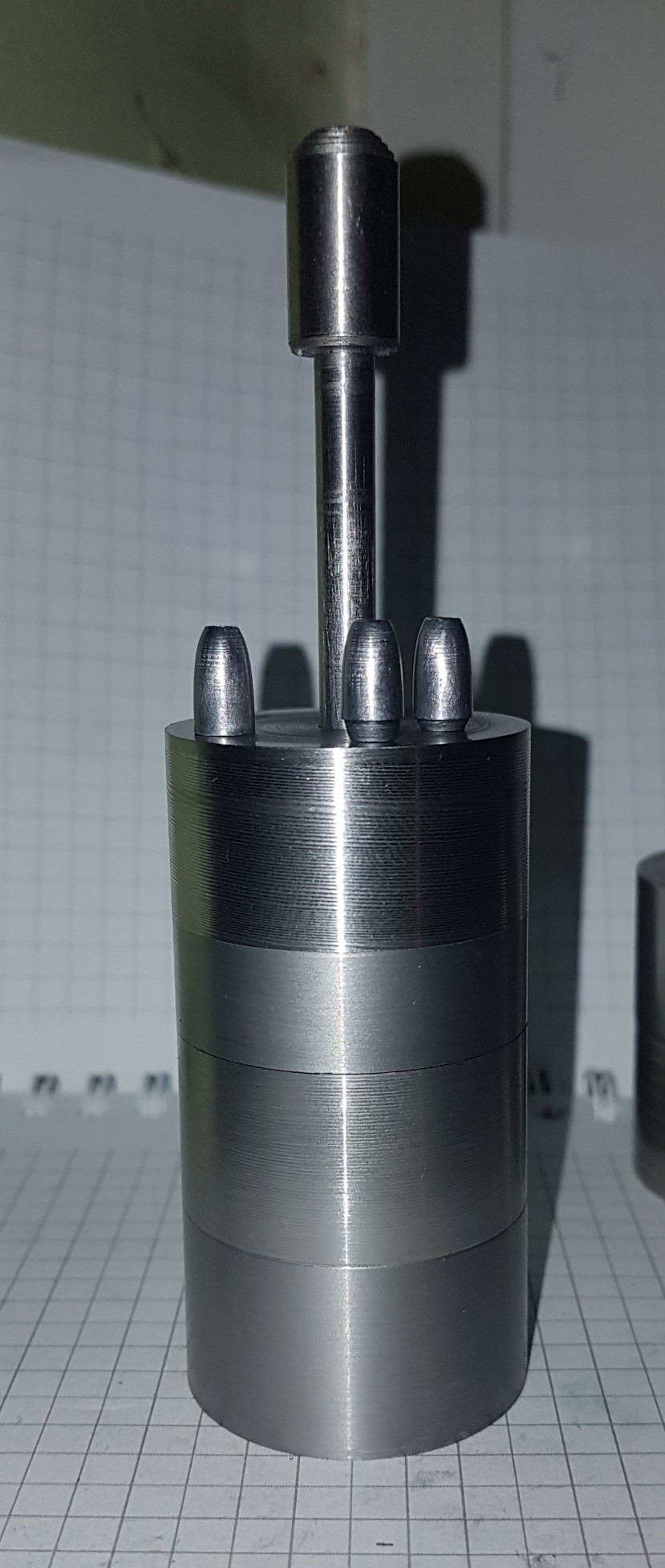

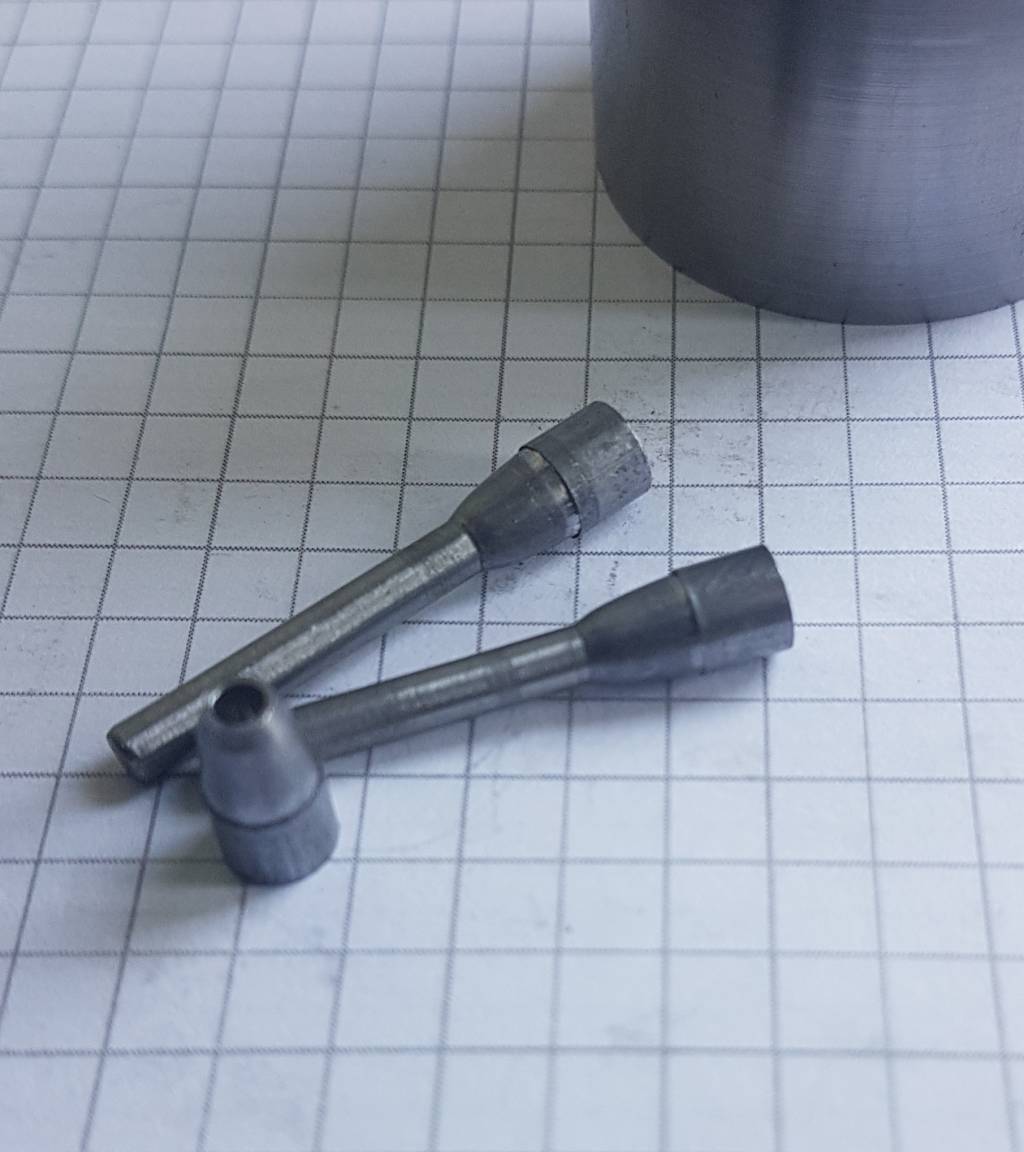

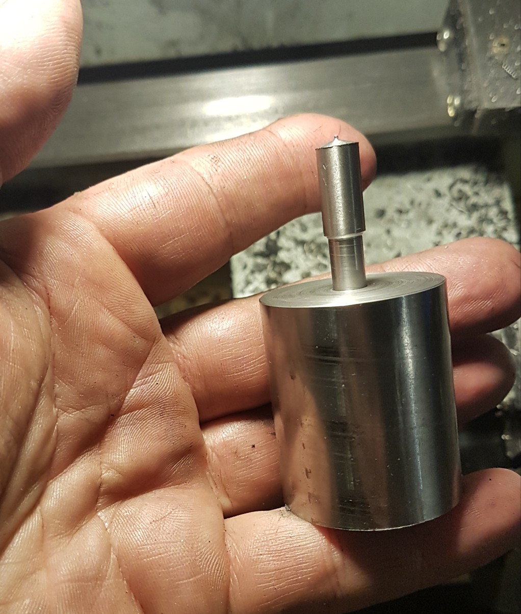

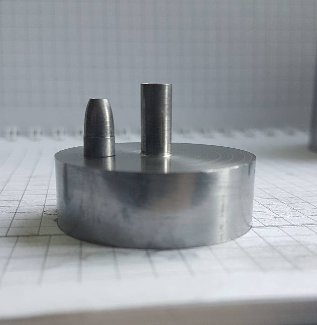

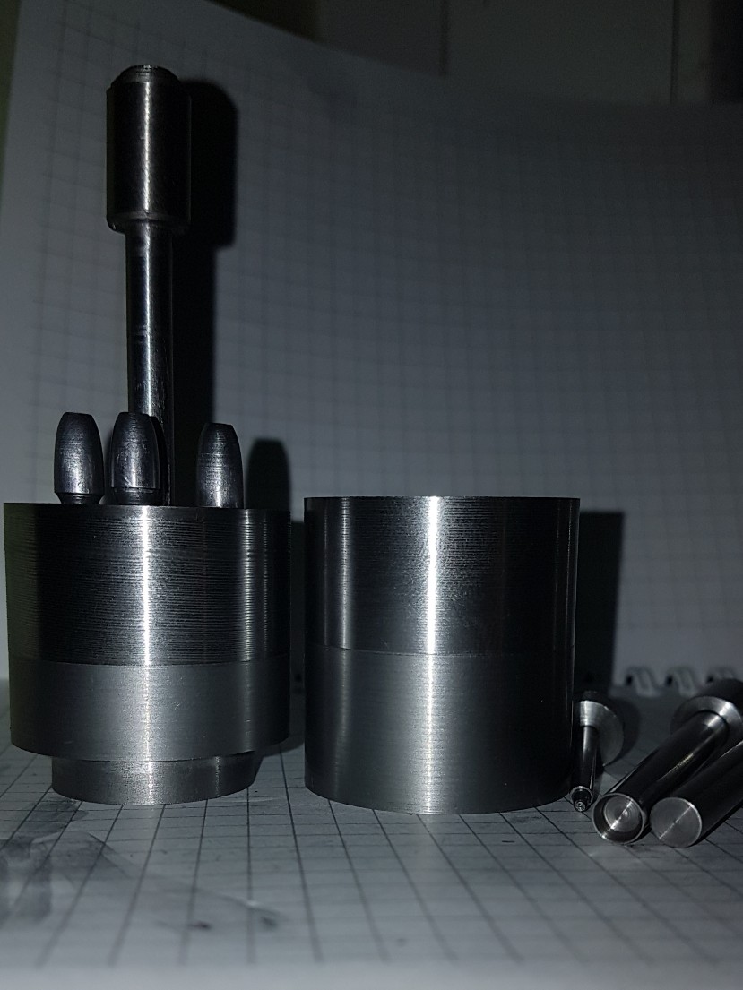

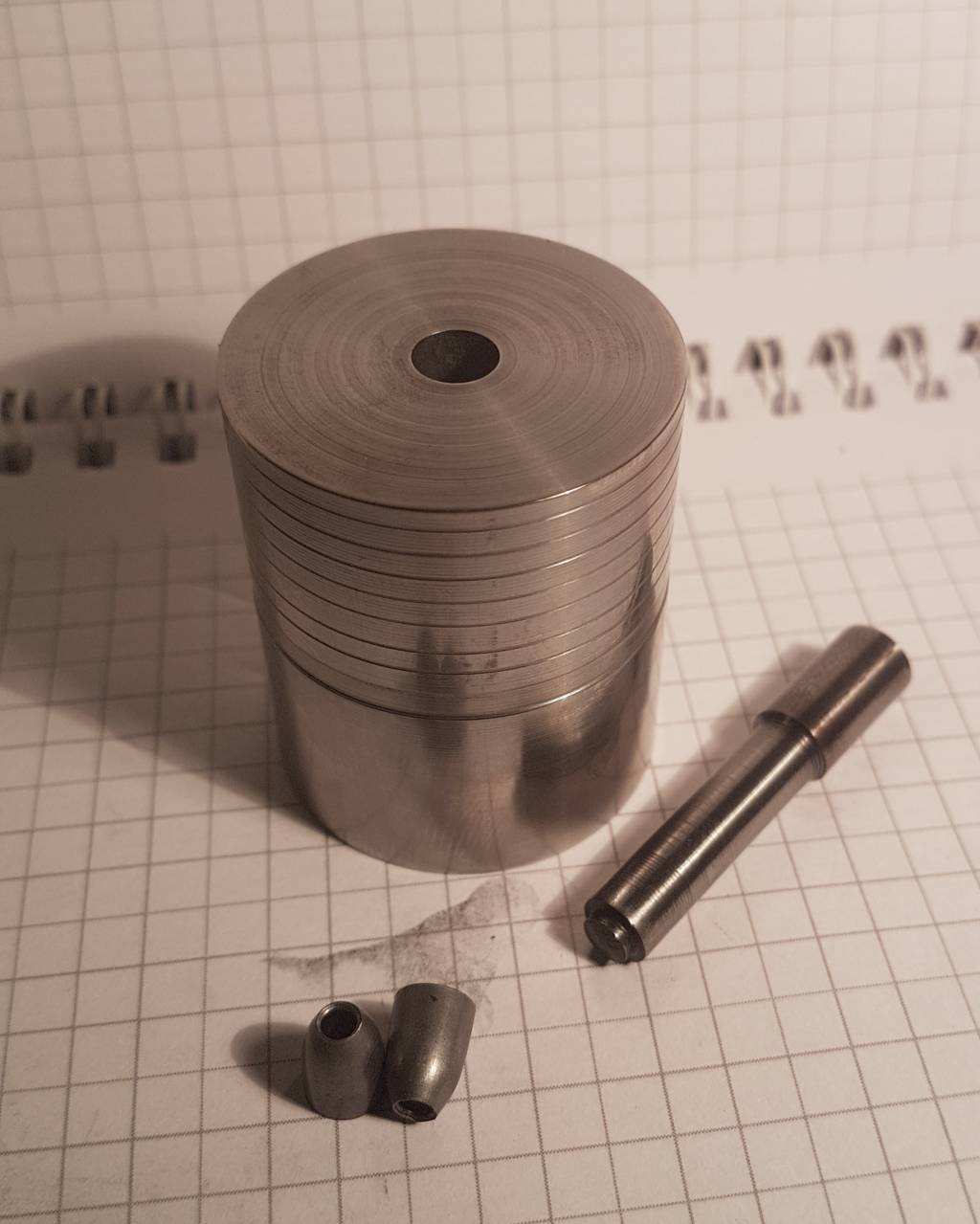

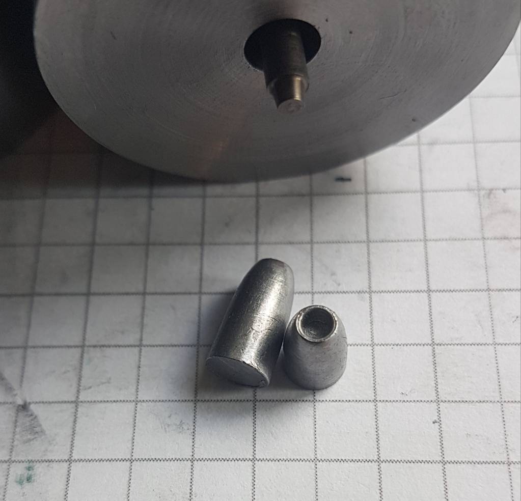

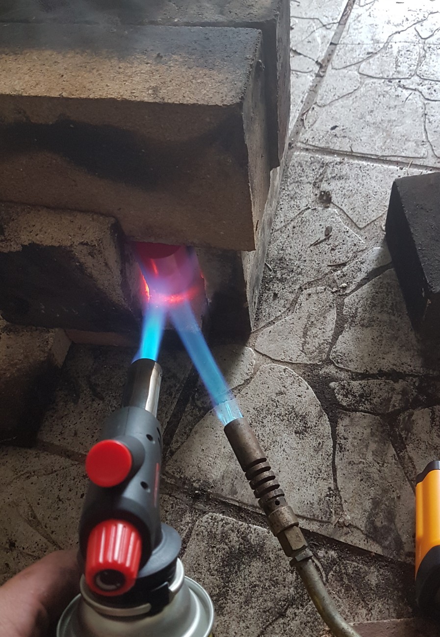

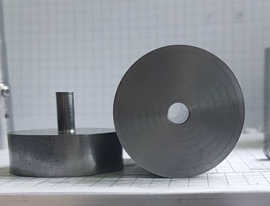

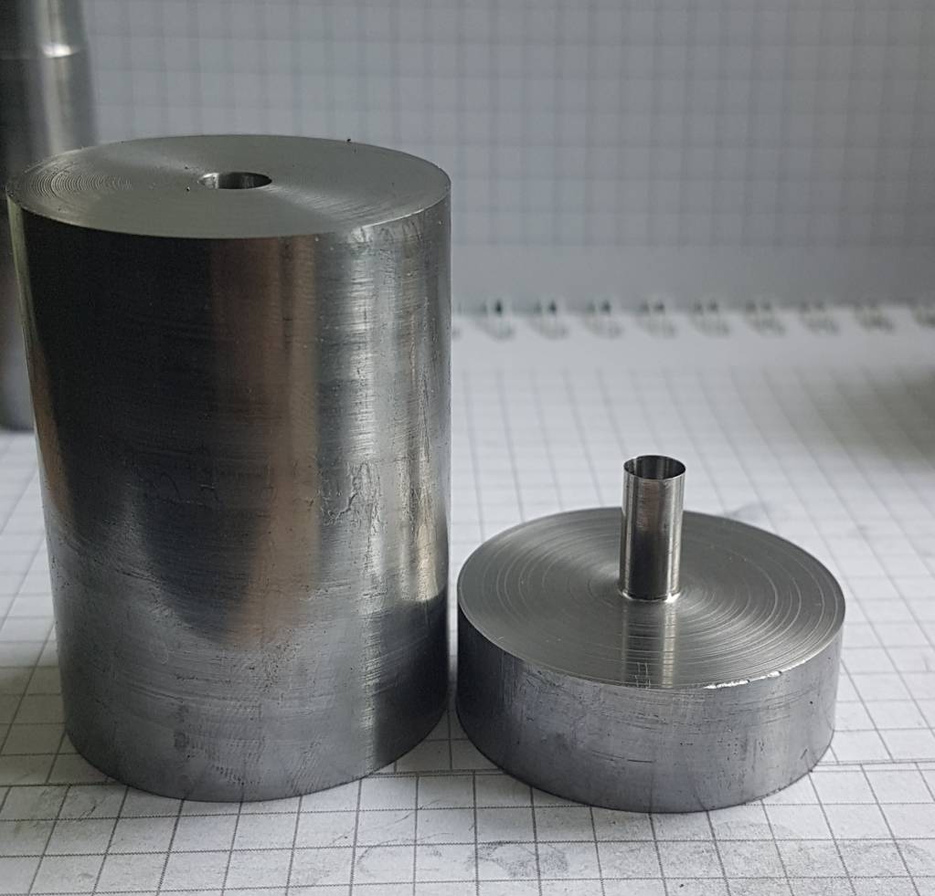

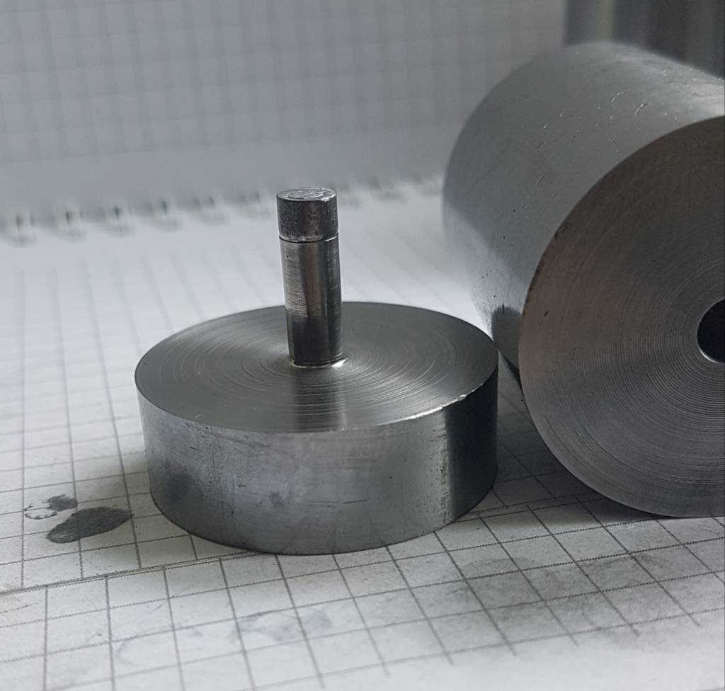

Enough for today. This is what it will look like. Tomorrow, or rather today, I have to hardening it.
I haven't worked on the exterior so far. First, I will check the dimensions after hardening. This steel is not very susceptible to deformation during hardening, but it's better to find out for yourself
