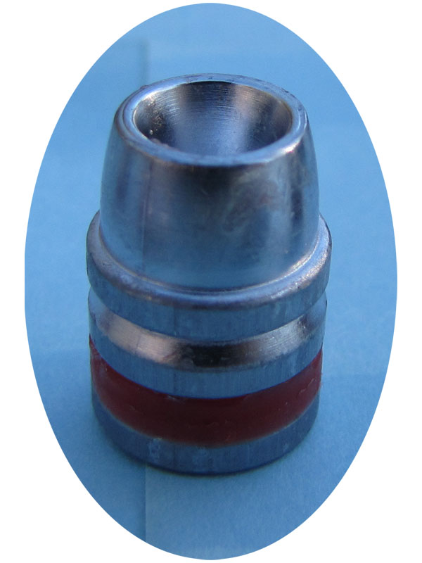

❓ Or should I rather go with a SWC HP (semi-wadcutter hollow point slug)?

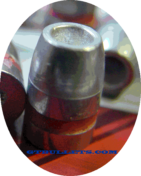

❓ Or simply a slug with a hugely gaping HP?

When buying swaging dies, getting a versetile set of dies is beneficial to tuning and use. Swaging the semi-wadcutter style slug is an all inclusive design. It will punch clean holes in paper and also on animals. It will work for long range paper targets with higher BC by making it longer and without the hollow point pin. And for animals it will make big hollow point expansion using a deep hollow point pin forming the front. Many sizes, many designs, many uses with the semi-wadcutter swage set.
When buying the die set (with multiple gun's of the same caliber.)... Order the swaging die set slightly larger than the barrel bore sizes. This way you can use a bullet sizing die set to squeeze them down to the proper size that each gun's bore likes. You will find that each barrel likes a different diameter (or length of slug). So an inexpensive set sizing die is made for each gun barrel by sanding and polishing the inside of the sizing die to proper bore diameter (using the hand drill at the bench).
