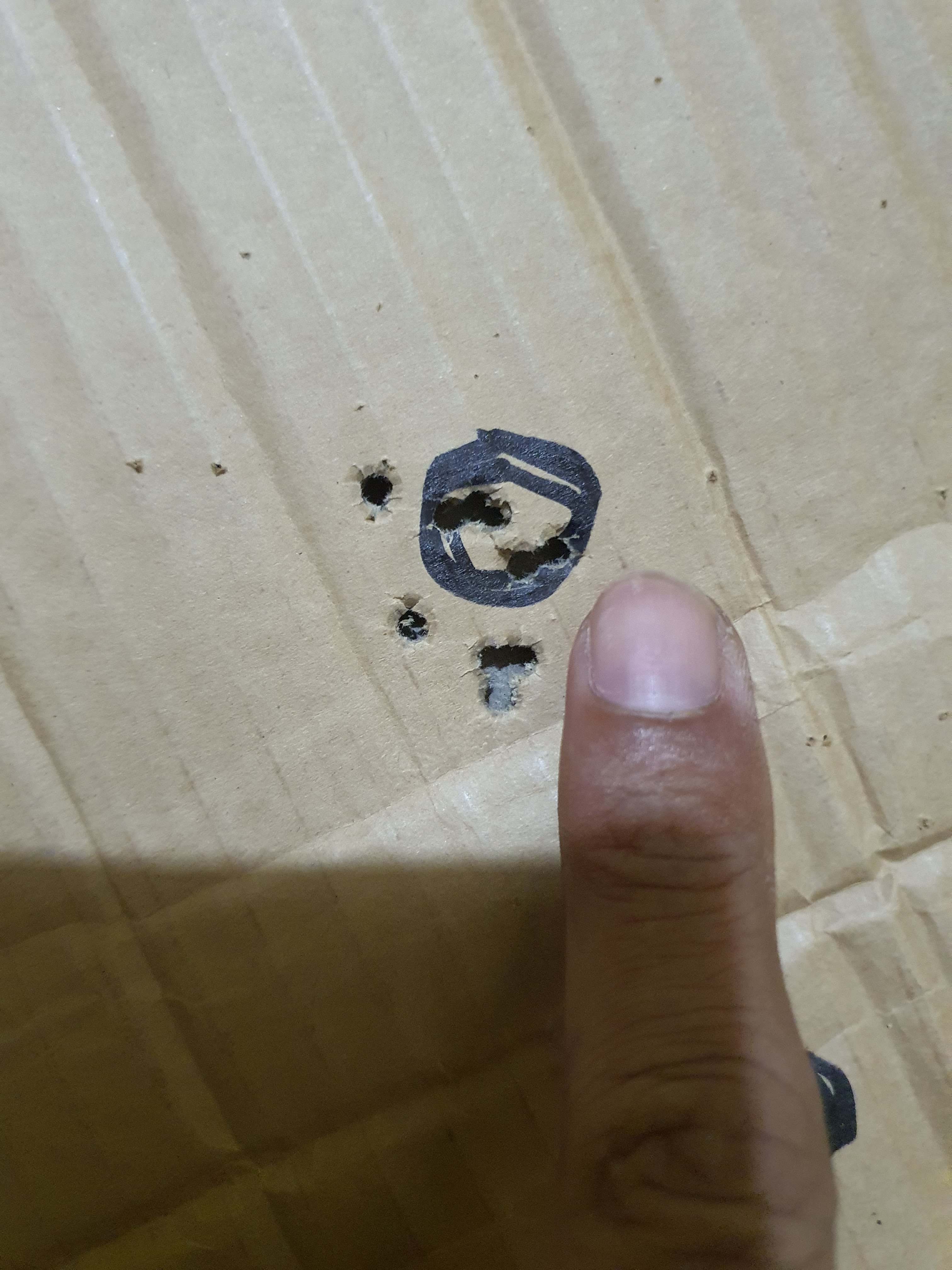

I tested the gun at my home range that is only 24 yards. But no good group couldbeachieved. A bit of shotgun pattern.

Just shot this 24 yards group with same slugs. To me it looks like at least 1" group while the 60 yards group was either similar or most probably a bit better.

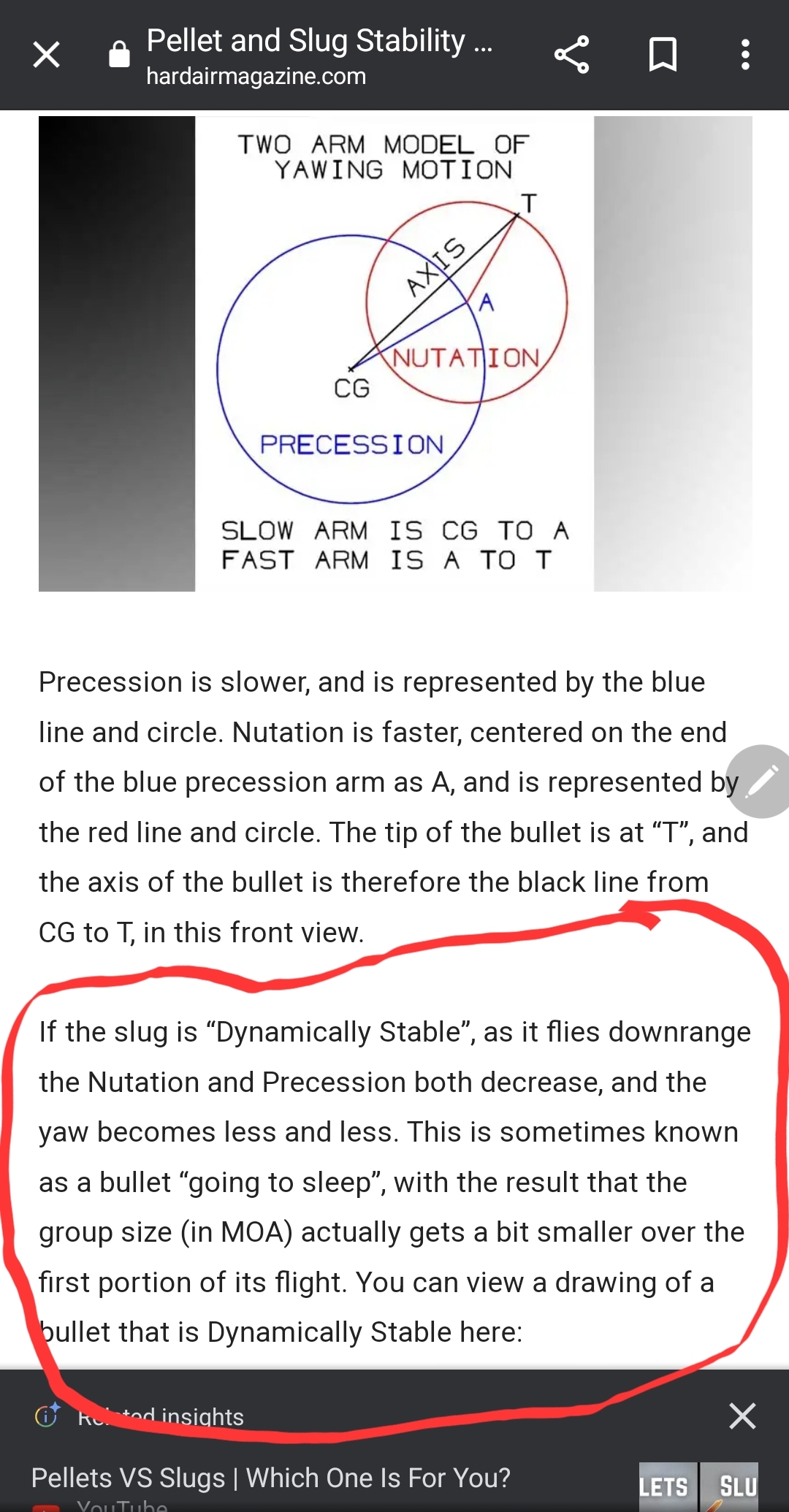

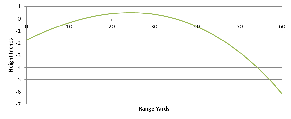

When any projectile leaves a barrel, it will have an initial yawing rate, i.e. it will be swinging from side to side. As Bob Sterne says, if it is dynamically stable, the amount of swing will decrease as it moves down range. It does not mean that the projectile is unstable when it leaves the barrel, it is just the normal behaviour of a spinning, stable projectile. When a projectile is yawing to any significant degree, we get what is called heave and swerve. The diagram below shows how a trajectory is usually shown from a trajectory program.

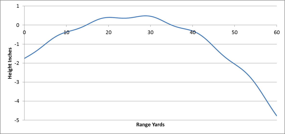

In reality, the projectile is not following a smooth path, but one like this with heave and swerve.
The above diagram is exaggerated to show the effect. If the yaw is decreasing to a significant degree, the heave and swerve will decrease until we get a smooth trajectory, not a wobbly one. This may give a small decrease in group size.
The only problem with this idea is that normally a high yaw rate close to the barrel gives an angular change to the line of the trajectory which will increase the group size with increasing range, as the yaw rate will be in random directions. The effect of the angular change will need to be less than the effect of the heave and swerve. It may be that it will not give increased group size with range is if the initial yaw rate is consistently in one direction, which suggests there is some interaction between the gun and the slug. Even then, any reduction in group size should be small.
