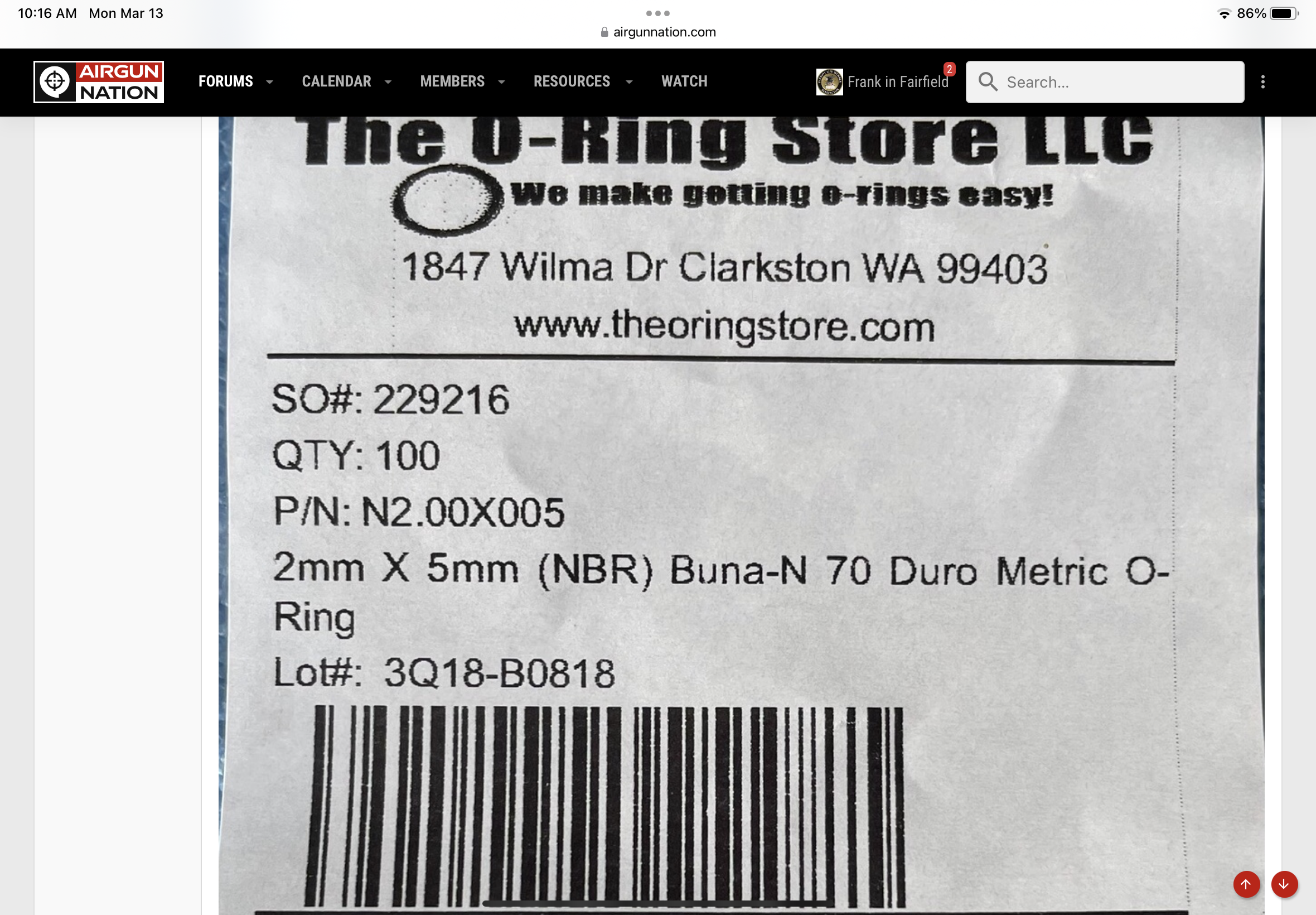

Breech o-rings here to:
005 orings work as breech seals
Frank how would a 005 oring work they are way too small it has a ID of 2.57mm
the breech seal is 3/8 OD on the large side of the taper with a 4.5mm ID and about a 7mm small edge OD
new IZH 46m came with spares
https://www.theoringstore.com/store/index.php?main_page=page_2
what i do know is they charge 25 bucks for 20 cents worth of seals and alway leave your breech open at storage time
