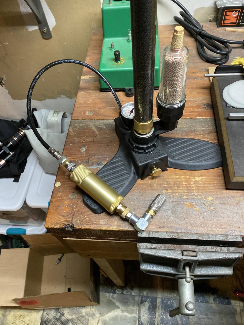

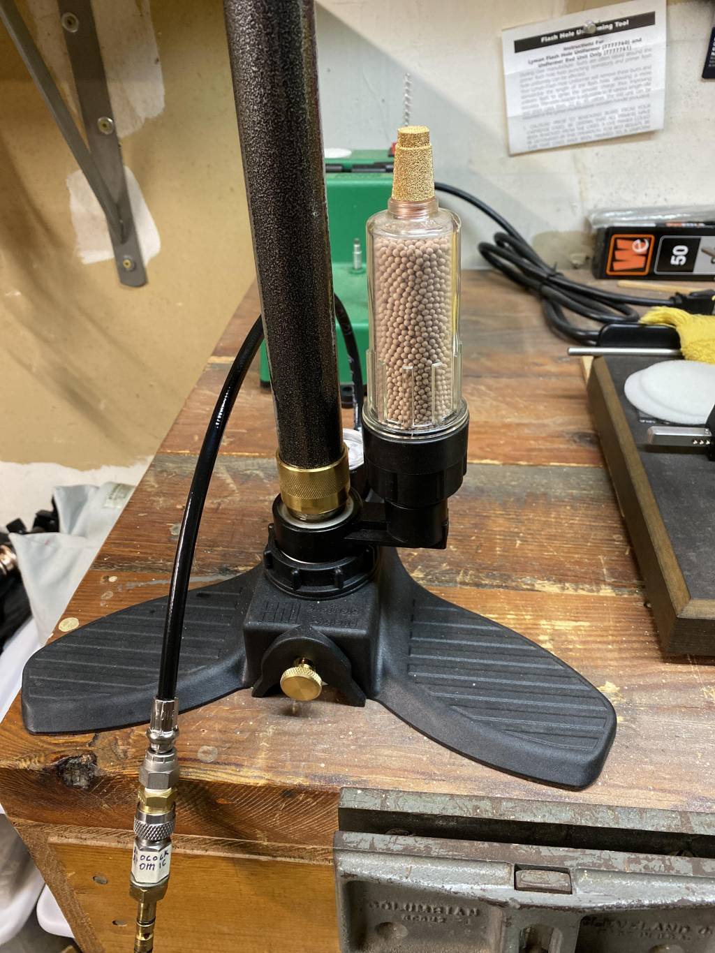

Mine is a Hill which has a moisture filtering pack available as an add-on. Is something like this available for yours?
Or perhaps add one to end of air line before gun:

Unfortunately moisture needs to be removed after compressing and that means a dessicant of some sort. The filters on the Hill pumps that have molecular sieve beads in them really do nothing because they’re meant for post compression and require a dwell time of the compressed air at least at 1,700-2,000 psi. You can add one of those to your hand pump but each session you will need to fill filter to 2,000 psi before air starts coming out of it, and it must be vertical with dried air coming out the top of the filter. This filter is referred to as a molecular sieve. After air starts flowing it will then be quite a few strokes to get it to your desired final pressure. That would be the least expensive route to dry air. Eventually you will have arms like Popeye.

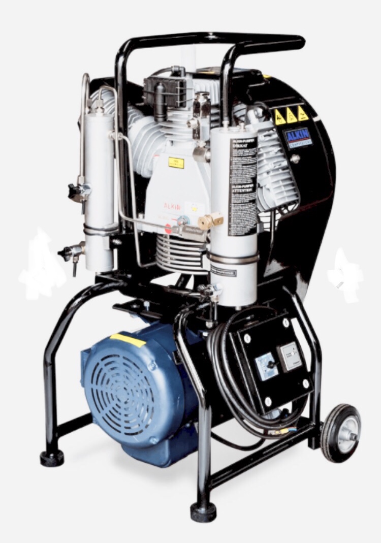

Your simple answer, Alkin W31. Buy once, cry once.
