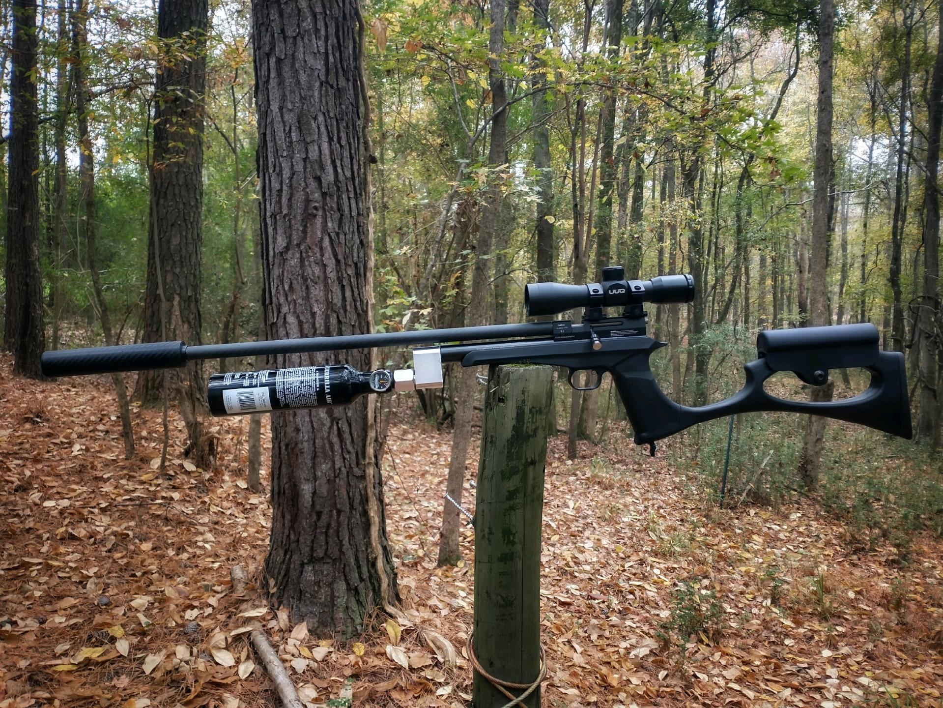

Diana Chaser with a Froggy's Airguns drop block and an 800 psi hpa tank. I also added a carbon fiber sleeve over the barrel and an ATI cheek riser. 150 to 200 shots at 9 fpe in .177 and it comes in under $300.
Yeah if you enjoy tinkering, a world of options is available to you. If it needs to be ready out of the box, the number of low power, high shot count PCPs under $300 is pretty small. The ones that do exist will generally need some amount of tinkering to really squeeze the most out of them. For example, like bfloyd I would consider the Avenger. At a minimum I would plan to set the regulator to its lowest reliable pressure, which will very likely require the hammer spring to be shortened so as not to waste air and produce excess noise. Pretty much everything at this price point will have similar things that will need attention. If not need, at least want.

I've posted this before, but I really like it, so here goes.
Diana Chaser with a Froggy's Airguns drop block and an 800 psi hpa tank. I also added a carbon fiber sleeve over the barrel and an ATI cheek riser. 150 to 200 shots at 9 fpe in .177 and it comes in under $300.View attachment 311101
I would be lucky to get in and out of the woods without serious damage to that one. I might get back to the truck with a $300 walking stick! But it is interesting.

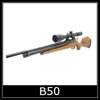

Mike Melnick has a B50 .22 for a excellent price.View attachment 311100
If Mike still has these and at $150 each fully rebuilt DEAL! For folks who dont esp. in .177 these were super accurate, and tune well for an 1.800psi fill. An exact (Exact) copy of the Daystate Huntsman. If I did not still own 2 I would absolutely purchase one today.
And in case the OP is still researching a bit of information on the B50/51: https://www.airrifle.co.za/library/The_BAM_B50_book_by_ChrisK.pdf
